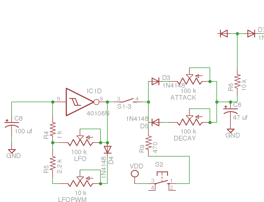

That one is pretty old, but I wonder how to add a manual gate trigger button to the schematic.
I built the diode vca and the a/r envelope thing, it works great with a 4093 Nand LFO, I tried to connect the gate in with v+ but it didn't worked. The a/r pots have no function, the release time is always long, the attack does not work. Should I use a resistor, like in the picture?
or some cmos gate? but how?

PostPosted: Tue May 27, 2014 1:15 pm    Post subject: Reply with quote  Mark this post and the followings unread
Any ideas?
I think I will just breadboard this, already add it to the schematic Cool

Hey Panzer,
iam not shure , but when Sw1-3 is open i think the decay via D5 will not work.
kaputtpanzer
Joined: Nov 02, 2009
Posts: 139
Location: Cologne
Audio files: 15
PostPosted: Fri May 30, 2014 2:46 am    Post subject: Reply with quote  Mark this post and the followings unread
Hey Matze,
yes D5 is not working with this layout, you get the full release time. I tried to put another resistor to ground, between R9 and the switch, and now it is working near perfect. But another Problem that I have with the vca is, that I can't really use the output signal for something else then direct audio. I mean I can't plug a filter afterwards or something. I tried a unity gain buffer behind the vca but that is not working. Maybe I have to try a gate from a cmos inverter or something.

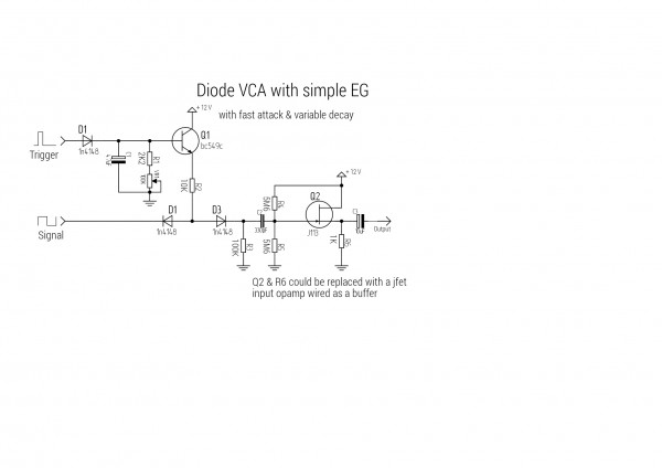

PostPosted: Wed Apr 05, 2017 9:39 am    Post subject: Diode VCA & simple EG Reply with quote  Mark this post and the followings unread
I tried this version of the diode VCA today. ( see attached )
R3 was found to be necessary to avoid signal breakthrough.
