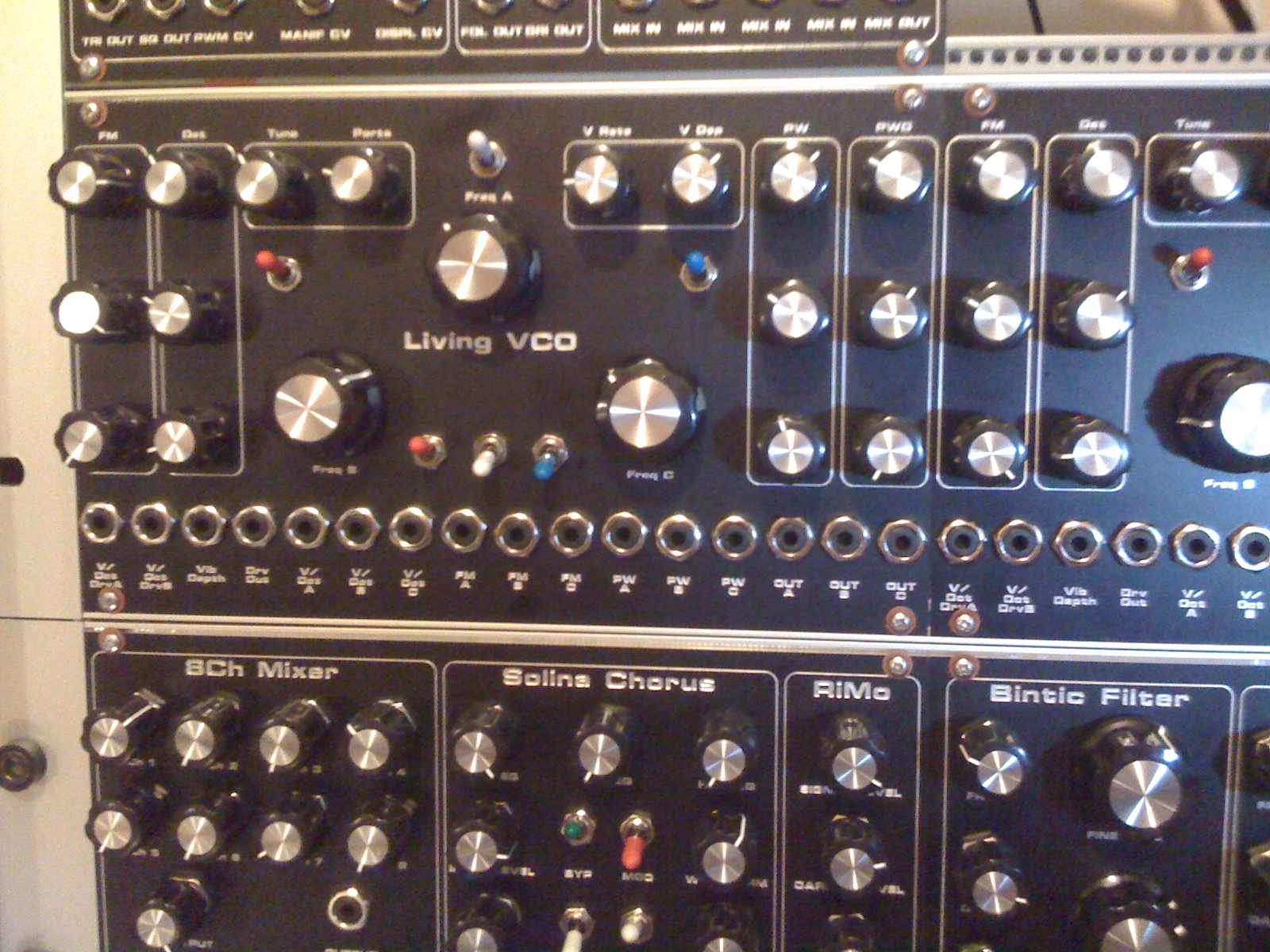

My living VCO...
there is another identical one right next to it
lovely stuff jurgen, lovely stuff Razz

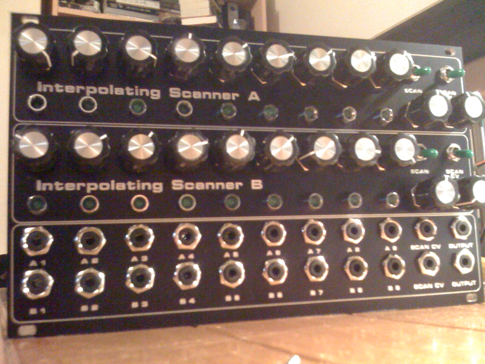

and my interpolating scanners...
(both modules are eurorack format, 15v supply)

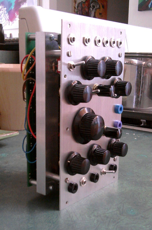

a nice panel can hide so many sins, cant it?

Haha. Awesome build! Do you have an FPD file for that Living VCO panel? I'm trying to figure out how I want to configure mine, and am playing with a bunch of different ones.

nice panel graphics

you want the fpd? no problem.
i spent a while playing with the layout. quite a bit of time actually Smile
for reference the small knobs are 16mm, the large 27mm, and the knobs behind the panel are tt tech p260p's
this range
http://www.rapidonline.com/Electronic-Components/Resistors-Potentiometer/Control-Potentiometers/0.5W-12.7mm-Rotary-potentiometers/82067
very nice, but very "light touch", low resistance to movement, i like it but its definitely a contrast to the stiffer doepfer/analog systems standard.

about the living vco layout....
there is a contrast between the top-down a-b-c of the fm/det/pw/pwd controls, and the big freq knobs, which i laid out in newspaper style
----A----
-B----C--
and the tracking and sq/saw switches bisect those knobs (follow the colour switch caps).
id always intended to have 2 side by side, so made sure the knob spacings flowed nicely across panels.
seems some kind of logical to me, but mileage may differ Smile

what is all the cake of veroboard doing?

cake?
Smile
first two layers are power filtering (beads/caps), then its the switch to send in a standard voltage to the...erm...forgotten the damn word...the normalised/unplugged inputs of the jacks, and lastly a switch to switch in dc blocking caps. as per jurgen's suggested method on the project page.
