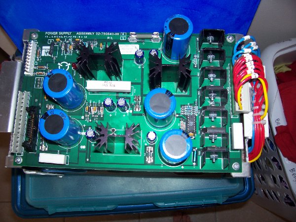

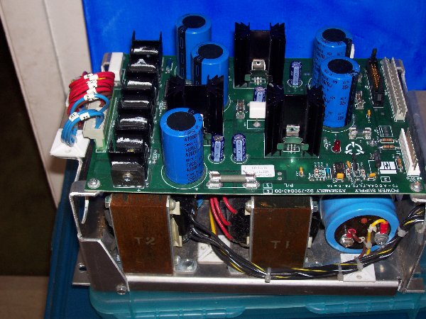

I found this out in the garbage!! It looks like a super heavy duty power supply.

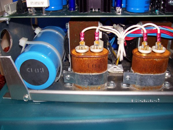

But what are those rusty parts (batteries?) and is that GIANT blue tube in the bottom a really really big CAPACITOR??
i wonder if it still works..those transformers are BIG~ this thing weighs a ton.
thanks

According to this website...
http://www.qie.com/e.html
... it's an Emerson Power Supply. For what sort of beastie, though, your guess is as good as mine! Wink
It looks as though Emerson do power supplies for networking installations....
Gav.

Those rusted metal cans look like motor start capacitors.
Posts: 24498
PostPosted: Sun Feb 24, 2008 10:19 am    Post subject: Reply with quote  Mark this post and the followings unread
Danno Gee Ray wrote:
Those rusted metal cans look loke motor start capacitors.
Maybe they are for power factor correction, would be useful for large power supplies.

Those rusted ones are "oil filled" capacitors - usually rated for higher voltages and lower capacitances.
The big blue electrolytic one is likely just the opposite - higher capacitance at lower voltages. The values are probably printed on those somewhere.
Rusty oil filled caps - ewe. The thing is 'probably' too new to worry about PCB's in the oil...but they'll leak on you eventually.

well i plan on dissecting it for parts and then chucking the rest. there are some big caps on there (47000uf etc) which look good and lots of other useful stuff.
