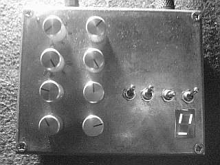

catweazle
Joined: Feb 25, 2008
Posts: 28
Location: germany
PostPosted: Sat Apr 12, 2008 4:17 pm    Post subject: Reply with quote  Mark this post and the followings unread
 Filesize:  18.6 KB
 Viewed:  55805 Time(s)

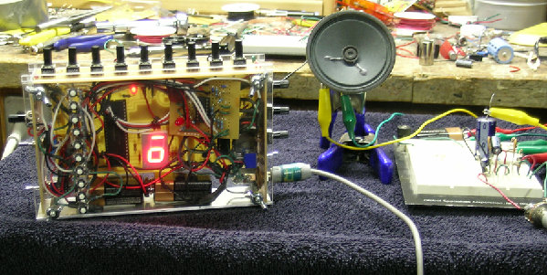

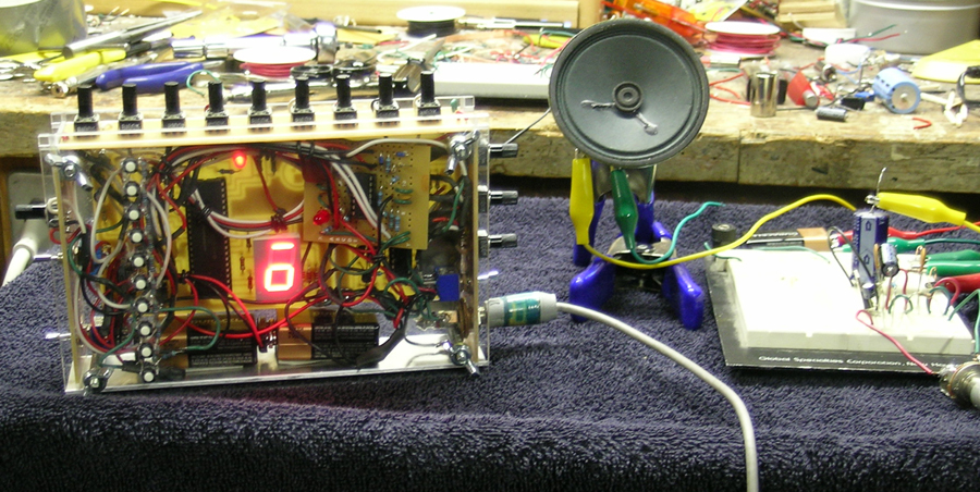

Joel
Joined: Sep 12, 2006
Posts: 97
PostPosted: Sun Apr 13, 2008 11:29 am    Post subject: Reply with quote  Mark this post and the followings unread
hi all,
I put this together this afternoon, sounds great!!

Fellow Builders,
Here's my version. I had to add a filter (a state variable SEM clone, thanks to Takeda-san and MFOS), an LFO, and a tiny button keyboard. The small LM383-based amplifier and speaker will go into the mask--pictures of that coming as soon as I get it made.Smile
Thanks,
Ole
 Filesize:  451.89 KB
 Viewed:  909 Time(s)
