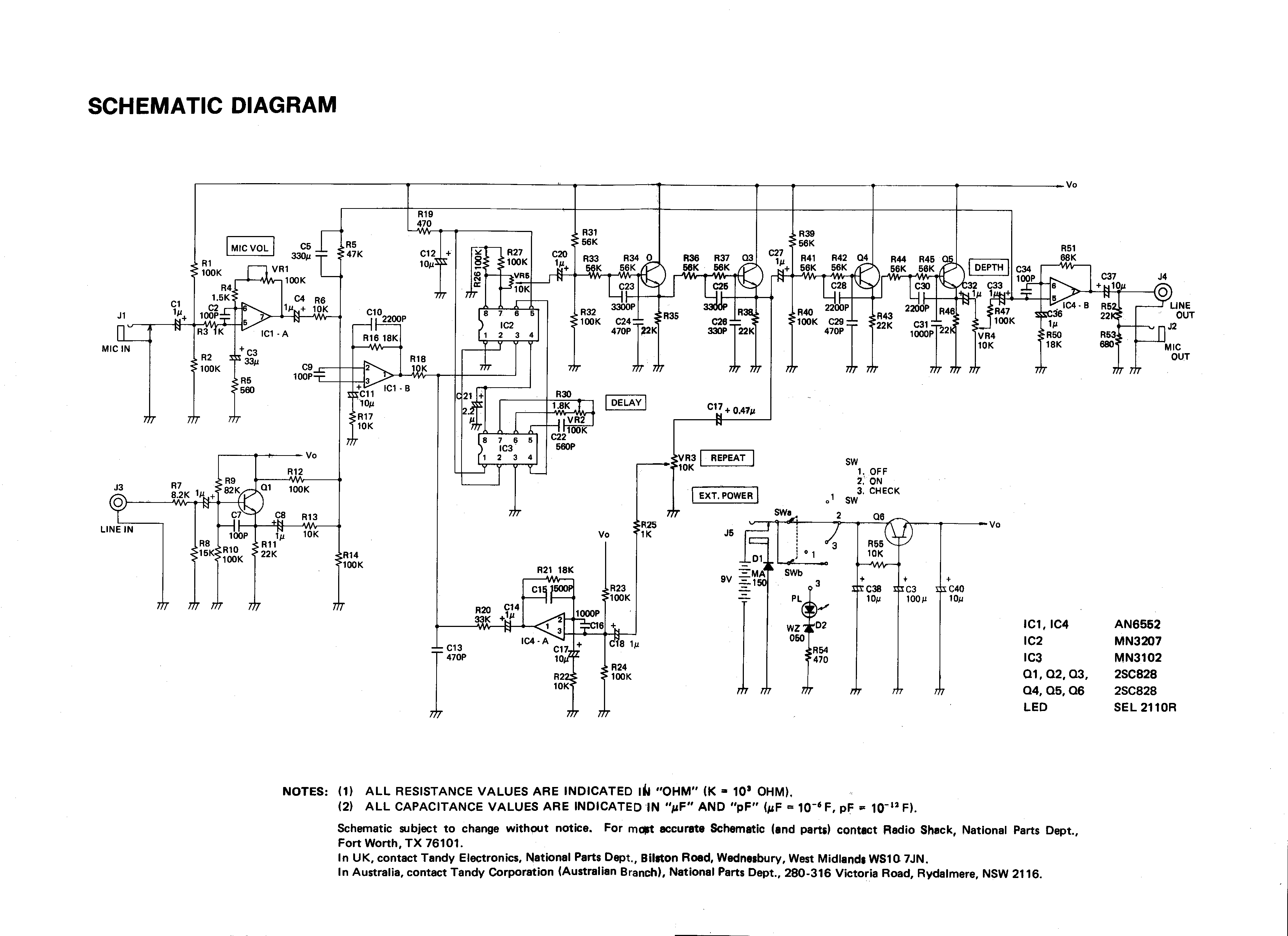

I'm attaching the schematic in case anyone feels like helping me out with this. Smile

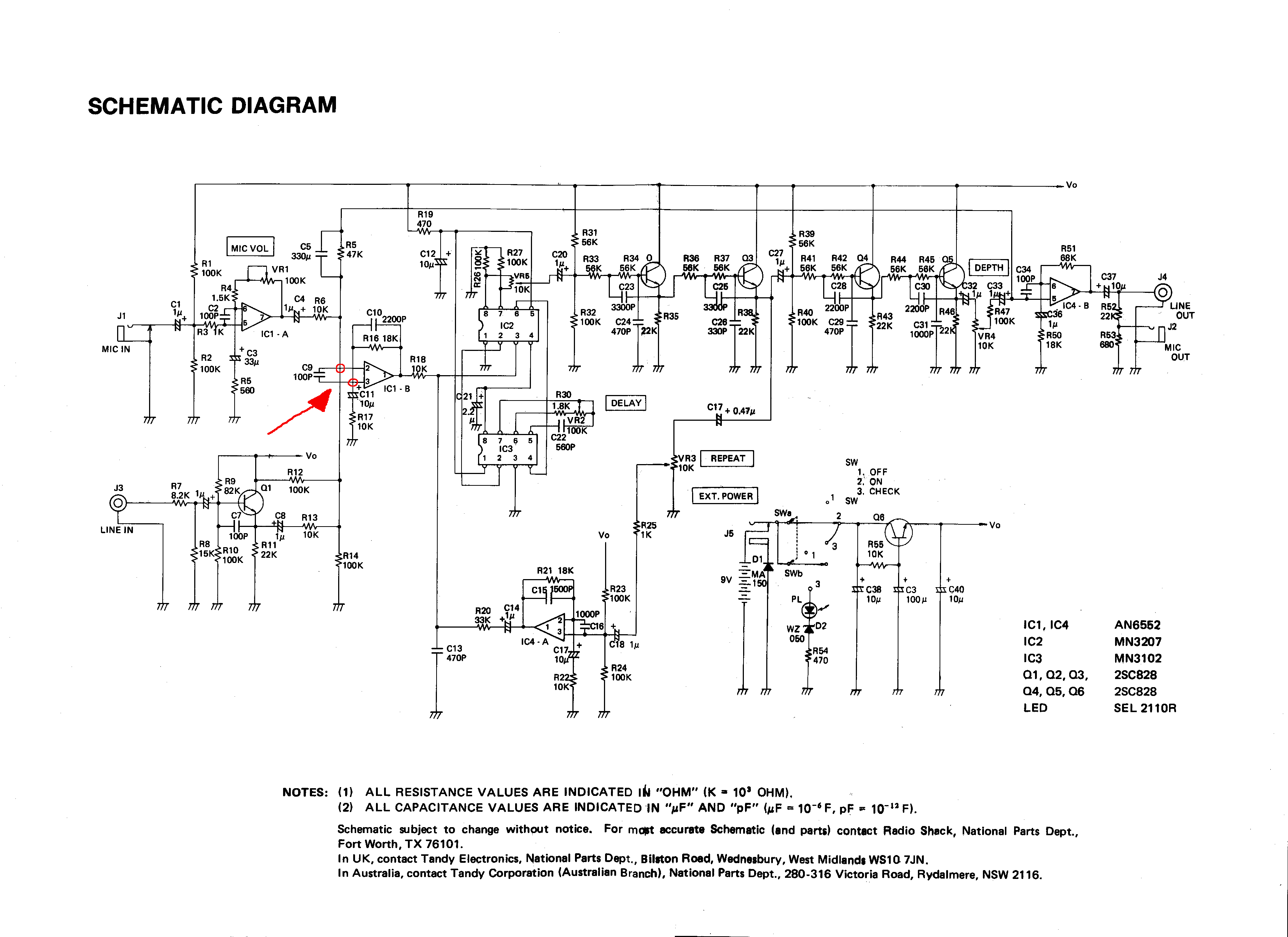

PostPosted: Sat May 24, 2008 2:55 am    Post subject:
Subject description: Schem error
I just wanted to point out that if anyone were to use the above schematic for a build or even just for reference purposes, you should note that the inputs to IC1-B are very vague. (In fact, compared to the rest of the schem the tie points here are non existent. This would result in your BBD simply listening to the sound of C9! Laughing Not very inspiring.)
At first I assumed it to be a similar setup to IC4-A, where the input is to pin3 and therefore a non-inverting stage. But upon closer inspection it seems more like likely that IC1-B is using pin2 as the input and is therefore an inverting stage.
What do the sages say?

Hey, I just got one of theese ( well without a cover! ) in a bin at a car boot, was wondering if somone could help me out understanding a few things about the schematic?
What is the trasistor stages just before the output for? the feedback seems to come off the second stage. and it is attenuated by the repeat pot is that correct? is it therefore some kind of filter?
Ill let you know how this schematic fits with the actual product, although this is a tandy reverb. tandy being the now extinct UK branch of radioshack
Clacktronics.co.uk
PostPosted: Fri Jul 25, 2008 4:02 pm    Post subject: Reply with quote  Mark this post and the followings unread
It is quite amazing that they managed to get an effect they could label "reverb" out of an MN3207! Shocked When I first saw this schematic I was surprised that it didn't have a 3011 in it. I remember this unit having a very twangy kind of "ring" to it, so it does make sense.
So I think the reason it does what it does is because of all the filtering. The 4 transistors are all set up as inverting LP filtering stages (I think), to get rid of the clock. So there's filtering before the regen out, then more filtering before the main out, there's also some kind of filtering further down the regen path (IC4-A).
My theory isn't that great, so I'm sure someone else will give a more accurate description of what's happening. It's definitely something I'd like to play with on the breadboard.

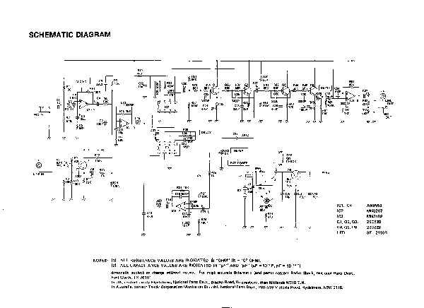

Hello I know this is an old thread, but I was wondering if someone can help me circuit bend one of these, I'm pretty much a complete novice when it comes to bending.
I've tried hooking into ic3(mn3102) with 10k and 100k pots in paralell with R30, with no luck, on further inspection I have noticed that my board seems to differ slightly to the schematic post on this thread, with R30 being connected to pin 7 on the chip instead of 6 of the schematic.
the two main things I want to add is a knob to extend the delay time and something to extend the feedback.
maybe someone has already done this and knows the exact points on the board to patch into.
