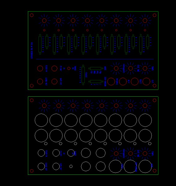

I have just looked through my files, and have found this -
The last file revision date was march of 2011, so id have to re-check it, but it was a layout i was working on for 22mm rotaries. I thought that this was the dia of the standard, cheap, alpha ones, but ive just looked, and they are larger, so id have to see if i can work out what i was up to all those years ago.
The text on the panel is rotated, but the 5u and euro panels essentially have the same layout.
 Filesize:  342.29 KB
 Viewed:  443 Time(s)
 Filesize:  342.29 KB
 Viewed:  453 Time(s)

I have been playing with the panel layout, and its certainly going to be possible to get the euro unit to work with the standard multi-position rotary that you see all over the place.
eg -
(or their pcb mount equivalent)
These switches are common, cheap, and have a long and proven history. As a brief example, theyre used in the EDP wasp (which is 40 next year!) and theyre still in production today.
In the next week or so, ill make up a test panel in euro format, to make sure. I will include the per-step portamento switches also.

The previous euro panel (as pictured elsewhere in this thread) was 40hp.
Expanding this by 2hp allows for the cheap rotary switches above to be used.
This is a very rough mock-up (please note, this is nowhere near finished) -

julian
Joined: Jan 11, 2008
Posts: 103
PostPosted: Tue Dec 12, 2017 3:10 am    Post subject: Reply with quote  Mark this post and the followings unread
My feeling is -
I dont think there was one single comment, the first time around, about the panel being too large (this was with the slide switches).
The panel this time, with the larger alpha switches, is almost exactly the same size (2hp difference).
The alpha tiwan units in my photo are about GBP 0.84 each, making the build cost to be a about GBP 16 ish on switches.
A switch costing GBP 3.50 brings the switch cost to about GBP 50 more!
Even if the cost was identical, i would still be tempted to go for the easy to find, proven unit, vs some odd hard-to-get unit. Ive cut so many panels for people where the original designer has used a part availible in their territory, and then the builder, on the other side of the globe, has issues, that i have gotten wise to it with panels that i design - i always like to make it as easy as possible for people with components!
Again, this panel is only 2hp wider than the original that used the slide switches. I dont know - maybe there will be a few people who can not tolerate that, but i think that, given price and the availability considerations, in my mind, the switch proposed wins out.
One additional point for very genuine consideration -
Out of all the people who have shown an interest in the panel, there have been very few (as in as a factor or percentage) who have an issue with the proposed component choice.
Most are fine with not having to spend GBP 50 extra on their build! : )
Again, i like to make things easy for people, rather than cater for an obsession of the minority! : )
All that said, if someone wants me to cut them a panel for whatever choice of switch they want, that is no issue at all - ill cut panels for anyone, for anything! Its just that if im going to to a bulk job to get a good price, im going to try and make things as good for the majority as i can - i am aware that you can not please all people all of the time!
If someone wants to spend GBP 50 or so extra on their choice of switch, they are probably not the person who cares too much about the cost of the panel either, so a more expensive 1-off custom job for them should not be an issue either! I guess maybe I will be able to keep all people happy that way? : )
