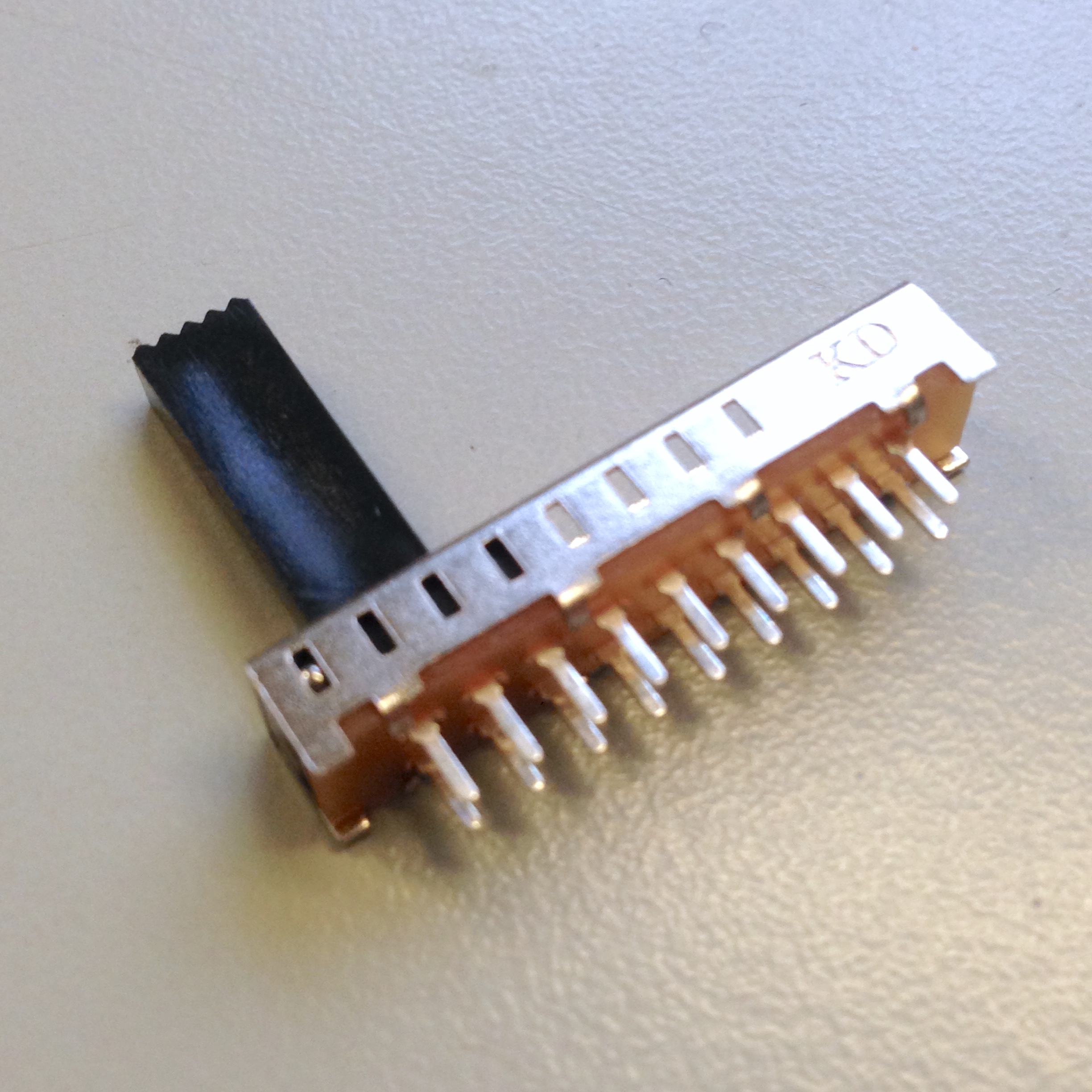

Good news !
I found a source of new 8way slide switches, they are a bit smaller
than the previous ones.
The big difference is these are PCB mount, the old ones had threaded
holes and could be panel mounted.
Any one have a preference ?
-ryk

Ayab
Joined: Oct 27, 2015
Posts: 186
PostPosted: Thu May 10, 2018 5:05 am    Post subject: Reply with quote  Mark this post and the followings unread
Well done! I am sure those will be better for a control pcb, if you are still planning one. Also always good to save a little space.
Hope the design is going well.

ryktnk wrote:
Good news !
-ryk
I don´t think in this case smaller switches are better for a control of eight positions switch.

ryktnk
Joined: Apr 24, 2008
Posts: 285
Location: london
PostPosted: Mon May 14, 2018 9:00 am    Post subject: Reply with quote  Mark this post and the followings unread
Alfredo wrote:
ryktnk wrote:
Good news !
-ryk
Travel is 2.5mm per pole, as apose to 3mm per pole on the larger switches,
so I think they are still quite usuable.
They are the same swithces used on the famous "inspired" by ryk m185
Eurorack modules.
Unfortunately these are all I can get hold of, unless people prefer
the larger panel mount switches with solder tags.
-ryk

ryktnk
Posts: 285
Location: london
PostPosted: Tue Jul 10, 2018 9:29 am    Post subject: Reply with quote  Mark this post and the followings unread
Hi
It's not a done deal, the smaller switches have an akward
schematic.
Kind of 8P 1T rather than 1P 8T !
So I might prefer using the original slightly bigger ones, which do
allow for panel mount if needed.
-ryk

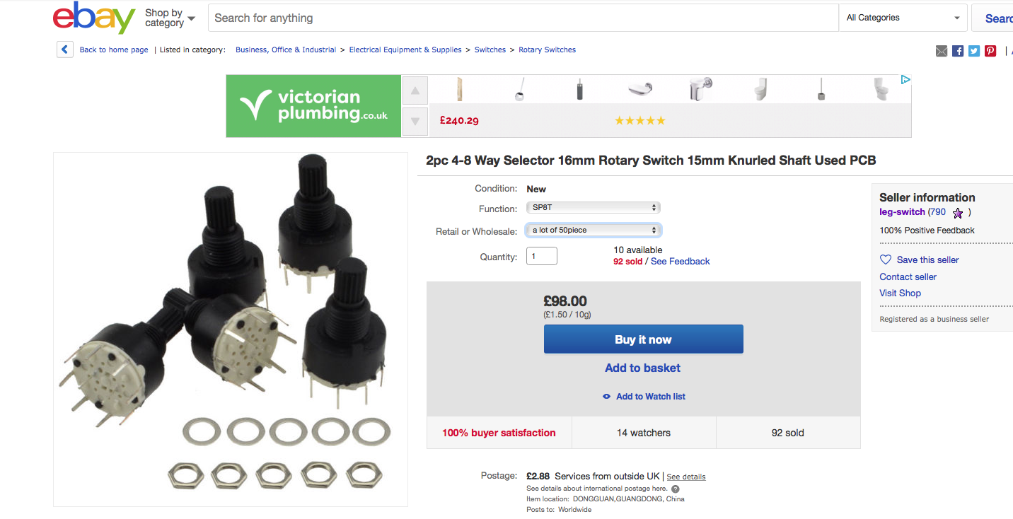

PostPosted: Wed Aug 15, 2018 11:33 am    Post subject: Reply with quote  Mark this post and the followings unread
I can also recommend the 16mm mini rotary switches which I think ryktnk suggested earlier in this thread. I ordered some from eBay for another project and fyi the company "leg-switch" are honest and very helpful. Although they sent me 2p4T by mistake, when I realised and told them they immediately sent me the correct 1p8T (even though I didn't realise for 2 months!) they work fine and are pretty good quality.
sorry about long link! :-
https://www.ebay.co.uk/itm/2pc-4-8-Way-Selector-16mm-Rotary-Switch-15mm-Knurled-Shaft-Used-PCB/112073905103?_trkparms=aid%3D111001%26algo%3DREC.SEED%26ao%3D1%26asc%3D20160908105057%26meid%3Daa5d2b8aee9e47a8ae8b79ffb40aa6a9%26pid%3D100675%26rk%3D3%26rkt%3D15%26sd%3D192465679901%26itm%3D112073905103&_trksid=p2481888.c100675.m4236&_trkparms=pageci%3Aea01488c-a0b4-11e8-ad0f-74dbd180c2da%7Cparentrq%3A3ebdcf711650aa4799fd4959fffb0b22%7Ciid%3A1
