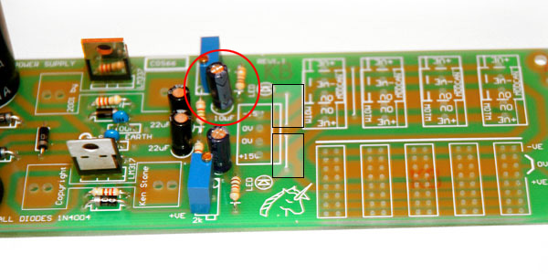

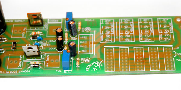

PostPosted: Wed Jul 16, 2008 1:40 pm    Post subject: Reply with quote  Mark this post and the followings unread
Another cgs66 question: does those lines (enlightened on the picture) meant to be bridged with piece of wire?
 Filesize:  51.6 KB
 Viewed:  16160 Time(s)
otherunicorn
Joined: May 11, 2008
Posts: 136
Location: Australia
PostPosted: Thu Jul 17, 2008 6:18 pm    Post subject: Reply with quote  Mark this post and the followings unread
Yes. Those are links.

zthee
Joined: Feb 20, 2008
Posts: 414
Location: Stockholm
PostPosted: Fri Jul 18, 2008 2:18 am    Post subject: Reply with quote  Mark this post and the followings unread
You might wanna flip that capacitor; as it says on the CGS website "The 10uF capacitor beside the -15V pin of the 4 pin MOTM style connector is also shown on the overlay backwards."
I think?

otherunicorn
Posts: 136
Location: Australia
PostPosted: Fri Jul 18, 2008 5:32 pm    Post subject: Reply with quote  Mark this post and the followings unread
I think?
And rather annoyingly it is still backwards on the REV1.1 board....
http://www.cgs.synth.net/
Kartoshka
Joined: Jan 13, 2008
Posts: 28
Location: Toronto, Canada
PostPosted: Sat Jul 19, 2008 5:57 am    Post subject: Reply with quote  Mark this post and the followings unread
true, how could i miss that. thanks guys again.
