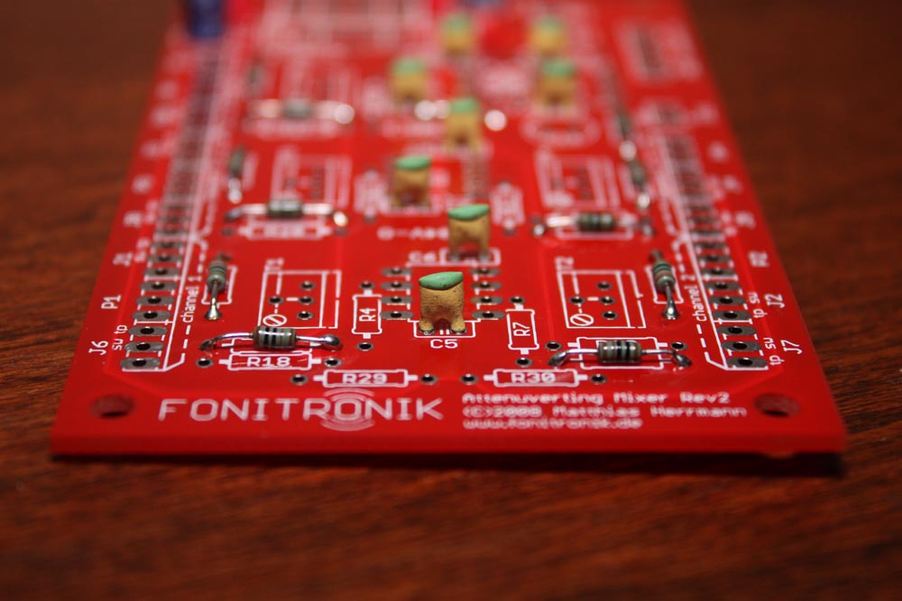

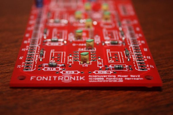

Edit: I don't see any 1% resistors indicated in the documetation. I'll thus take it that there are none required or recommended? That the trimpots negate the need? Thanks!

Peake wrote:
Received! Thank you very much! Very Happy
you are absolutely right. BTW i am always using 1% resistors since they are not much more expensive at the store i buy them...

I've got a board up and running- great stuff! My first intent is to use it to substitute for a power supply for the Moog Modules, until I get one built: 12V, -6V, and -10V rails are required (the classic power supply does not regulate the -10V). For some reason, I was only getting 1V at the internal/jack normal'd source, so I jumpered R29 to pass the full 15V to the pots. Presto, just set the pots to the desired voltages. I don't know if this will work in powering the modules yet, but it's fun to play with Smile

does anyone think i could get away with using SINGLE TURN 50k trimmers?
i really want to get this built (mainly as an audio mixer) and i have tons of single turn trimmers but NO 50k multi turn.
thanks
PostPosted: Tue Sep 23, 2008 8:26 am    Post subject: Reply with quote  Mark this post and the followings unread
thanks
actually you could get away without a trimmer and a fixed resistor instead. the trimmer is just to calibrate the processing potentiometer to OV at 12 o'clock.

PostPosted: Wed Oct 01, 2008 12:39 am    Post subject: Reply with quote  Mark this post and the followings unread
fonik wrote:
rjd2 wrote:
question on caps-any of the values should be film or polystyrene or anything? im planning on using these as VCO summers, among other uses.
there are no capacitors in the audiopath. using poly for decoupling is a good choice, i think.
Oops... should I remove and change these?
