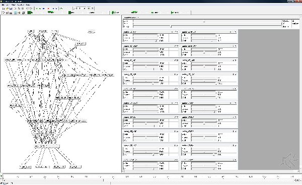

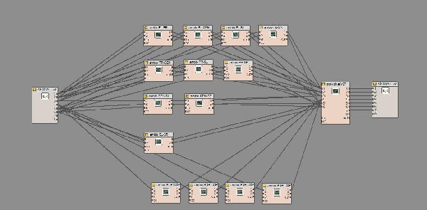

Hi again!
After the great results obtained by the mosc's ambiophonics plugin for stereo reproduction, I've been investigating about ambiophonics correction for a 5.1 setup.
The idea is to correct inter-speaker crosstalks by using several instances of the stereo crosstalk cancellation (i.e. the FL speaker interferes with the FR, CEN, SL and SR speaker; the FR speaker interferes with the FL, CEN, SL and SR speaker and so on).
In order to test this multichannel setup (in which speakers are located in an standard square-like manner), I've used a VST host (Console) and a Virtual Cable to redirect the output's media player to the host, insert several VST plugins and finally output the fully corrected signal through the sound card.
I attach the layout of the Console. Note that, for each speaker, four instances of the mosc's VST plugin are needed to individually correct its interaction against the other ones. In this way the signal is replicated (increased) four times and, in consequence, it should be significantly attenuated (-12db). Before the output you can see a multichannel convolver which models the individual IR responses of each speaker.
So far it worked. The multichannel scene is much more dense and covers the full 360º spectrum both form multichannel disks or movie soundtracks. However, it also sound a little fuzzy with the width parameter set to 10.
I am currently experimenting in individual crosstalks configurations as I assume that for example, the correction between the FL and CEN speakers (which are separated by a 20º angle) should be different from the correction between the FL and SR speakers (which conform a 180º angle between them).
The only parameter in the mosc's plugin is the Width, which suppose it controls the delay applied to the inverse signal, is it correct? The far the speakers are, the higher the value should be or is it the inverse? What do you think on this setup?
Thanks

PostPosted: Sat Feb 21, 2009 10:56 am    Post subject: Reply with quote  Mark this post and the followings unread
Wow. That's great work. We have been thinking of similar things for 5.1 but haven't tried anything yet. I personally don't have a 5.1 set up that is suitable for such tight audio. My home theater setup is for casual TV watching.
I'm sorry to say that your post will take me a long time to digest and understand. I'm in the middle of the big WinterSteam 09 prep now. I will get back to this and post a better response.
The width control on this VST controls the mix between the straight signal and the delay/crosstalk side chain. Wide is probably vertical. No canceling if far left and just the canceling signal is far right. The delay is not adjustable. You are right that the delay should be increased a bit for wider angular separation.
You need a VST with adjustable delay. I have one I'm developing that will be for sale. It's not ready to post up on the store yet though. Lemme think about maybe putting it up on the store with a free-upgrade system. I have to consult my partner in this stuff first though.

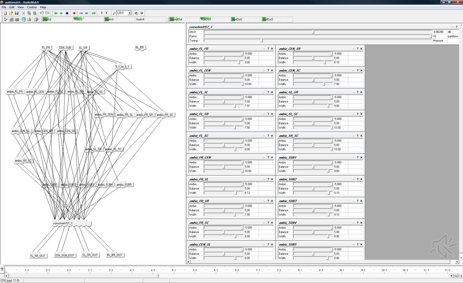

Hi again,
I've been configuring the multichannel ambiophonic setup. This time I've changed the VST host to AudioMulch as it offers a greater degree of configurability (even though a more basic interface).
The setup for a 7.1 setup is the shown in the attached figure.
Basically, I've been playing with the width control of mosc' pluging. After experimentation, I set:
- A value of 10 (maximum mix) to speakers with form an angle of 20-25º (like the FL and the CENTER channel).
- A value of 9 for speakers with form an angle of 40-50º (such as the FL and the FR or the SL and the SR).
- A value of 8 for speakers with an angle greater than 60º (like the FL agains the SL or the SR).
The individual speaker attenuations and delays are controlled via the Convolver VST plug-in.
The integration with this configuration is better an the soundstage more defined than setting all the mosc's VST instances to 10. As state above, the degree of cancellation should depend of the inter-speaker separation. The final result is a complete 360º soundstage with great localization of the instruments!.
The only issue I've found is that audiomulch is reporting that the default value for the balance control in mosc's VST plugin is 5.19 when it should be 5.
Regards
