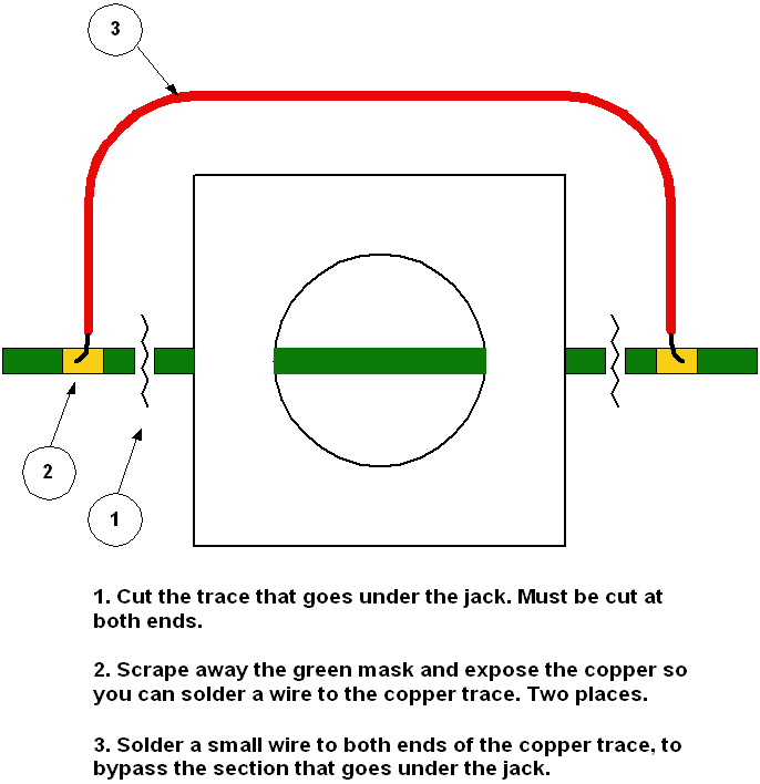

Looking at this just from a technical point, I suggest a fix. It looks to me like not all of the jacks have copper traces running under them, there may only be a few that have this problem. This fix only needs to be done to those jacks.
I'm not getting into the issue of whether a fix like this should be done by the manufacturer or if it is up to the customer, I'm just offering a technical fix. Of course, there are other options that have been discussed like using only patchcords with shorter tips, or maybe changing hardware to keep the patchcord tips away from the PCB, but I'm not sure if those are complete solutions and this fix would definitely resolve it for good.
Basically, you are bypassing the small section of copper trace that runs under the jack, so it doesn't matter if the patchcord cuts through the green mask and touches the copper. Like so:

Hi Davep! Good looking for a solution.
The matter is that there is circuit under 50 of the 65 Jack sockets of the frontpanel of the S1MK2.
also, under all the below line, the bottom line, of jacksockets pas a bus of circuits, from un side to other. I dont remember exactly ... maybe 6 lines.
All is very little because the components are SMD and also a lot of the jack sockets are switched so i f you could cut a circuit maybe you are cutting the switched signal wich maybe runs for the other side of the PCB. It's doble side PCB.
There is other solution that is to separate the jack sockets of the PCB, according my measures its possible separate almost two milimetres.
It will be difficult because the jacksockets have three legs... but I thing that there is a way to do it. The problem is that they are 65 jacksockets! and there are a lot of SMD components close the jacksockets legs, IC's included. So I'm afraid that some components can be damaged.
But I think that the real solution is to replace the PCB.
Regards.

Since April 2006 that I bought the S1, if I rest the time of the two shipments for repair it and that since May 2007 when I detected the problem with its sockets I stopped to use it because precaution, Since April 2006 I only used the S1MK2, 9 or 10 months. Not bad.
I think that a manufacturer not only has to design good synthesizers, also offer a warranty.
In November 2006 I received the S1MK2 after the second reparation; the manufacturer changed the PCB because the Oscillator2 fault.
In May 2007 I noticed the problem with its sockets, I contacted him about that and he answered me that he was aware of this problem.
The solution that he offered me doesn’t work according my measures.
The solution that I thing that works - a hole in the PCB under each jacksocket - is in the VCEQ-3 PCB that he sent me in December 2006, and, it seems, in the new S1MK2s.
My machine was under warranty and I would like that he change the PCB of my S1MK2, but this time for one that works fine.
Best Regards.

No answer, no other solution offered, so I'm opening the S1 again, I will try to separate all the 65 jack sockets 2mm from the PCB. I hope that all will be OK.
I will publish other thread with the results.
Regards.
Sound
Joined: Jun 06, 2006
Posts: 842
PostPosted: Mon Apr 06, 2009 1:53 am    Post subject: Reply with quote  Mark this post and the followings unread
I did it.
http://farm4.static.flickr.com/3640/3417726568_b211a8d69f_b.jpg
It is working.
Only the switch gate LFO does not respond to gate2, I think that this happened before, and the MIDI some times hold the first note. Let's see if I can solve it, at least the matter of the MIDI.
It is not mounted still, seems that all the other parts work OK I'm testing it, I will investigate a little more in depth.
I feel much better. Very Happy
