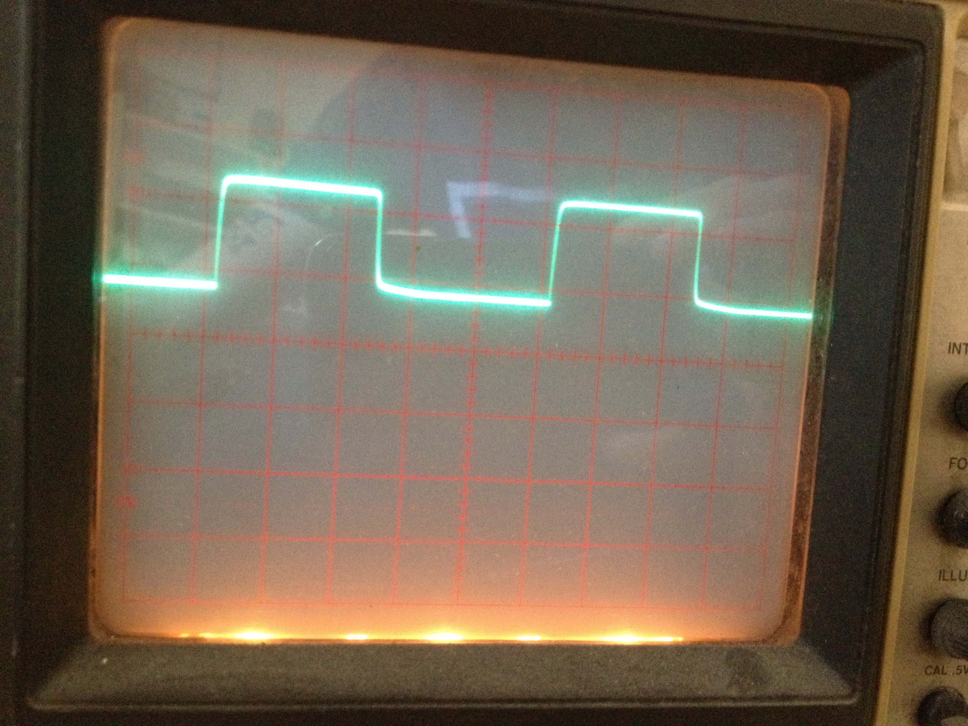

However, I have just noticed another problem. I thought something sounded a bit strange with the audio out, so I took a look on the oscilloscope.
As you can see, the bottom of the square wave is wonky. When I first built this module years ago, this was straight. This occurs on both oscillators. Where should I start looking to rectify the problem?

LetterBeacon
Joined: Mar 18, 2008
Posts: 454
PostPosted: Sun May 12, 2013 1:44 pm    Post subject: Reply with quote  Mark this post and the followings unread
It's in AC mode, and I don't know the rate. It's the same shape no matter the rate, I think.

try to put it on dc mode and lower the pitch, see if you get the same results.
PostPosted: Sun May 12, 2013 6:58 pm    Post subject: Reply with quote  Mark this post and the followings unread
Yah, what Isak said. I have an AC/DC switch on my VCF inputs and I was looking at them with the scope the other day, and a wonderful square wave input was immediately warped to have slopes top and bottom in AC mode. And there were definitely audible effects of same, even with the filter wide open.
I would hope a scope's AC input would be less prone to such things, but....

Thanks for the replies!
So in AC mode, the higher the frequency, the less wonky the bottom of the square wave. So lower frequencies have more of a wonk.
In DC mode the square wave is normal, as I expect a square wave to look. However the wave jumps down to bottom of the display meaning I have to use the DC offset knob to bring it back to the centre.
Does this mean there's a significant DC offset on my sound waves?

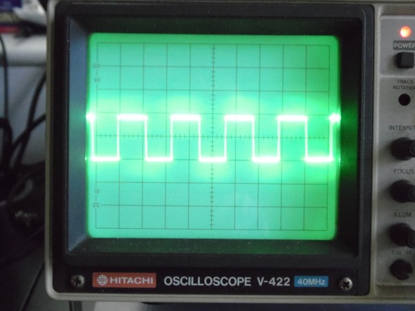

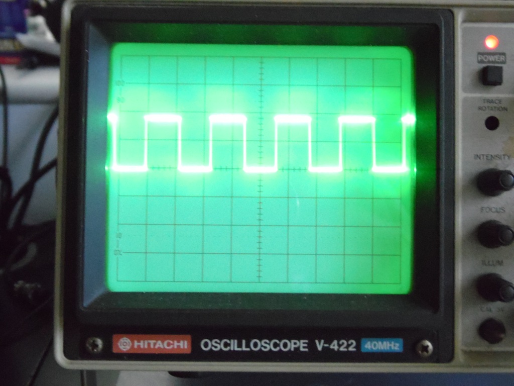

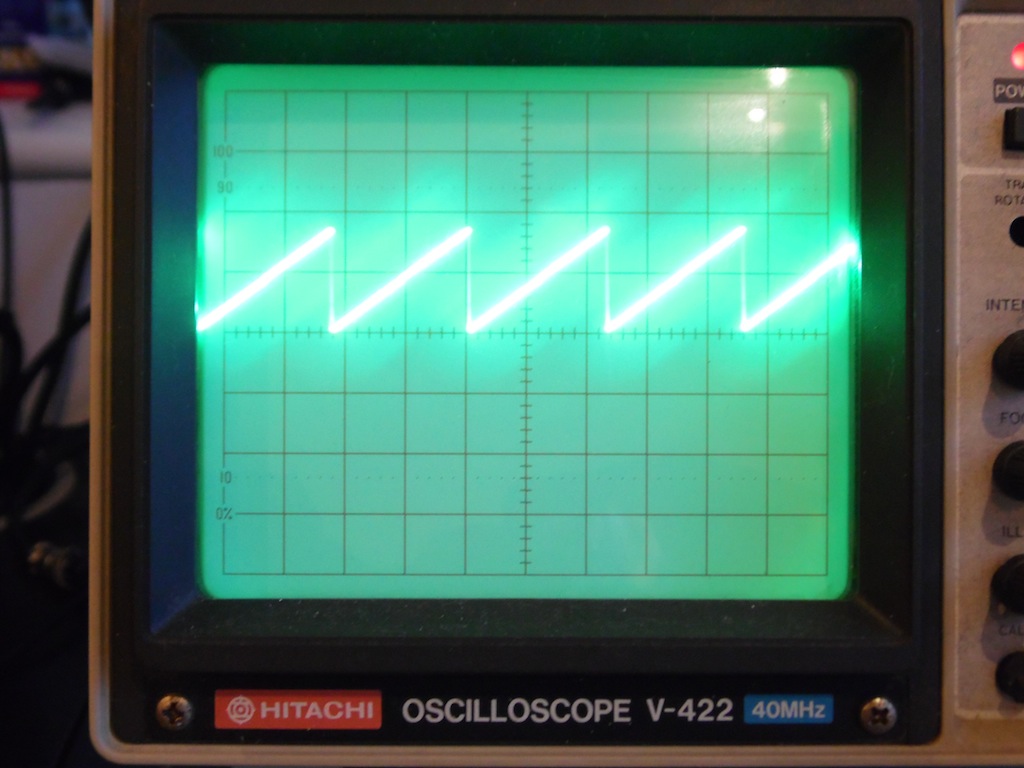

Broadwave
Joined: Feb 16, 2007
Posts: 347
Location: Manchester UK
Audio files: 6
PostPosted: Wed May 15, 2013 11:21 am    Post subject: Reply with quote  Mark this post and the followings unread
I know it's not much help, but I'm not getting any problems, the square waves are flat top & bottom in AC or DC on my scope (which is way past it's best!!). Also got a clean saw wave.
I've rechecked all my boards, and there's nothing that I've added or changed... the files I uploaded are exactly as I use here at home.
All the components I use are exact (no substitutions) and I use Hydro Flux Solder (water soluble - leaves no flux on the board once cleaned with a toothbrush and water!)
I wish I could be of more help... I feel a bit useless not being able to.

Hi Andy,
I built the VCOs nearly five years ago now, and at the time they worked perfectly. I put my modular in storage for a couple of years and have now got it out again.
I noticed a bit of corrosion on the PCB, and used some isopropyl alcohol to scrape it off. Measuring the DC offset and the wonky square waves must mean that something is still wrong, as I'm sure I used to have normal waveforms and no DC offset before.
So you posting those wave shapes means that I'm not going mad, and it is possible that I had perfect wave shapes a few years ago.
It's strange that I get the weird wave shape on both oscillators. Do the square waves share some circuitry? I think they share the ring mod section, don't they? Maybe I need to look there. Actually, the ring mod has a DC offset doesn't it? Maybe something's gone wrong around there, and the DC offset is added from there.
What do you think?

@LetterBeacon
The only component I can think of that's shared is the 4011, maybe start there... check the square waves before they go to the 4011 too?
Are your Saw waves OK?

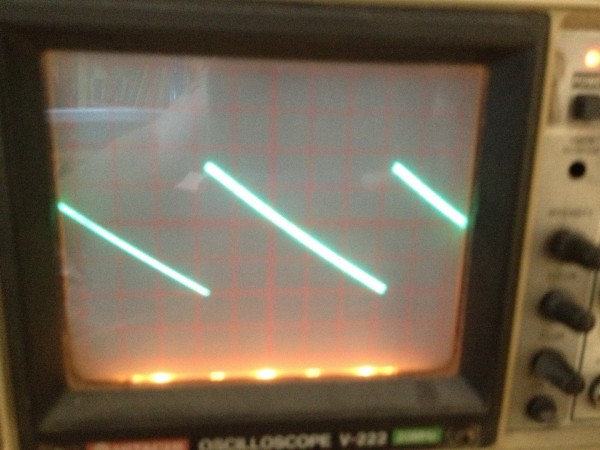

I just checked my saw waves (pin 3 on the 3046) and in AC mode there's a tiny little curve to the triangle slope, so it looks like my saw waves aren't healthy!
I get a 'rounded' square wave measuring just over 2V with a 2V offset going into the 4011 on (pins 2 and 12).
I then get a 15V square wave -normal looking in DC mode, wonky looking in AC mode- at pins 3 and 11 of the 4011.
I've attached photos in case they help at all...!

LetterBeacon
Posts: 454
PostPosted: Wed May 29, 2013 8:02 am    Post subject: Reply with quote  Mark this post and the followings unread
Because this is an issue with both oscillators, could this be a test equipment problem? Could the AC input on my scope be warping the waveforms?
