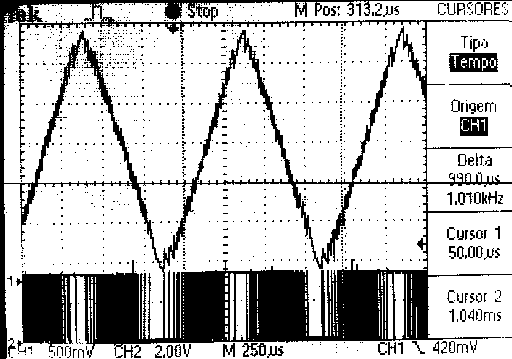

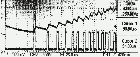

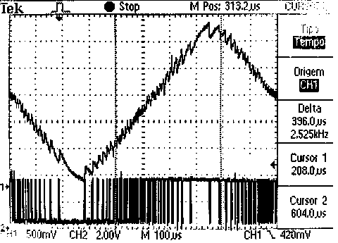

PostPosted: Thu Nov 27, 2008 5:54 am    Post subject: Reply with quote  Mark this post and the followings unread
Where some pics from my currently (bad) implementation. :\
Bit rate: 250Khz -- 300Khz (using uC @ 14.7MIPS)
3.2V
RC circuit: R = 100K...200K? C = 0.2nF
CornerCutOff = 4Khz...8Khz

PostPosted: Thu Nov 27, 2008 6:41 pm    Post subject: Reply with quote  Mark this post and the followings unread
picsynth wrote:
So what I think you are attemping is Pulse Width Modulation (= pulse density modulation)
No, as far as I can understand is total diferent. PWM is diferent of PDM
PWM is as you describe:
ie Average width of pulses is used to represent an analog value.
The wider the pulse the greater the analog value.
The resistor and cap are used to average the PWM signal/convert it to analog ?
Translated to "english" Pulse Width Modulation means, your are modulating the pulse width, making it wider or shorter, thats as you describe.
The PDM, also called? Digital Stream Modulation .. and I supose its also compared or called? Sigma-delta modulation.
Means Pulse Density Modulation, we module the pulse density, making it more often pulsed .. or less oftend pulsed.
In PICSynth I am not using PWM. Instead I am outputting 50/50 duty cycle square waves. I determine the length of period/2 using 16 bit timers - and toggle the outputs.
I think its PWM too.. with dutycycle 50%.. the diference is probably your are not using PWM module, but are using "software timmer/comparator" to make the pulse width/frekency.. You can do it too with PWM pic module.. you just need to reload timmer counters to setup desired frekncy, i supose.
One way to diferent the PWM and PDM is, in PWM the SUM(time on and time off) ==period and thats the time you have to setup a value (ie voltage)
and then, in next period time, you will vary the dutycycle to make a diferent value (voltage) and so on...
in PDM the current voltage(value) depends on last one (so its delta)
you sum a quanty of deltaV to last value and got the actual V..
lets compare,
PWM 50% value
|11110000|11110000|11110000|11110000|
PDM 50% value
.... |10101010|10101010|101010101|101010101|... and so on
and the best.. is that if the next value increase or decrease, it is delta/error adaptative.. correction are made bit a bit.... and not as PWM period .. a period..
I dont know much what frekency is need in a PWM approach to make it compare to a "PCM"..

PostPosted: Thu Nov 27, 2008 6:53 pm    Post subject: Reply with quote  Mark this post and the followings unread
Ah I see the difference now... so cursor 2 is showing the pulses, more pulses = higher analog value.

PostPosted: Thu Nov 27, 2008 8:03 pm    Post subject: Reply with quote  Mark this post and the followings unread
Well.. yes.. and no.. yes pulses.. or not.. I dont know what call it, but in this case pulses are "discret temporal stat of output beeing 1 ou 0 and time between a switch"
and if its 1, it charge the cap (at speed of RC) if its 0, it discharge the cap (at speed of RC)...
theorical, PDM output at a very high frequency, so it can easly be cutoff and get in the earing frekencys (<22K) ... but.. if you are draw a TRI shape, it wont probably be at 22K, (a think max in MIDI are 11Khz note).. so, differently from PCM, with PDM you get "smoth frekencys" at earing frekencus...

But.. I can have a DSD source signal too, instead having a wavetable with samples, have a waveBITtable, but that should be a huge amount of data :\
sigmaDeltaDACs, uhmm I fell much confused with that:
http://www.beis.de/Elektronik/DeltaSigma/DeltaSigma.html
seams Ill need more stuff, and that will be a "DIY DAC" uhm

Ah, you have a DSD input signal. Smile
Let's see...
DSD bit rate = 44.1 ksamp/sec * 64 * 1 bit/samp = 2.8224 Mbit/sec
PCM (16-bit) rate = 44.1 ksamp/sec * 16 bit/sample = 705.6 kbit/sec
PCM (24-bit) rate = 44.1 ksamp/sec * 24 bit/sample = 1.0584 Mbit/sec
OK you're right that according to those over sample rates and bit depths DSD appears to use more memory than PCM. Can you do MATLAB/Octave simulations to see how low of an over sample rate you could get away with and still meet your specifications with DSD?
urbanscallywag
Joined: Nov 30, 2007
Posts: 317
Location: sometimes
PostPosted: Sat Nov 29, 2008 10:47 am    Post subject: Reply with quote  Mark this post and the followings unread
Nice plots by the way. Cool

I've just sugested that I can have the DSD storage... right now what I do in this example , and what I have in mind is a tri wave, so, I'm calculating not only every bit sample, and also a "line equation" with x and y steps and delta errors.. so.. its real synthetized Razz
urbanscallywag
Posts: 317
Location: sometimes
PostPosted: Sat Nov 29, 2008 11:28 am    Post subject: Reply with quote  Mark this post and the followings unread
Oh I see.
Well either way I would try and do some simulations to verify that you've hit the limit of what the PIC is capable or if there's more performance to squeeze out.
Or else look into sigma-delta like most every other system uses (though I do find what you're doing interesting). Smile
