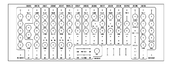

I thought I'd share my 19" rack, Serge-grid-style 808 drum panel layout. I'm sure I've forgotten lots of awesome stuff I could add, but it should be pretty crazy when done. It connects to my "Master Drum Control" module which distributes MIDI triggers to all the voices, behind the panels.
The V8 Sim is CGS and I just threw it on there because I had an extra slot. In hindsight maybe some sort of an effect is better. 909 BD is also there for extra space (and because I want two, and after building my 9090, I'll have 'em!)

Nice panel creatorlars! Also crowded! I 've seen you 've added nice features, like noise gain, boost for 808 bd, noise/ osc for 'brass drums', mix out... REALLY NICE!

Glad to hear it! The panel is dense but the artwork is misleading -- the lines around each knob aren't the size of the actual knobs (which are 1/2").

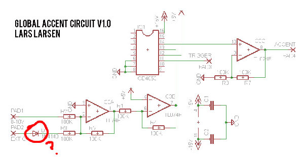

I wired up my Noise/Schmitt/Accent circuit board layout last night but am having trouble getting the accent to behave properly. Rather than try to debug the circuit (which is a little over my head), I decided to come up with my own using a CD4053 as a logic-controlled switch.
Here's the schematic -- can anyone tell me if this looks right? The diode at the External CV input is what I'm most worried about -- the intended purpose of this is to remove any negative voltage from the external input. Will it work that way? CD4053 can only accept a 15V p-p input signal range, so I tied negative power pin to GND (and that's also the point of the diode on the Ext CV input.)
The circuit should produce a constant +5V when not triggered, but +5V to +15V when triggered.

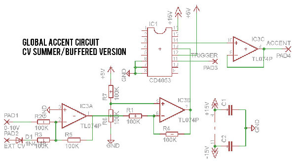

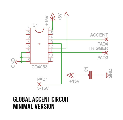

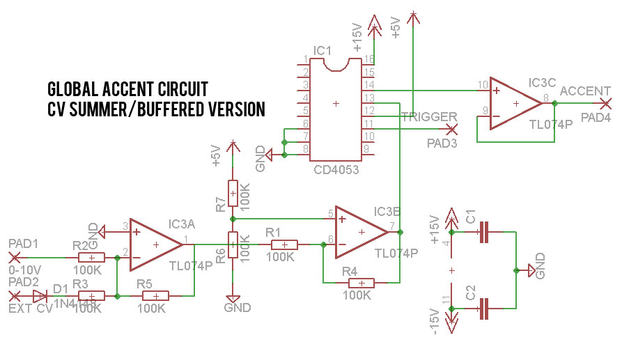

After a very long weekend of work, I'm happy to report that this new accent circuit works great (with a couple resistor changes). Please let me know if you'd like an updated schematic.
My PCB layout for Noise+Schmitt Trigger works fine too, but I need to revise it for easier etching before posting (if there's interest.)
Also, the vactrol VC mod for BD tuning works as well! It doesn't respond well to audio rates, but LFO/Envelope inputs work fine.

Sebo -- no problem, I'll post it tomorrow. The circuit is pretty clean as-is and works great. If you have no need for a CV summer and are using all three channels of the CD4053 you can avoid the op-amp and associated resistors entirely I think.
creatorlars
Joined: Nov 26, 2007
Posts: 524
Location: Denton, TX
PostPosted: Tue May 05, 2009 9:03 am    Post subject: Reply with quote  Mark this post and the followings unread
Okay, here are two versions of the circuit. The full CV/Buffered version is working and tested.
The minimal version shouldn't have any problems at all (I doubt the output buffer is really necessary). Furthermore, you could easily access the remaining B and C pins on the 4053 to get three accent circuits out of a single 4053, making this an extremely lightweight solution.

I was thinking in something like the first circuit (the simpler one).
Thanks a lot!!!
