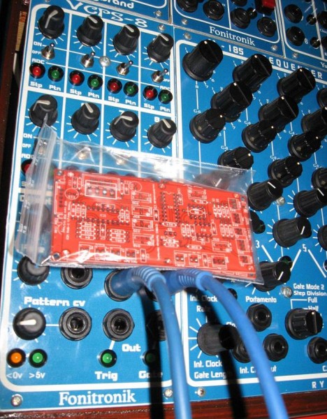

PostPosted: Tue Jul 17, 2012 10:10 am    Post subject: Reply with quote  Mark this post and the followings unread
Hi Matthias.
Thanks for the quick delivery , all good & safe , im looking forward to building these Smile .
Cheers.
 Filesize:  150.43 KB
 Viewed:  830 Time(s)
