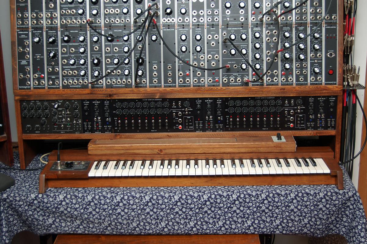

I finally got around to finishing my row of Frac modules, the modules are all of my own design, panels are from FPE.
1x Tuneable Noise, base on my pcb layout for the Liquid Hi Hat
1x Gate Delay (New version)
1x LPG, my own layout
3x Gate Delay (old version)
3x Voltage Controlled Clock, based on the Aries clock module
3x XR LFO, LFO based on the XR2206
2x 8 Channel Sequencers
The old version of the Gate Delay just delayed the start of the gate, it still ended when you released the key, I wasn't happy with that,
so I redesigned it, the new version has 4 modes,
Normal - works the same as the old version
Extended - Delays the start of the gate, and lets you extend the gate past the point where you release the key
Manual - delays the start of the gate, and lets you set a specific length, regardless of whether the key has been released
Timed - delays the start of the gate and keeps it on for the same length of time as the key was held down.
The sequencers can run of an internal clock, or the length can be set individually for each step, they also have a Cascade output so you can chain them together,
the time between triggering the next sequencer in the chain is adjustable.
I am currently working on a couple Midi projects (I'm using blue panels on them), and a cv keyboard retrofit for the cheap (M-Audio) Fatar keyboards
I am also in the process of building a CNC engraving machine, so I can start doing the panels myself.
This has occurred to me as well. I took advantage of the Cyber Monday sales to get a PDF copy of "Build Your Own CNC Machine" on aPress, by Patrick Hood-Daniel and James Floyd Kelly. It uses a laminate router...
I'd be really interested to hear about anything you learn in the process. I don't think I'm ready to bite off on this project for a while, but I'm reallly interested for the longer term.

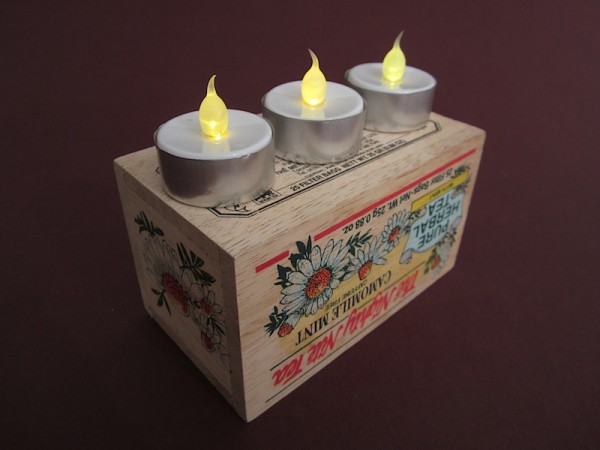

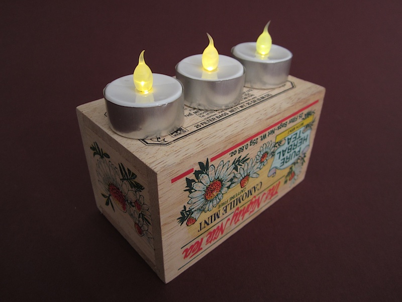

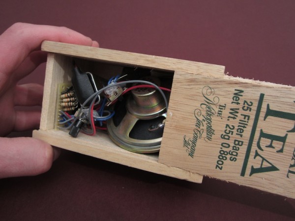

This is a silly and simple little build for a laugh. After the disastrous Sweet32 Speaker Interrupter-Switcher Installation thing which will require some difficult debugging to get working, I decided to build something really quick & easy that was sure to work. Better that than give up electronics!
Inspired by PHOBoS' discovery that the flickering LEDs in dollar-store electronic tea candles make sound, I wired 3 of them up and sent the sound to a speaker, putting the whole lot in a wooden tea box. There's a volume knob and a switch to turn the speaker off, and tap wires for a line out.
A quick demo can be seen here: http://youtu.be/GE7RyhDhcyo
James.

Tea candle noise box interior

Tea candle noise box exterior

what a lovely box Very Happy .
but to be faiir it's not my discovery, I think I got the idea from here.
But I had not seen them used in a lunetta before.
And is it just me or does it sound like they are communicating/arguing with eachother . I was actually
working on a circuit to make them 'listen' to eachother and respond, involving a shiftregister. Which is why I started
with them in my modular lunetta. Cool (to save breadboard space)

That tea-box-fickering-candle thing is brilliant Laughing the sound makes me laugh, it just sounds so silly! but very effective Smile
Yeah, that's what it makes me think of too.
Psyingo wrote:
dollarama?!
Yes. I bought several last year. Haven't checked if they still carry them this year.
Silly indeed!
Of course, I was thinking of having LFO's control the volume of each LED, but hey, this was supposed to be a quick, silly thing. I think the only thing I would do is maybe put a smaller speaker, anchor it better so it rattles the box less, and maybe put a few holes for the sound.
James.

Very cool. I like the arguing candles... Very Happy

Actually, when one starts listening to them for a while, it gets pretty hypnotic and interesting.
And for those in Canada, the Dollarama indeed carries these electronic tea candles (at least until x-mas)... 2 for a buck, get 'm while they're hot. (Truth be told, I never checked if one can order just the raw LEDs from somewhere even cheaper).
James.

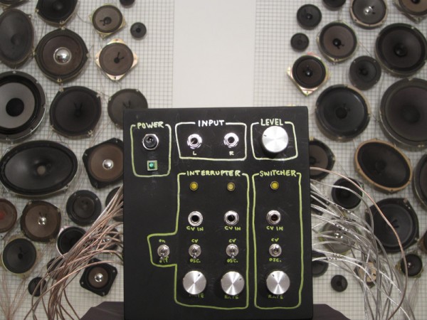

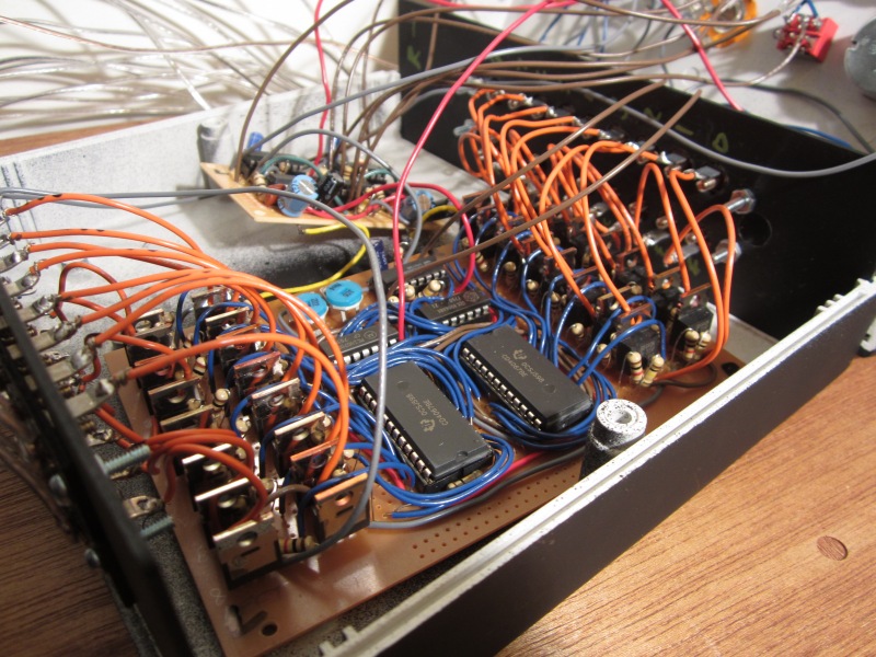

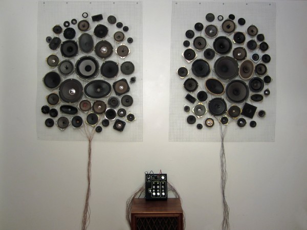

The Sweet32 Speaker Interrupter-Switcher Installation Thing
After a few years of collecting speakers from stuff found in the trash, I finally got them off the floor and onto the wall. There are 47 speakers per panel, but only 16 per panel are wired up to the control box. The box takes a 2 channel input and randomly selects which of the speakers the sound is directed to (for each panel). The rate can be controlled by the knob, or via an external CV. There is also the optional interruption control on a per-channel basis... this cuts the sound going to a panel according to the rate set via the knob (or external CV). Alas, the box and the speakers are not very clean-sounding, so not just any audio is suitable. It is best to feed it with simple drone oscillators.
No video could really demonstrate what this installation sounds like in person, with the sound moving around. If you're in Montreal, Canada, maybe we could arrange a visit...
An automatic drone box for use with this thing is possibly in the works....
I've lost count of how many hours this thing took to make. I must be insane.
James.
Overall view of the installation.

Control box

Inside the control box. Yeah, that's 32 MOSFET transistors in there!

PostPosted: Sun Dec 23, 2012 9:46 am    Post subject: Reply with quote  Mark this post and the followings unread
Insane.... and amazing Smile That looks excellent, and I wish I could hear it.
Posts: 24460
Audio files: 297
PostPosted: Sun Dec 23, 2012 10:17 am    Post subject: Reply with quote  Mark this post and the followings unread
Can imagine, it looks great at least on the pictures and I like the idea too.
Posts: 5850
PostPosted: Sun Dec 23, 2012 10:57 am    Post subject: Reply with quote  Mark this post and the followings unread
Shocked
that's awesome!, how does it sound with the teacandles ? Laughing
