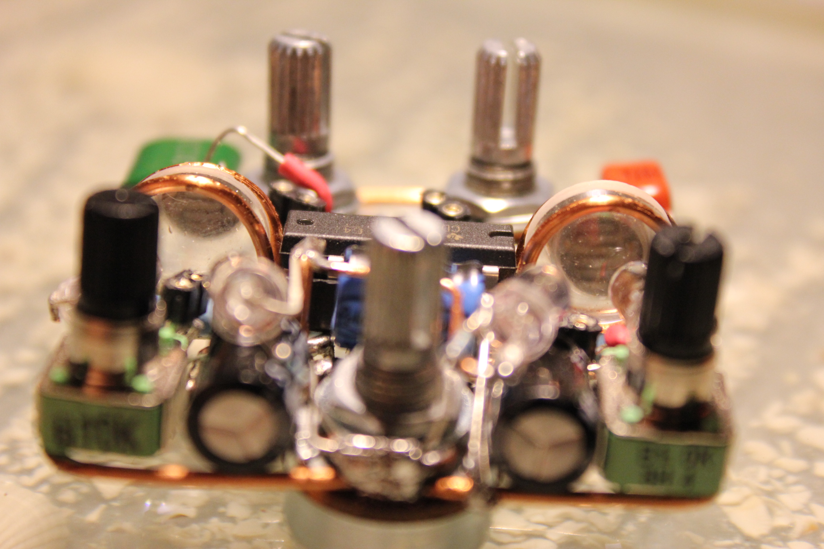

Thankyou all so much for the kind words of support.
Being locked away in my workshop without anyone else around to see these things, its great that I am able to find other people interested in the same things as me.
Firstly JingleJoes query about the quietness of the string resonance. There are multiple reasons for this, some will be rectified. I basically designed the Lunetta Guitar to be electric rather than acoustic although it would be easy to affix a resonant chambers under the bridges. The Magnetic pickups I made are not as sensitive as I would have liked but there are ways around this. As the strings are bass strings they require more plectrum power so am thinking of switching over to more powerful servo motors and converting the gate into a powerful trigger.
I did a live performance with this instrument last week and it went well but it would have been better if I got more movement out of the strings, thus a hotter signal into the effects pedals. A few of the other things I realized while performing with it was that the super bright LEDs were SUPER bright and it would be nice to have actual Lunetta synth sounds directly related to the string sequencing to play around with on the fly.
So I have made this module to remedy some of the current issues, many more will follow of coarse. As this is a freeform sculpture thread I wont clutter and make this post any longer by explaining its function but for those interested the info is written in the youtube page:

looks and sounds great Razz
love the little lenses!

That both looks and sounds fucking brilliant Very Happy
Excellent work! The LDR control you implemented works very well Smile

Wow, those are wonderful little works of art! Interesting that you didn't isolate the LDRs from ambient light, as is common to do. Yet they seem to work fine... perhaps those lovely lenses help.

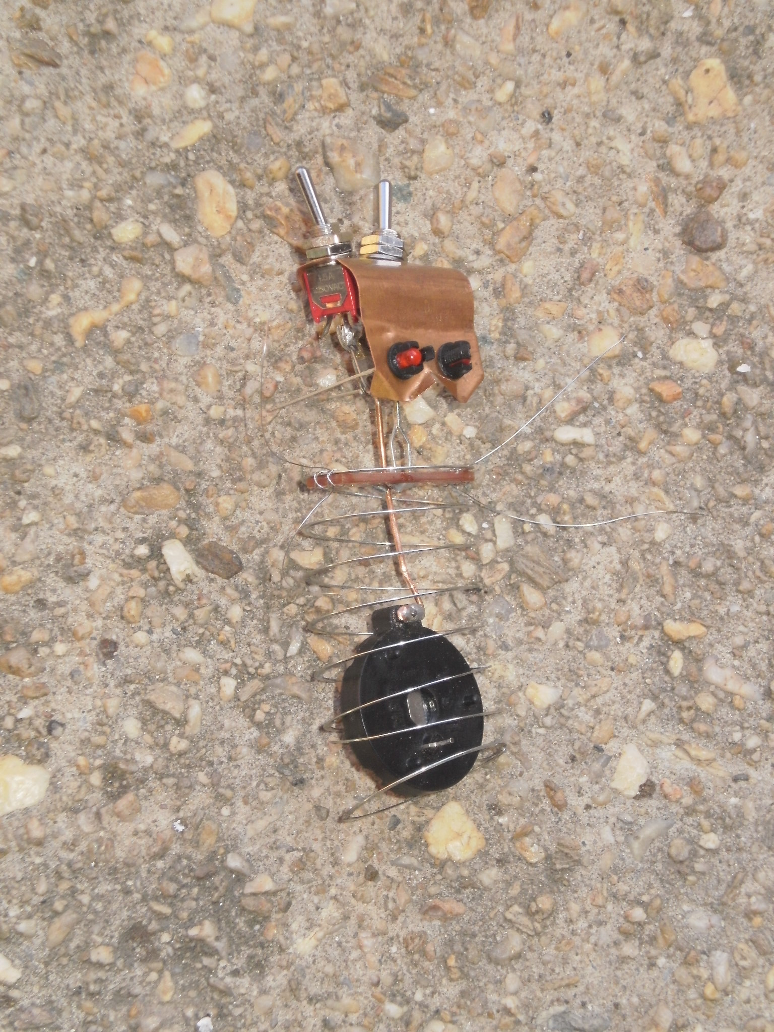

PostPosted: Wed Jun 06, 2012 8:41 pm    Post subject: Reply with quote  Mark this post and the followings unread
I thought I'd share this here, even though it is not exactly a Lunetta, as it could become one, and shows some similar construction ideas.
I started it one night on a whim. Why? Not sure. I work on it at night when I need some time out from other things. So it's nowhere near finished yet. Maybe people will appreciate seeing the process. Besides that, I have no idea when it would be finished. And I was photographing another thing anyway.
At this stage I plan on making it a kind of electronic satyr. It's definitely more of a sculpture than a lunetta, so I do take liberties with the construction ethos. (to me, pure air wired electronics should only be held together with solder) I'm allowing super-glue (cynoacrylate), contact glue, and I've even started "sewing" parts together with 32 gauge wire!
This is so I can incorporate more aesthetic features, which are important in representing the right structure. Components, and solder are, however, my preffered M.O.
I'll leave more detailed descriptions until anyone asks detailed questions, which are welcome. Smile

Great. What is its current function? Springs are such useful things! Is that a piezo in the spring between the battery and switches?
PostPosted: Wed Jun 06, 2012 11:05 pm    Post subject: Reply with quote  Mark this post and the followings unread
The creator hasn't bestowed a function on this little critter yet. Laughing
It will have CMOS driven eye and heart LEDs, and then I think I'll incorporate a sound of some kind, seeing as how this a Lunetta thread. But it doesn't have a piezo at this stage.

For a second I thought that was a miniature spring-reverb robot Laughing

The brown section is a piece of stripboard which has +V and Gnd connections on it. Structurally, it will hold the shoulder points, which will transfer through smaller stripboards for limb joints,.........I think.
I want the larger components which make up the limbs to be functional, but stripboard can easily get weak, when the copper pads lift off the substrata. This needs to be a bit stronger than that, but I am goin to traverse these components with solid copper to make the circuit. May be that would be strong enough? Any ideas?
The disc at the base is a battery holder, designed for a 2032, but I put in 2* 2016s. You do know that the last two digits tell you the thickness in mm?
This will give me 6V to play with on the CMOS chips. Good for driving the LEDs, and I think I could drive a small piezo from the CMOS directly as well.
Is this sound thinking?

It distinctly is Lunetta freeforming in a sculptural sense you are doing so I think it should stay here.
Solid copper is the way to go I think... At themoment Im looking for a cheap source for 3-4mm brass rod.

If you want to make a stronger connection to stripboard put the component through the hole as normal, then feed the lead back through the hole next to it on the same row, and wrap it around the bit of component wire poking out on the component side of the board, solder liberally.
This is how I made test points and power connections on older boards I made Smile
