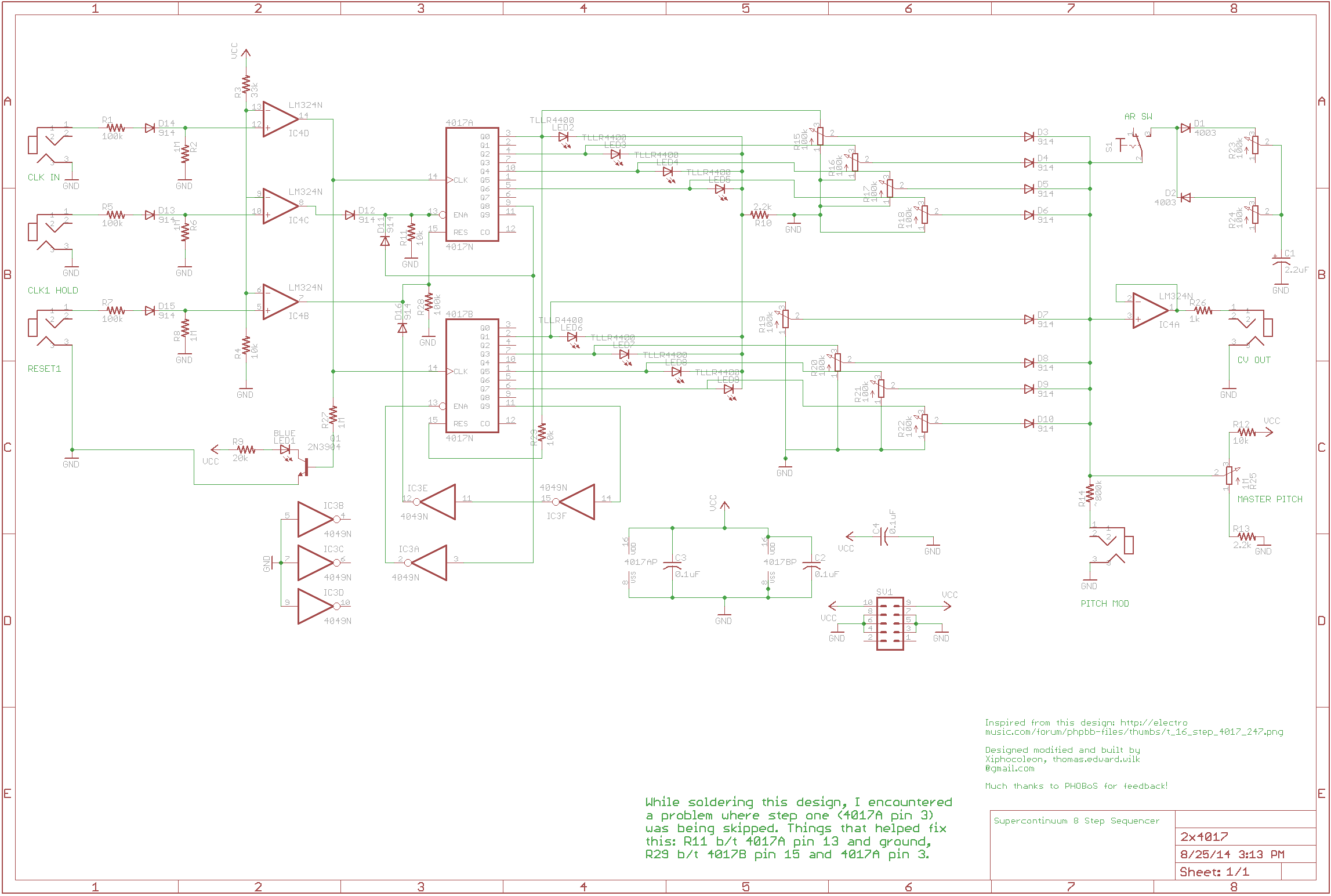

Attached is an image of the 8 step 4017 sequencer I built with help from PHOBoS. If you have any questions about building it or its operation, or want the original Eagle file, message me.

two questions:
what is the "CLCK1 HOLD" Jack for?
what does the AR Switch do? I assume you get attack and release control for each gate, is that correct?
also, could you post the eagle files please?
thank you!

Hi creekree --
The CLCK1 Hold will stop the first 4017 from counting when a high (or maybe low, I'd have to check) signal is present here.
The AR switch, when on, will activate the attack and release pots, so that break the rigid pulse shape of the outputs.
My Eagle files are on my other computer, but I will post them soon.
As some notes to this design, now that I've been using it in my modular for a little bit:
-I would like to adjust the sensitivity for clock inputs so waveshapes as low as 5Vpp could trigger the clock. I would have to scope this out, but I think the clock input wave, has to be at least 10Vpp to trigger the clock
you can easily change the clock threshold by adjusting the voltage divider (R3/R4) in the LM324 comparator.

xiphocoleon wrote:
Hi all -- the Eagle file for the 2x4017 sequencer is attached here. Let me know if you can't open it.
'Got a question, regarding your note at the bottom.
Is this problem fixed in the schemo?

Snaper wrote:
Im planning to create a single sisded PCB art for home etching.
Not sure if I remember correctly but when xiphocoleon mentioned the skipping of step 1 we both looked for a solution.
I came up with reducing R11 from 100K to 10K, while xiphocoleon came up with adding R29.
So yes it should be fixed. (although I haven't tested the full circuit in this form myself)

The schematic as posted works for the parts on my bench Smile
That being said, I'd highly recommend prototyping it out and see if you encounter any glitches. The two resistors in the note on the schematic helped my system function and in using a hand-soldered version of this sequencer for a couple months now, I haven't noticed any irregularities in its operation.
