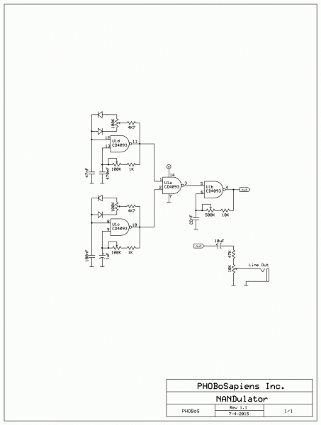

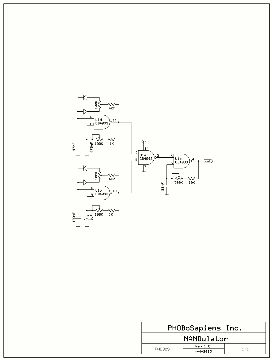

I was wondering if I could use a NAND gate to make 2 oscillators since it has 2 inputs. So I did some experiments
and ended up with the circuit build around U1c/U1d. By itself it can produce modulated sounds, PWM and a sort
of a stepped APC like sound. I didn't want to waste the other 3 gates so I made another one of those circuits,
mixed them together with a 3rd NAND and used the output to modulate another oscillator. resulting in
The NANDulator Cool
I recorded a quick demo which has the NANDulator with some reverb. I'm using trimpots at the moment and I think the 500K
is a bit scratchy so it produced a bit of extra weirdness. You should get much better control with real pots.
And as always: experiment!
NOTE: NOT ALL 4093 CHIPS SEEM TO WORK PROPERLY IN THE NANDulator, MORE INFO IN THIS POST!
NANDulator schematic

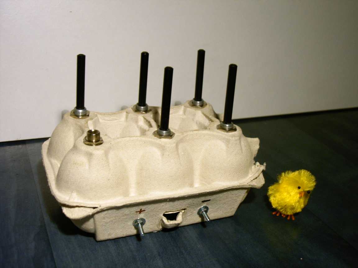

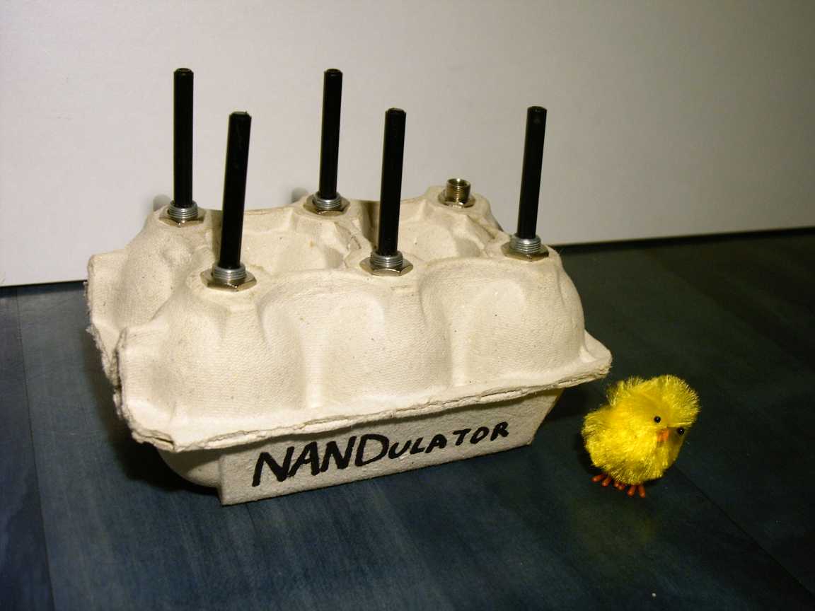

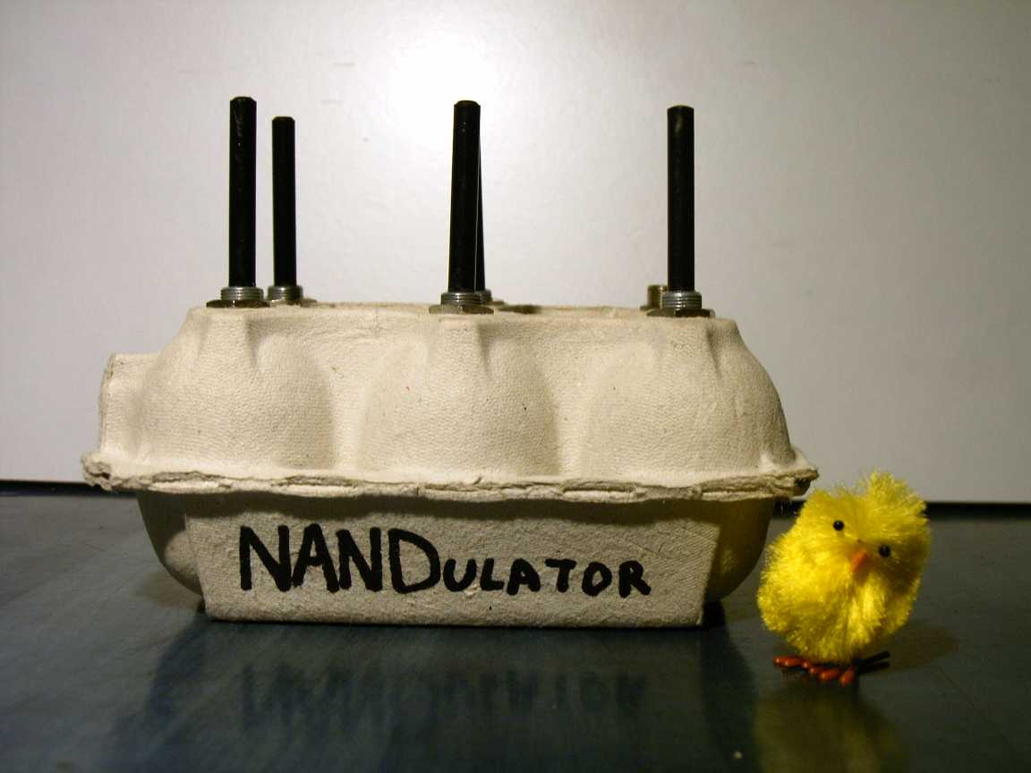

I just put together an easter edition so here are some photos albino
NANDulator
 Filesize:  53.83 KB
 Viewed:  1033 Time(s)
NANDulator
 Filesize:  53.82 KB
 Viewed:  1063 Time(s)
NANDulator
 Filesize:  47.87 KB
 Viewed:  1043 Time(s)

PostPosted: Mon Apr 06, 2015 6:33 am    Post subject: Reply with quote  Mark this post and the followings unread
Pretty wild indeed, nice find!
autowitch
Joined: Nov 19, 2011
Posts: 12
Location: Denver, CO
PostPosted: Mon Apr 06, 2015 10:11 am    Post subject: Reply with quote  Mark this post and the followings unread
That is a whole lot fun from a 4093. I need to play with this.
(Love the Easter version Smile )

Exemplary Easter Exercise!

You'll probably have to adjust the output to make it suitable for a line level so here's a version with an optional line out.
NANDulator v1.1. schematic with optional line out
 Filesize:  21.03 KB
 Viewed:  1382 Time(s)

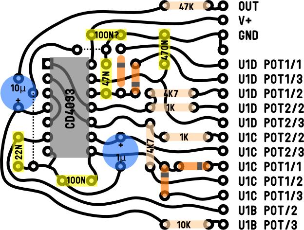

PostPosted: Tue Apr 07, 2015 12:50 pm    Post subject: Reply with quote  Mark this post and the followings unread
(tiny pots needing a destination)
...looked a little prettier without the output cap/potential divider.
Concept - 50mm x 50mm, all components soldered on bottom of board except 5 pots as shown.
It's probably not small enough to fit in an egg, maybe a large goose egg Wink
The pot terminals could fit 0.1" headers for offboard controls.
Back pcb is my layout of Yves Usson's MinMax...

PostPosted: Tue Apr 07, 2015 2:21 pm    Post subject: Reply with quote  Mark this post and the followings unread
banana
that's NANDtastic, and very small. well done!
I did test adding diodes to the input pins, well actually I just hooked up my modular lunetta which already has diodes on the outputs,
and that does work. Not really necessary to add that to the PCB though, you can easily solder some wires to it and add the diodes to
whatever connectors you want to use. you could even use a switch to choose between the direction of the diodes.

PostPosted: Wed Apr 08, 2015 12:10 am    Post subject: Reply with quote  Mark this post and the followings unread
that's NANDtastic
Glad you like it.
On next morning viewing, I'm wondering if it would be better to relocate the out/power pins and stick an attenuator there(centre back); if you made multiple instances of the NANDulator it may be musically useful to have an onboard fade. Maybe a second out for headphone monitoring as you mix the NANDulators.
I'd like to see the interactions on oscilloscope(s) to understand the potential of the diode inputs and also what the NANDulator can do in the timing domain rather than the audio domain. Switches...maybe croc pins or bananas. I take it the diode inputs are digital and not analogue sensitive in any way?
Robert

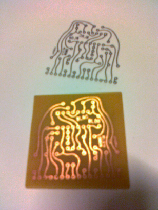

Here is an attempt for a single sided PCB layout for the NANDulator (we might have a go at it with our DIY workshop). Proudly made with my little hands and Inkscape (colours and curves were the same price si i used them!)… It's my first time at it, could someone maybe double check? Also please point any other eventual conceptual mis-design. As one can see i put all outboard connectors on one side, having them sorted by pot, i suppose this is ok? Are the traces too thin (they're .02 in wide)? Maybe just make the ground traces thicker? i also put a capacitor between the power rails, i don't know if it's requested for this very design… Oh well so much noobism.
More generally i would also be very grateful to hear of techniques, do/don'ts etc in this matter of PCB layout design, for instance how to make it more compact and such.
Beware! Not verified yet! Actually possibly completely wrong!
 Filesize:  68.48 KB
 Viewed:  985 Time(s)
::U::N::S::C::H::N::E::L::L::
Posts: 5895
PostPosted: Fri Apr 10, 2015 6:58 pm    Post subject: Reply with quote  Mark this post and the followings unread
It looks good to me and I love the curvy hand drawn design Razz
If you're not going to use an attenuator on the output add a 10K resistor instead. It works as a voltage divider
together with the 47K resistor to bring the level down. Traces should be wide enough for the (low) current
as long as it doesn't cause any problems with etching. You could make them bigger but keep enough clearance
between the traces and solderpads (to prevent shorts when soldering). I didn't draw a power decoupling
cap but it's a good addition for this circuit. As for making it more compact, with all the pot connections
on one side you'll probably won't get it a lot smaller and a very small PCB is harder to solder anyway.

PostPosted: Fri Apr 10, 2015 7:27 pm    Post subject: Reply with quote  Mark this post and the followings unread
Ok thanks for checking! i might well take my chance at etching next sunday.

PostPosted: Tue Apr 14, 2015 5:52 am    Post subject: Reply with quote  Mark this post and the followings unread
Tadaaa!
(so the layout is ok)
I'll be back with some questions later…
