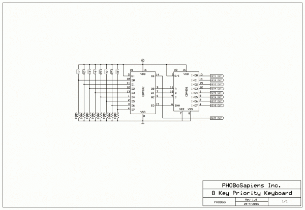

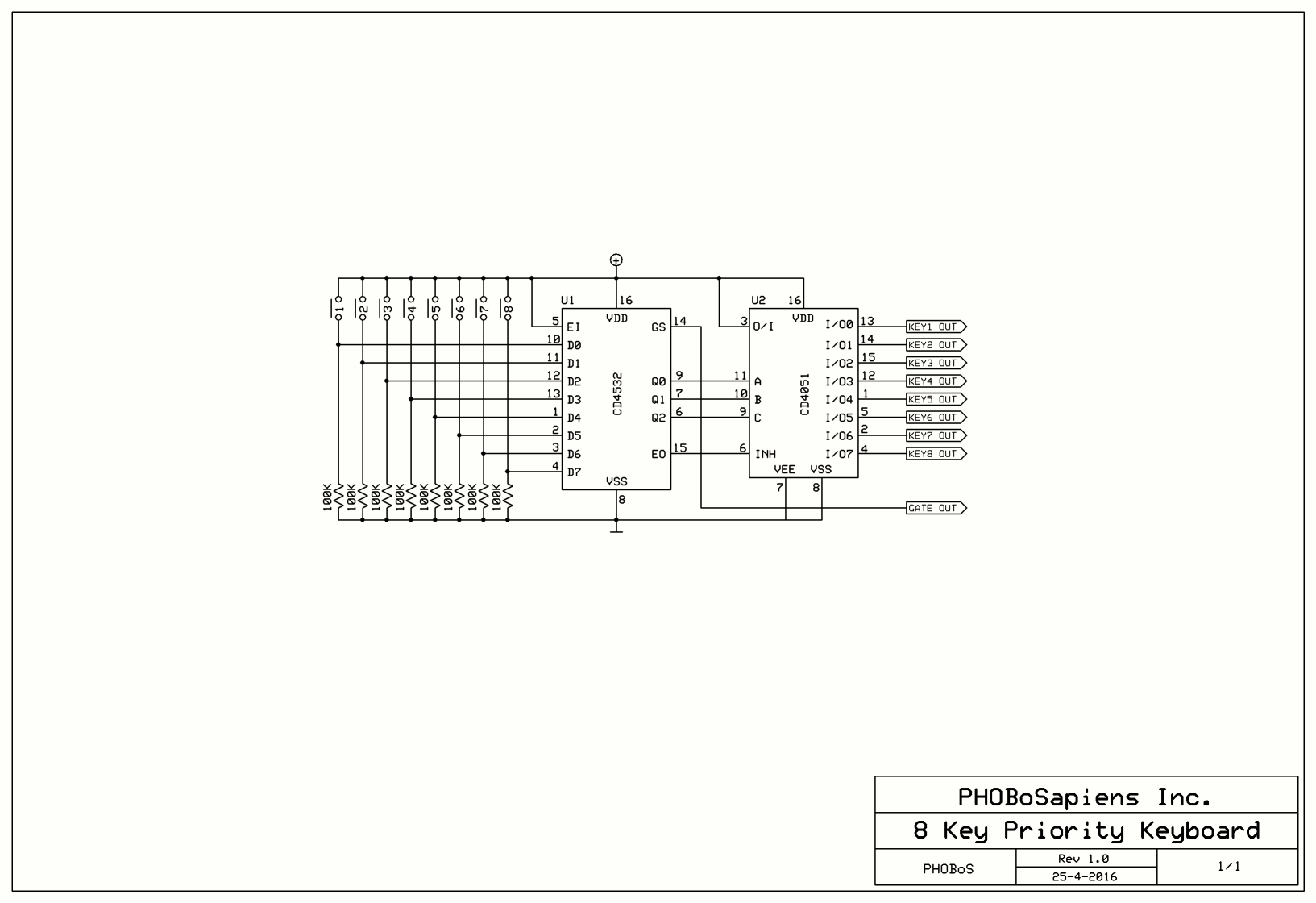

I just drew this up as part of a bigger circuit but it might come in handy for a lunetta controller. It's very basic, just 8 keys with a priority
encoder so if more than one key is pressed only 1 output is high. It also comes with a bonus gate output which is high when any key
is pressed. You could add some pots to the outputs (like a baby 10) to make it into an adjustable CV keyboard.
The datasheet for the CD4532 has an example on how to cascade the chips by adding 4 OR gates in case you need more than 8 keys.

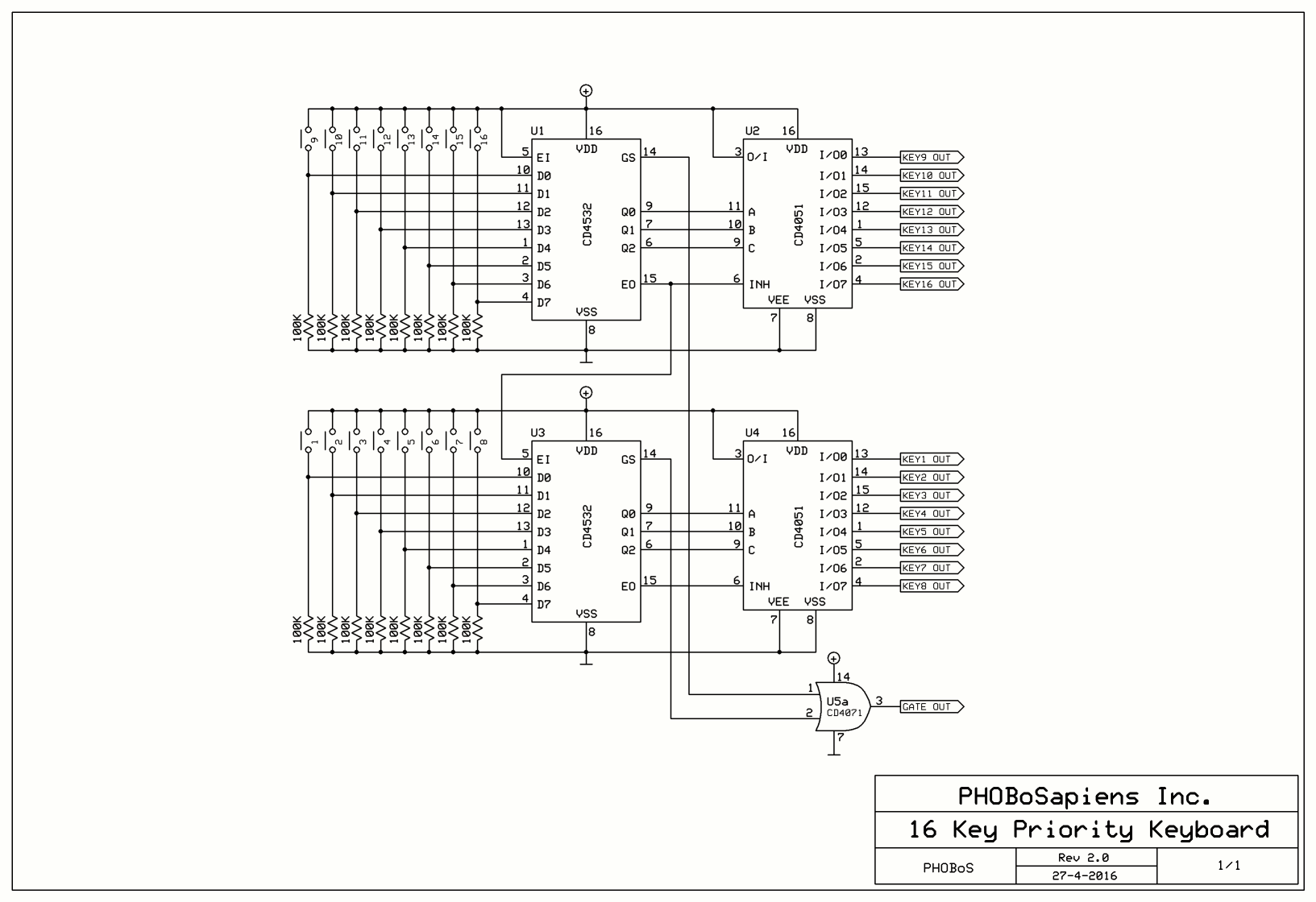

edit: drew up a 16 key version as well.
-- untested --
8 Key Priority Keyboard
16 Key Priority Keyboard
 Filesize:  94.72 KB
 Viewed:  878 Time(s)

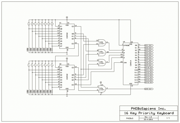

Posts: 5794
PostPosted: Wed Apr 27, 2016 5:15 am    Post subject: Re: Priority Keyboard
Subject description: basic digital keyboard, can be adjusted for CV keyboard
Since it uses a mux you could of course just use pots wired bewteen + and GND with the wipers connected to the keyoutputs
and take the CV out from pin 3.
also I guess the following schematic should work for a 16 (or larger) key version as well:
16 Key Priority Keyboard V2
 Filesize:  89.2 KB
 Viewed:  701 Time(s)

Hi, I've been looking to make a dead simple CV keyboard with keys that are etched like those you see in remotes:
I understand the circuit well, but I am trying to figure out the output section. The 4051 generates 8 signals. Are these summed together to make a CV signal? The schematic for the mofos mini controller just has a singular cv output. What am I missing here?
Posts: 5794
PostPosted: Wed Feb 15, 2017 2:04 pm    Post subject: Reply with quote  Mark this post and the followings unread
In it's current form it doesn't produce a CV signal, it just outputs the status from the keys/switches, but because of the priority encoder
only one output can be high at a time. You could however turn it into a simple CV keyboard by a adding resistor string to what are now
labeled KEY1 OUT to KEY8 OUT and take the CV output from pin 3 of the mux.
You could also replace the switches with some (digital) inputs, hook up a bunch of oscillators and have it play by itself, this is afterall
the lunetta section. Laughing
