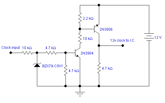

I'm working on a trigger/gate sequencer.

What is weird is that from the start, when the counter was working, it was skipping steps. Counting up it would skip 0 and 8, counting down it would skip 4 and 12.
After adding a transistor buffer on the clock input, I'm no longer skipping 8 when counting up, nor am I skipping anything when I count down. But I am still skipping 0 when counting up.
So other relevant things....
the jam inputs are all grounded, as is carry in.
the load jam inputs ("PE") pin is connected both to a power on reset (cap to +V, resistor to ground) and to a diode coming from the reset input which is transistor buffered and normalled to a reset button. Pressing the reset button gets the expected result of resetting to 0 (and always has).
The schematic is something of a problem, it's actually split over multiple sheets, but the relevant bit with the 4029 is here.
I am simply not grasping why it would skip step 0. There's nothing odd about the clock as far as I can tell, for testing it's on its own power supply all alone...... Hoping someone with more CMOS experience can point to something. Speaking of which, all chips have 100nF bypass caps near their power pins.

By "skipping" you mean the outputs of the 4029, or the outputs of the 4051?
I mean: where did you noticed the skipping?
Because if you say that the skipping occurs at some point at 0,8,4 and 12 it's common nominator is Q4 of the 4029, so my guess is that there is something wrong with it (bad solder, shortcut ...)

A resistor from the base of Q4 to GND might help. I had some problems with skipping
when using a resistor that was too large and you don't have one at all. I wasn't using
the transistors as an emitter follower though, but I think it's worth a try. btw. If you use
them like this it will most likely not work with 5V gate/triggers signals.

Why not use the same resistor values around Q4 as with Q? (that's the Q with the question mark Wink

OK, I took another look and your inputs are seriously flawed. There's absolutely no way this thing can be expected to work reliably.
1. As I mentioned above, you don't want to use emitter-followers for logic. The output of the emitter-follower is going to follow the input voltage but lose one diode drop through the base-emitter junction (about 0.6V). So for a high input at best you get Vin - 0.6V (reset is even worse with the extra diode). The problem is that CMOS logic really wants to be driven by Vdd and Vss for high and low respectively (as close as you can get to this). so a) your clock input needs to be very specific and b) you don't want to be giving up that diode drop.
Edit: Disregard point 2. This analysis is incorrect.
2. The base and emitter resistors of Q? and Q4 (you really should annotate your schematics before posting them for help) are forming voltage dividers in addition to the drop of the emitter follower. With the values shown, you are reducing the input by about 1/10. This is going to kill the circuits ability to operate properly, especially on the clock.
3. Your reset input is floating when there's nothing connected and the button isn't being pressed. Add a pull down before the transistor base.
I would suggest replacing the emitter followers with common emitters like Q5 and Q6. Then you know you are getting the correct voltages to the CMOS inputs regardless of the external input voltages, as long as they cleanly cross the threshold of the transistor.
I also don't see the need for R41, C16 and D3. I'm guessing you're trying to extend the reset pulse? Are you worried that your reset source is going to generate too quick of a pulse?
Edit: I just read your explanation of the reset. Not sure it's going to work reliably, might work well enough. I don't see it as critical so I'm not worried about it, but you should fix the input as explained above.

I notice it on the outputs of the 4029. I can clearly see that Q1 is not outputting a normal evenly-spaced up/down waveform as I would expect for the LSB of a binary counter.
So I had two points in doing this.
1) first, trying to make sure I protect from the possibility of an incoming -12V signal off the jacks, always a possibility with random LFOs being patched in as clocks (though yes, 90% of the time -5V is most likely the lowest).
2) before I added the transistor Q?, I was getting *worse* results. At that point it was just the resistor and diode for -V protection. Edit: on the clock.
Apologies, these are "in progress" and I just bodged that transistor onto the PCB about 4 hours before I posted asking for help, and the transistor into the schematic probably only a few minutes.
That makes sense; I'm curious why it works at all though then....
Assuming I leave the transistor there? Very Happy
Except those are inverting the signal. Not what I want on Q? and Q4. (it has somehow become Q1 since I annotated it, not sure where the original Q1 went Very Happy ) Do I need to use PNPs and a slightly different setup then? I'm less confident in my PNP transistor knowledge than I am with NPNs Smile
The resistor and capacitor are there for power on reset. Diode was intended to isolate that function from the incoming signal, but I see how it's probably entirely redundant. I do understand the cap & resistor are not a perfect solution, but it's a common enough one that I figured it should work, and I haven't noticed it ever coming up in any state but 0 to begin with.
It's preferred to the counter coming up in a random state. If there's a better solution I would certainly be interested in what you would recommend.

I'm not sure I understand how/why the presumed divider is relevant, because I'm using the transistor as a buffer. As I understand it, I'm driving it into saturation (hopefully) and so it should be behaving as if I just threw 12V onto that line, and the 1K is to keep me from shorting my supplies together (note elsewhere I've mostly been using 10K for the same purpose, but again, experimenting with the circuit to see if anything works better, that seemed to be better).

As in my previous clarification question, since my goal is to drive the transistor into saturation (and no, I haven't done the math, sloppy me), as long as I have enough signal to turn on the transistor, would it matter?
I do see where I probably need to drop those other 100K input resistors down though....
PostPosted: Sun Apr 23, 2017 10:08 pm    Post subject: Reply with quote  Mark this post and the followings unread
a 10K pulldown on Q4 and eliminating D3 was insufficient.

As the name suggest with an emitter follower the voltage on the emitter follows the voltage at the base,
so 5V in gives you about 5V out but with a low impedance. I would suggest using comparators (made with
opamps) for the CLK and reset inputs. PNP transistors would still invert, be it the other way aroud, so you'd
need a negative/low voltage on the inputs or an extra transistor.

so either 1) I'm not actually driving the transistor into saturation or 2) I have no goddamn idea what I'm doing with transistors and should go grow cabbages. Possibly both.

It doesn't have anything to do with saturation but the way the transistor is configured in the circuit. this might clear things up a bit.

OK, but you've got the diode on the input to prevent the negative voltages, which is good, but the transistor isn't really relevant to this.
This is a tell tale sign of this type of problem. When you change things that don't actually fix the root cause, you get slightly different behavior that may even seem to improve, but the symptoms don't completely go away. You may even get to a point where it appears to be working fine, then one day you may try to connect a new module, get a new PS or something and suddenly it's not behaving right again. The key word is "reliable".
When you have quick transients, parasitic inductances of the circuit result in some over shoot. My guess is that you're getting enough overshoot for the circuit to operate, but makes it unreliable.
I would (but change the configuration), unless you want to replace it with a comparator (which would still need a pull). What you want is to ensure that you drive either Vdd or Vss to the CMOS input regardless of your input levels. The transistor is a simple way to do this, in the right configuration.
Yes, it will invert which you need to take into consideration. If you really don't want inversion, you can simply cascade a second transistor after the first one to get the original polarity back.
PNP will still invert, it just makes the "on/off" behavior of the transistor relative to V+ (assuming emitter is connected to V+) instead of GND.
The cap and resistor work for active low reset where they keep reset low for a short period after power comes up (I think this is why async resets are usually active low). I've never seen it on an active high signal like you've done. It would rely on power coming up very quickly which may not be the case. I understand the desire to have it power up in the 0 state, I'm just saying that there are worse things that can happen than it not coming up in 0. At least it wouldn't trouble me greatly Wink Have you noticed that it gets random values if you leave the POR circuit out? I'm just curious if it has something built it that would load jam on power up or something.

Hello,
If you'd like to use a simple all-discrete component circuit for the clock interfacing, I'd like to offer the attached one I came up with. It's already been suggested above and personally, I think it's all that's needed Wink
The CMOS inverters that are being considered would still need additional voltage level translation to work with a 5V clock for example.
In my circuit, the over-voltage and polarity protection is taken care of by the zener diode.
Bipolar or unipolar clock inputs from 3V upwards are catered for.
The resistors either limit the current or act as potential dividers to enable clean switching of the transistors, there being one NPN type followed by a PNP type so that the output signal is just a 0 to 12V clock signal in phase with the input.
I should add that I haven't actually built this but it works fine in the simulator.
Regards,
Andy
EDIT : An updated circuit plus an alternative are posted further down.

gdavis
Joined: Feb 27, 2013
Posts: 359
Location: San Diego
PostPosted: Tue Apr 25, 2017 4:32 pm    Post subject: Reply with quote  Mark this post and the followings unread
Thanks for posting that up Andy, looks like a solid solution to me thumb up
Posts: 24537
Audio files: 299
Ah, that looks like design Andy Cool
