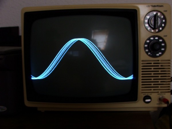

hi
so i've done this to an old B&W tv i found in the attic.
i left the vertical wires in place and connected an input jack to the horizontal wires. This gave me vertical waveforms when i ran audio into it.
so i rotated the coils 90 degrees to get horizontal waveforms.
the advantage of this is, that i can use the Vhold and Vsize trimpots to adjust the display to the respective waveform and somewhat "lock" the waveform to the sceen.
this is how it looks when i hook it up to one of the speaker outs of my home stereo:
old CRT tv as an oscilloscope/visualizer from the shizcake on Vimeo.
however, i would like to make this thingy standalone by adding a built-in amplifier. Because now, i can't turn up the volume on my stereo without altering the amplitude on the screen.
i had this module laying around, but the waves on the screen lose their smooth sexyness when i use it via my stereo's rec out.
pls compare the 2 attached pics
so my question is, what are my options? get anothe hifi amp and use it solely for the TV?
or are there any good low-distortion, low cost, low effort amp kits/modules/plans out there that are recommended for sth like this?
the coil reads around 1,7 ohms btw, not sure how long my stereo wants to deal with that..
regards
ben
104 Hz sine through home stereo

PostPosted: Sat Jun 18, 2011 10:44 am    Post subject: Reply with quote  Mark this post and the followings unread
I suggest going to a pawn shop, or 2nd hand shop, and pick up an old ugly relic stereo amp that nobody wants. Most solid-state amps should be able to kick 1.7 ohms. I would be careful driving your new display TV with a good home hifi.

PostPosted: Sun Jun 19, 2011 9:32 am    Post subject: Reply with quote  Mark this post and the followings unread
yeah, that's what i thought.
missed the flea market this morning because i was hung over, so maybe next week..
i've been thinking a little: would it make sense to put a transformer on the input (1:1 maybe)? would this fix impedance issues for the amplifier?

PostPosted: Wed Jun 22, 2011 1:19 pm    Post subject: Reply with quote  Mark this post and the followings unread
It might, but the only way to know is to experiment.

PostPosted: Wed Jul 13, 2011 1:45 pm    Post subject: Reply with quote  Mark this post and the followings unread
so i finally found an old schneider 6145ea "HIFI" amp at the flea market for 8 bucks. Sounds crappy, but works fine for the tv on the rec out of my regular amp and has 3 more switchable inputs (2 of which are working Smile).
don't care too much if this thing will be fried, so i ditched the transformer idea and hooked the tv straight to a speaker out.
anyway, thank you for your time and have a good one!
