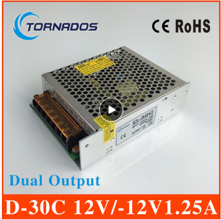

I'll be needing More 12v bipolar power in the near future, anything prebuild that is cheap or kits? Curious what everyone uses.
Posts: 1310
PostPosted: Mon Sep 30, 2019 4:35 am    Post subject: Reply with quote  Mark this post and the followings unread
I use this one, AliExpress, US $17.76
 Filesize:  282.89 KB
 Viewed:  6406 Time(s)
my synth

2 day shipping via grand old amazon.
I'll give this one a try.
https://www.amazon.com/MEAN-WELL-RD-35A-Supply-Output/dp/B00FRBN2CK/ref=sr_1_3?keywords=dual+output+power+supply+rd-35a&qid=1569873531&s=gateway&sr=8-3
Posts: 5792
PostPosted: Mon Sep 30, 2019 1:29 pm    Post subject: Reply with quote  Mark this post and the followings unread
although it says dual supply that is NOT a bipolar supply. It just has 2 voltages: 5V and 12V, and the 5V has the highest current output.
Project_2501
Joined: Jan 31, 2018
Posts: 68
Location: Los Angeles
PostPosted: Mon Sep 30, 2019 1:38 pm    Post subject: Reply with quote  Mark this post and the followings unread
https://www.amazon.com/LEDMO-Switching-Converter-Adapter-Transformer/dp/B01E6S0JS4/ref=mp_s_a_1_12?keywords=dual+power+supply+12v%2F-12v&qid=1569875636&sr=8-12
This is the droid I'm looking for!
Posts: 5792
PostPosted: Mon Sep 30, 2019 1:56 pm    Post subject: Reply with quote  Mark this post and the followings unread
The one you linked seems to be a single supply but you might be able to use 2 of those. I do wonder how bad the ripple is with that current rating
and if it is very stable at low currents.
Note that although the labels say V- that is just your GND connection. Also the photos aren't aways correct, I think the previous one you linked
actually had the wrong photo as I didn't see the 5V output.
third time's a charm ?
edit: the RT-65B seems to be closer to what you're looking for, but for that price you'd be better of with 2 seperate 12V supplies and have more current.
https://www.amazon.com/RT-65B-Switching-Supply-Output-Enclosed/dp/B07VXRMQF4/ref=sr_1_5?keywords=mean+well+RT-65B&qid=1569877261&s=gateway&sr=8-5
