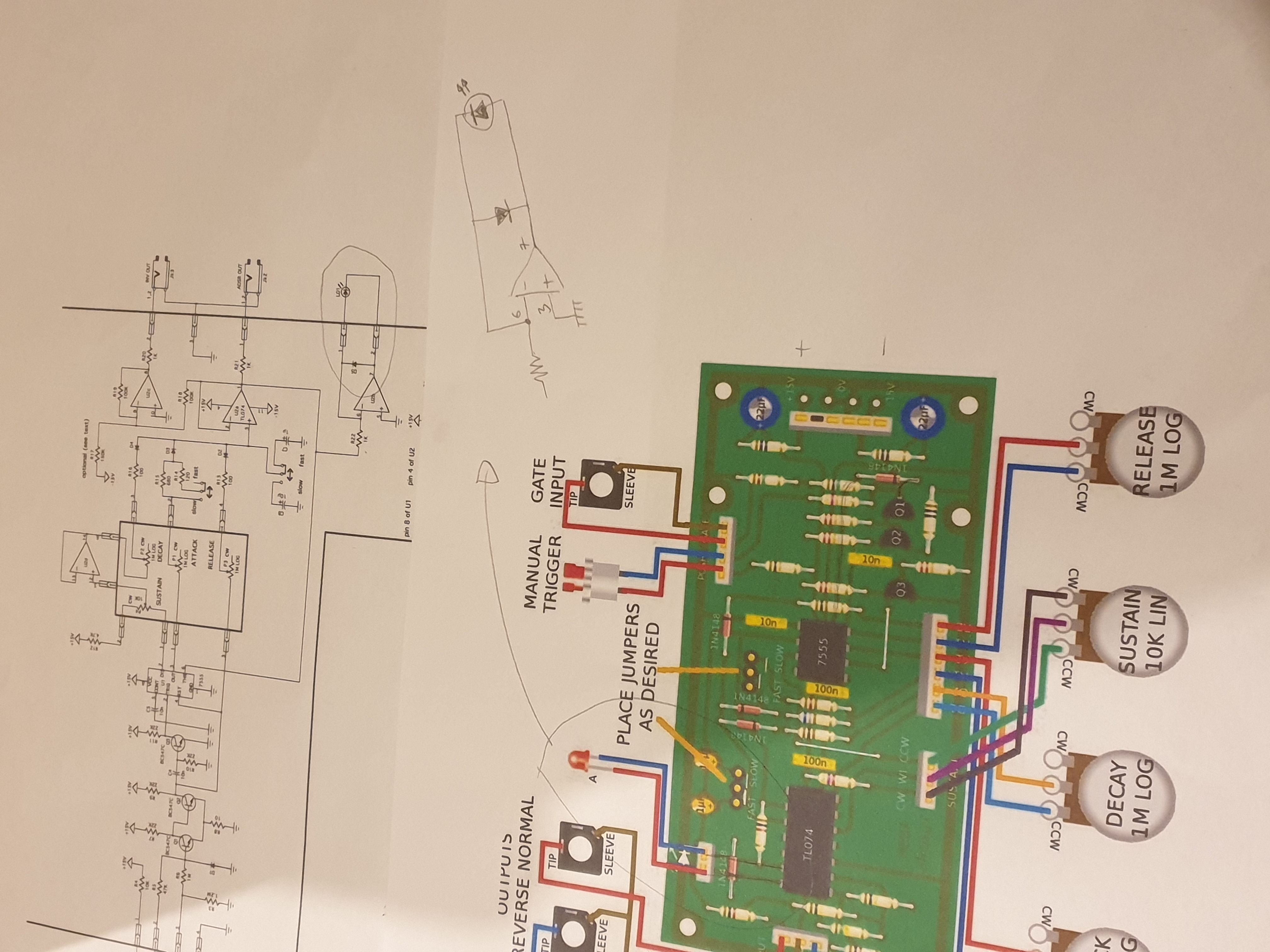

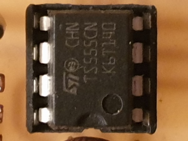

I've just built this today and not really tested properly yet other than plugging it in and checking for smoke, I did find the LED seemed a bit weird and stayed dimmly lit and clicking the button made no difference but I have read various post saying it does do something like that so not too worried but also double checked everything and noticed it says to use 7555 not NE555 ... I don't think mine is a 7555, its just one I grabbed.. I'm guessing I should change that?? What is the difference?? I've never heard of 7555.
Will this not work? Could I have bust it putting the wrong chip in??
Cheers all...
This is what I used...

7555 is one of the more common numbers for a CMOS 555 timer. They are said in at least the datasheet I have to work in any circuit that calls for a 555 timer as a pin for pin drop in replacement.
The 7555 is better for two reasons, it uses less current and doesn't crowbar the power supply like the bipolar part will do. "Crowbar" means to short. The bipolar 555 has TTL output structure which is famous for turning both driver transistors on for an instant during state switching. I read somewhere this is done to speed the switching time, but it also causes a large current pulse from +V through the two transistors to ground. This current pulse affects other things in the circuit. The PAiA Fatman has two 555 timer VCOs in it and the crowbar causes the VCOs to lock together (soft sync) when the oscillators are close in frequency. One of the methods of fixing this is to replace the 555 timers with 7555.
If you're going to find timers, best that you find 7555. Cool BTW, there are also other numbers for CMOS 555, most include the number 7555 within the part number. I've seen ICL7555.

ok so if I've understood properly a 555 could work but may go bang so don't Very Happy
I'll get some 7555s ordered then I think before I try it again.

Do you have a voltmeter? If so, measure the voltage at ADSR out. See what happens if you push the button. It should go up. If the attack pot is at zero it should go up immediately. If it is at 10 it goes up very slowly. Just ignore the LED. You can try this now with your bipolar 555.
crazeydazey
Joined: Feb 15, 2007
Posts: 303
PostPosted: Wed Jan 29, 2020 3:04 pm    Post subject: Reply with quote  Mark this post and the followings unread
I've just given it a test and I reckon it works?? Maybe??
I did what you said with the meter and i get a voltage when you press the button, I get a higher voltage with decay or sustain turned up (as I expected) I get the voltage slowly rising up with attack on, the more attack the slower it goes up (again as expected) and with release the voltage drops slower the more you turn it up (and again as expected Smile )
So that all looks good, and the LED seems to fade in and out fine as I expect it to do BUT... there still seems to be a lot of weirdness with the LED.
Firstly as mentioned before it is always on, just dim. I have checked the schematic and how I laid them out following the layout diagram, and it does look to me like they are wrong on the layout. I have swapped them round and it's not made any difference Sad
And the other odd thing it seems to do is sometimes when I click the button it comes on and just stays bright (like it's stuck on), another few clicks seems to release it again, but its just weird...
Hopefully this is just the light, when I come to try it for real I don't think I care too much what the LED is showing as long as it doesn't seem to get stuck its fine Wink
I've added a picture of the layout and how I think the schematic would look if it matched and the original schematic is in the background showing that D5 and the LED are the wrong way round.

PostPosted: Wed Jan 29, 2020 5:36 pm    Post subject: Reply with quote  Mark this post and the followings unread
Raising R22 a bit might dim it more, but it will be dimmer for all stages.
At rest, the 555 timer can't discharge the capacitor to zero volts, so the ADSR output won't go all the way to zero volts. So the LED would be a little on possibly. And as you say, if it's just the LED is on a little at rest, no big deal as long as the ADSR works as it should with other modules.
Your TS555 is a CMOS part, so it's good to go.

Bugger if i knew that I didn't need to order any Very Happy
Ah well better to have too many than not enough.. you never know I might build another one Wink
Just tried it with my VCO and VCA and it seems to work fine woo hoo, even the LED didn't act strange.. it was still dimly lit but meh I can live with that.
