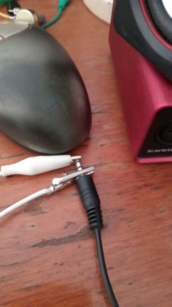

Hi! me again, a noob. I having a problem with the 40106 on thhe protoboard... im using a 5v cell phone charger for supply, im using a 1uf capacitor and a 100k potentiometer to do 1 square wave but most of the trajectory of the pote nothing sound and suddenly in a very short trajectory it goes from a low pitch to a high pitch.
What values should i use to get some LFO, and VCO?? the 9v battery are expensive for me now. Maybe the power supply is bad, i have a guitar pedalboard supply maybe that works better but i dont know

PostPosted: Sat Oct 12, 2024 2:57 pm    Post subject: Reply with quote  Mark this post and the followings unread
great, this is my project XD

On the photo it looks like the first 2 gates have their outputs connected to ground instead of their inputs,. but that could just be a matter of perspective.
does the chip get warm ?
Also it looks like you are taking the output signal from the input of the inverter (the side with the capacitor). This can sometimes work but could also
prevent it from oscillating.
have you tried putting it on a different spot on the breadboard ?
sometimes the connection isn't good enough, taking the chip out and putting it back in could fix it.
