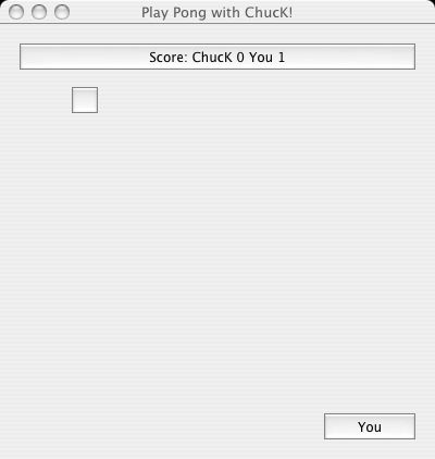

I took the hint from Kassen on the ChucK-Users mailing list, and expanded the program to be a Pong game. Actually it's more like Breakout because the paddle is at the bottom of the window.
If you hit the moving button with the paddle, you get a point when it reaches the top. If you miss the moving button, the ball travels off the window and ChucK gets a point.
It still has the ghostly sound that is a function of ball position, plus I added a click for each bounce and a whoop-whoop-whoop when ChucK scores.
Ah, Pong, what a trip down memory lane!
MAUI Pong screenshot, how cool is that?
 Filesize:  16.82 KB
 Viewed:  3971 Time(s)
