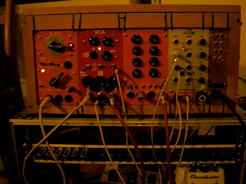

Hello!
On this picture i marked the point Varice was talking about.
Any more experience on this, from you guys already using it?
If i understand right, this point does deliver 8 volts centered around zero?
I'll have to measure...
i use Output 3 as well since a long time to chain some external modules,
diy filters and such, moved by the G2 thru a paia midiCV. It doesn't deliver totally snappy envelopes, but it's still musically useable. Actually i like it a lot.
My problem was, that i needed to boost the output of the G2 externally by a few volts to get nice filter responses,
otherwise its very rude on high resonance settings, as obviously it doesn't have any juice.
i believe the G2 Outputs are around maximum 1 volts or less. This mod would solve that, more eleganty and without a loss of quality.
Please share some experience on this will you?
thanks!

This picture is of the box i'm taking to gig's nowdays, it has a pair of Lfo's,
a Vca with a 3 input mixer, a pair of sallen-key filters that evolved from the René Schmitz adaptation of the MS20 filters, the VCS, a voltage controllable glide, some multiples and random voltages and some secret electonics you have to open the lid up to access. I built 3 times as much modules so i keep changing them, really depends on what i want to do, it's never finnished, but this box now is giggable, it's not heavy at all, as wide a rack standard, and the engine usually resides on top of it, sort of driving it. Well what are engines for? Very Happy
What i'm working on now, is a desk-top sort of unit that will incorporate the engine, a midi-cv, a pair of 4x4 matrix mixers for the G2's inputs and outputs, and at least 4 vca's if not 8 to move things, and some whatever, probably an oscillator moved by the G2 thru midi, and a pair of filters.
I might not even need an oscillator if the 8volt outputs work out, ill just use Tim's draw-osc than. I'm in love with that. Smile And Bank Select, yes.
Im still tring to build smaller than i can build, just crossing over to use SMT. As it should not be bigger than let's say a NM1 rack, im a working "man", i need backpack it often. Smile Made lots of plan's and drawings, what's really hard for me is to decide what makes sense to do inside the G2 and what's better outside, but shurely theres a few analog circuit's i love to use and don't have a way to emulate the sound of those, tho it's odd that i'm a lot closer to the sound i'm looking for now inside the Nord aswell. But i a NO laptop on stage.

Hey, I like all the DIY modules! Great work on that stuff. An excellent way to get your own unique sound (and "look"). Good luck with the SMT parts. Too small for me!
Thanks! i'm still at an early stage, things hardly boxed.
SMT is too small for me too, but i need so many things in such a small place, that it's the only option. If i come up with something very good, i can still send it to a factory with industrial soldering robots. Or diy one of those. Iron-man syndrome. Smile
