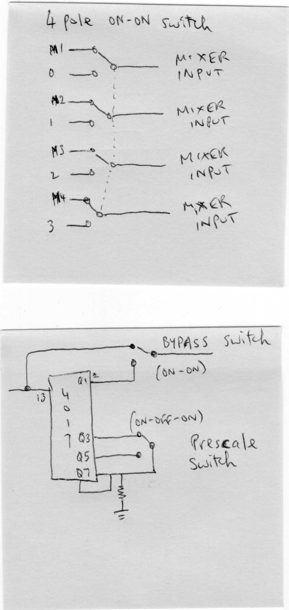

I have been staring for quite some time now at the CGS01 documentation, but I can not figure out how to wire the conservative version, i.e. the one with the SPDT switch.
How do I connect the SPDT switches? Is there a short diagram on the matter?

here's some scratches i made over brekky, some details missing (like the diodes on the 4017 outputs), but the connections should be clear enough.
The 0,1,2,3 inputs of the 4 pole switch can be channel 'a' or 'b', Ken wrote in the module description there are no rigid rules. I think I connected 'b' to the switch on mine.
Someone please jump in if i made a mistake!
EDIT - aaah a mistake!! the centre pins of the 4 pole switch go to the pots, then connect the pots to the mixer inputs.

Wow! Thanks for the quick response!
Looking at the diagram, it looks clear and strait-forward.
I'll give it a go this week Smile
