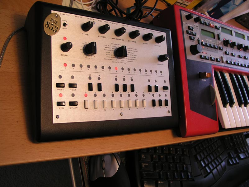

Yay!!!!! and here is my new x0xb0x #853 alive and well after 18 hours of assembly work with Andrew Martens. Acid and squeltchy ....
Tuning is still a bit off, I can't get MIDI in to work (but midi out works and plays and slaves my g2), and we have not put in the mods yet (res mod, vco-out/vcf-in).
Demos of the combination of x0x and g2 at this point is attached to this email. it is a simple fx patch with a kick drum and the x0x is going into the g2, and can be crossfaded between dry and od (and it is running through OD module and shaper and then some eq for color) and a delay (well, of course).
when the mods are done. i intend to use x0xb0x (vco out and cvf in mod) in the following way -- the x0x vco itself to use for pitch tracking control in the g2 which will, ahem add a few more oscs and other things before going into the vcf, and then back in the g2 for more flourish) ...
i suppose this is a good way to use a g2 with analog synths as the pitch of the analog synth may be slightly drifting and this should be picked up by the g2 pitch tracker of course ... hmmm ...
more to come... Smile Smile Smile Smile
/Dasz
ps.: Still grinning ....

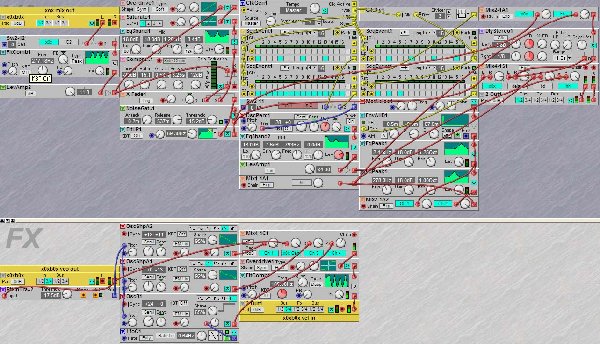

I've got more stuff in the g2 now and the x0x is finally slaving to my g2 (it was pretty easy to figure out). even without the mods, DAMN!
G2 overdrive ideas -- The G2 od (with eq's) and shapers and comb filters are fed by my xoxboy (the name for x0xb0x #853) for total techno insanity ... it just can't sound bad .... DAMN!
griiiiiiiiinnnnnnnn ....
so, uhm, to keep this discussion on topic, i have not been able to get my effects to sound so smooth as when they are driven with the xoxboy (when I run the audio sources internally)
/Dasz

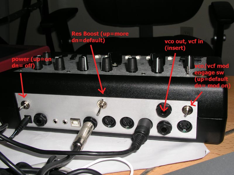

aaand last night the x0x was modded and now has boosted resonance, a power switch, and vco out vcf in mod (with a switch to engage or disengage the curcuit for on-the-fly switching between the internal osc and external input for live situations)
audio demos of this combination with the g2 integrated between the osc and the filter, will follow

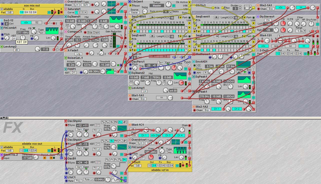

I just finished connectecting the vcf out and vco in cables and created a test patch. The layout is as follows
x0x-vco-out
-> G2 in4 (with pitch tracking, and more oscs, and a few more fx) then out4
-> x0x-vcf-in-vca-mix-out
-> G2 in1
I turn the effect on and off and I add and remove oscs and fx on the oscs before the filter in this recording.
I think this little monster adds a lot of warmth to the g2 sound. I have a lot to learn, but I think in time and with more work, it can sounds like a hell of a decent 1+ (as many as you need) osc 18db synth Smile, with a filter than can be shaped within a G2 to add more character) Smile
and it does have a MIDI play mode which means it can be played by a g2 synth and it's modules)Smile
The resonance boost is very nice and sharp (and turned on in the mp3 when you hear the percussive sound with heavy Q)
Joy! The x0x is a great deal if you can score one for your G2 ...
