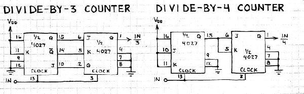

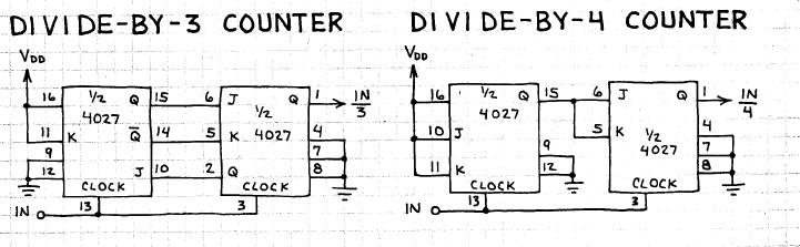

PostPosted: Sun Sep 28, 2008 3:58 am    Post subject: Reply with quote  Mark this post and the followings unread
Good old Forrest Mims comes to the rescue.
 Filesize:  34.74 KB
 Viewed:  514 Time(s)
Stay Cool
Mikael

Does anyone know if the above 4027 divide by 3 circuit produces a 50% duty cycle output?
Also, in the divide by 3 counter diagram, there is an error. Pin 2 is shown as Q, but it should be Q-bar since it is an inverted output.
I haven't really checked it out, but I would propose that it would be impossible to divide by 3 using flip-flops and get a 50% duty cycle.
It will divide by 3 by counting to 3, so you could get 33% or 66% only.

PostPosted: Thu Oct 30, 2008 2:22 pm    Post subject: Reply with quote  Mark this post and the followings unread
Now that you say that, it is impossible because the clocks to both flipflops are the same so the circuit cannot react except on one edge. I designed a 50% duty cycle divide by 3, but I manipulate the clock to one flop with logic to make that happen. My circuit uses 2 JK flops and an NOR gate.
