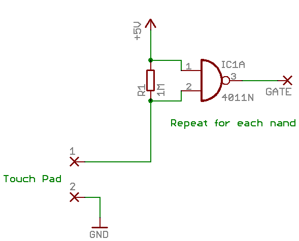

I though it would be good to start a thread about touch points and other such human interface devices.
I found this in a circuit cookbook though it would be interesting - but how would you convert it to a trigger? this would be much more useful
you can get 4 out of one IC

You can use a 40106 gate to change pulse widths (ie make a trigger) - have a look at the osc schem I posted --- feed a regular sqr through a low value cap and then into a 40106 gate, plus a 22k resistor tied to ground or V+.
Hmm, thinking on that, you'd probably be able to do that with one of the NAND gates too -- just tie the two inputs together... Hmmmmmmm!
