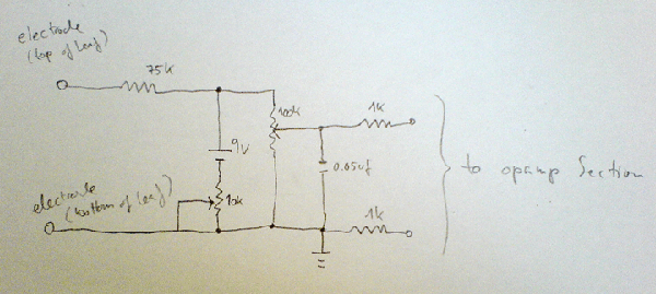

I am building a plant synthesizer. Not to synthesize plants of course, but to synthesize sound from the bioelectrical signals in plants. In order to register the minute changes in resistance (to measure voltage and eventually generate CV) I am using a wheatstones bridge circuit to which the electrodes connect. The bridge is then connected to an opamp section.
My question is, to avoid loading of the bridge and cause inaccurate readings, will I need to place a buffer before the bridge and after the electrodes, or should I buffer the output after the bridge and before the opamp section? Or should I consider a completely different approach?
I included my somewhat rough schematic of the wheatstone bridge I plan to use. The 10K pot is for controlling the power supplied to the bridge and the 100K is to null a meter on the opamp section (which I didn't draw yet). I am sorry if my post is too confusing or lacking information to answer it properly.

I'm not sure ... just some thoughts ...
A Wheatstone bridge setup measures resistance in a very sensitive way, and as such it would not make sense to put a buffer before it (erm .. I don't see it, I mean Wink ).
But I'm wondering if measuring resistance is the thing to do, or that maybe some activation potential would be more interesting ... in the latter case it would make sense to not have a bridge but go into a instrumentation amplifier directly (an opamp with good common mode rejection).
Oh yes of course. Dang! My mind must have flicked or something. Thanks.
I did amplify the action potential in plants some years ago and that was exactly the way I did it Smile

Shocked Ummm ... that's not a Wheatstone bridge.
The lower 1k resistor should be connected to "top of leaf", rather than ground.
But to answer your question, the usual approach would be to feed the differential signal into an instrumentation amp. You can buy these as an IC, or make one out of three opamps.
Ian
Thanks Ian! Hmm... I see what you mean about the bridge. Good thing I posted here first. I have a bunch of quad opamps so I'll just make an instrumentation amp from those.

I will keep you posted. I'm thinking about this simple design and use a quad opamp. I may need some filtering of the signal as well to avoid the plant acting as an antenna, picking up to much of the mains hum.
-Kasper

EDIT: The differential amp at Vin2, Vout2 will be used to amplify the action potential - stem (Vin2), soil (gnd). V1 and V2 is for electrodes placed on top and bottom of a leaf.
EDIT 2: There's a typo in the equation for the notch filter. It should say: F=1/(2*pi*R*C)
