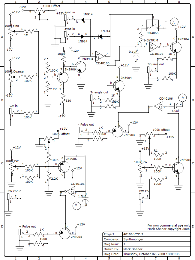

In this audio clip I sweep the rate pot from CCW to CW and back again on each of 5 outputs that I liked best.
No shift registers are used in the schematic. Just one of each 40106, 4520, 4030, and 4066.

PostPosted: Sat Jan 17, 2009 7:39 pm    Post subject: Reply with quote  Mark this post and the followings unread
sounds awesome!
are there schematics to peep? i'd love to see them!

PostPosted: Sun Jan 18, 2009 9:18 am    Post subject: Reply with quote  Mark this post and the followings unread
Sounds good! Did you use the 40106 as the basis of the noise generator?

PostPosted: Sun Jan 18, 2009 1:35 pm    Post subject: Reply with quote  Mark this post and the followings unread
Sorta. I use my 40106 vco with the switches controlling four 40106 oscillators simultaneously that are xor'd and then sent through half of a 4520 whose outputs are mixed together and sent to the clock input on the other have of the 4520.
One thing I found great with frequency dividers is it's inability to handle chords for guitars and whatever. I figured if you sent it multiple oscillators tuned differently that all share the same frequency sweep you could make a neato noise source, which is what I think I accomplished.
Only part of the attachment was used. More to come later...still a bit hungerover
