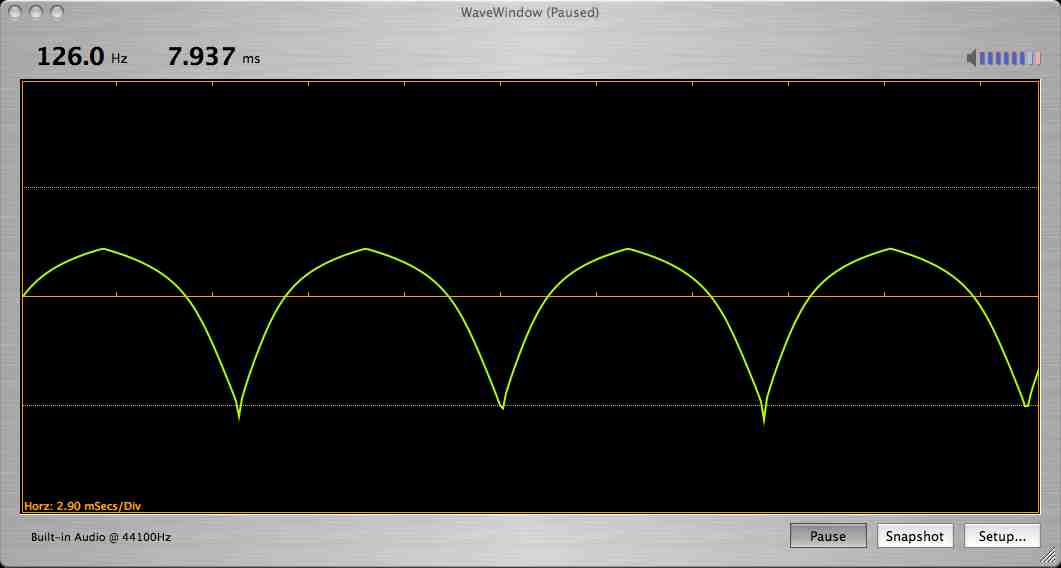

Minimalist
Joined: Nov 21, 2008
Posts: 9
Location: NZ
PostPosted: Thu May 28, 2009 6:37 am    Post subject: LFO sine waveform like a triangle wave Reply with quote  Mark this post and the followings unread
Hi Yves
Thanks for your generous sharing, I've built one of your LFO version 2, it all works well except the sine waveform isn't right. It is adjustable but is comming out like a pure triangle wave with no rounding, all the other waveforms seem right.
Any suggestions where to look?
thanks Marcus

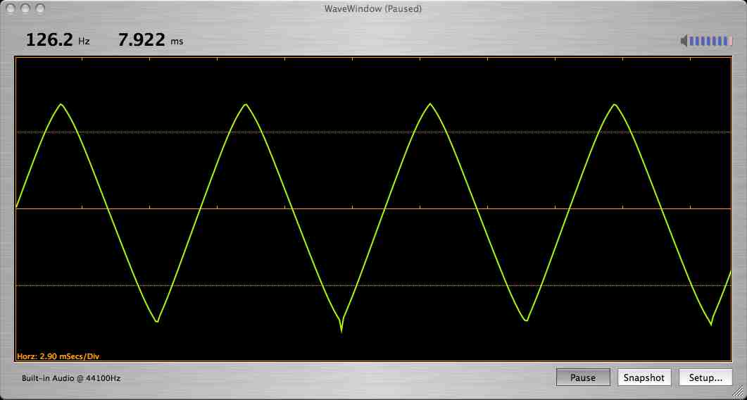

Minimalist
Posts: 9
Location: NZ
PostPosted: Thu May 28, 2009 12:09 pm    Post subject: LFO Sine wave shape problem Reply with quote  Mark this post and the followings unread
thanks Thalassa, yes I've tried varying the sine wave shape trimmer I'm getting the following variations , ie the top or bottom half of a sine wave but not the whole wave, any suggestions? I'm getting perfect triangle and saw waves.
Thanks Again

yusynth
Joined: Nov 24, 2005
Posts: 1314
PostPosted: Fri May 29, 2009 5:20 am    Post subject: Reply with quote  Mark this post and the followings unread
Hi seeing the oscillogram it is clear that the triangle wave has not the right amplitude. Check that the level of the triangle output is at 8Vpp (-4V/+4V).
If so then check thoroughly the value of the following components :
R26=150K, R27=22K
If the amplitude of the triangle is <<8Vpp then check R23=200K1%,
Yves
Minimalist
Posts: 9
Location: NZ
PostPosted: Wed Jun 03, 2009 12:40 am    Post subject: Reply with quote  Mark this post and the followings unread
Thanks Yves
wow you really know your stuff, the triangle was <<8Vpp so I checked all the recommended resistors, they were all correct so I just increased R23 to 300K which brought up the triangle to just over 8vpp which meant the sine wave now is good, thanks again for your patience with beginners questions.
Marcus
yusynth
Posts: 1314
PostPosted: Wed Jun 03, 2009 1:23 am    Post subject: Reply with quote  Mark this post and the followings unread
Minimalist wrote:
Thanks Yves
Marcus
Great, however if the triangle was <<8pp then this mean that something was wrong with the sawtooth which must be at least 8Vpp. In the LFO, the core is a sawtooth wave anad all the other waveshapes are derived from it. This means that if the sawtooth has not the right amplitude then all the values of the wave-shaper resistors has to be adjusted.
Just as a matter of being sure and understand why you had to increase R23 to 300K can you check the values of R9,R1,R19,R20 and R21. ? Wink
