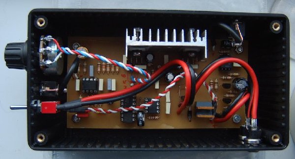

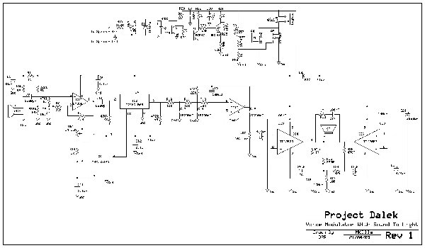

Slightly off topic heres a schematic of a design I modified and amalgamated. Basically the original circuit was a stand alone voice modulator. Thats the lower right section of the circuit. The amplifier on the original was a simple LM386. I simply spliced and replaced it with a single TDA2003 based circuit. This is the new version with a bridged amp for greater watts. The upper circuit is a sound to light unit which is based on the velleman MK114 kit but with the extraneous bits removed. I etched my own PCB for it, only took 2 attempts to iron on the toner pattern Smile It's used for Dalek voices Very Happy which is my other interest. Full size DIY prop!
This is by way of a show and tell I guess. This is what I can do with known quantities. As I hinted before 'free thinking' electronics is not natural to me. I have a basic understanding can put things together from 'plans' but little else. Though I have been adding caps to my WSG in parallel to the existing ones Wink I get that........and if I added resistors in parallel to the existing I know it would change the sounds again or if I just swapped them out for other values. But thats about it.

Looks like nice work, fenris. Thanks for the 'show and tell' Smile
