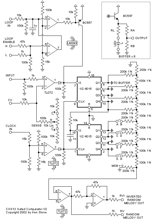

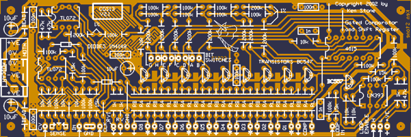

Now I've finally completed some CGS modules successfully I thought I'd move on to something a bit more complex. I've been wanting to build the Gated Comparator (CGS13) but I have a question. I looked at the schematics and read the description but I am probably being dense.
Here's my question, what is the value of RB, RA, and RL in the "buffer" section? For the life of me I really can't figure this out. I see the section on the schematics but don't see where the values correspond to this section on the PCB. As usual, Thanks for your time..

the RA and RB are two arbitrary resistor values, as is RL Smile
Across the base of the pcb you'll see these in a repeating pattern; the RL denotes the "Resistor for the LED", if you follow me?
Same approach is also on the Master Divier etc. Pretty simple, that way you read: "RL should be 100k" or similar, and then you know all RLs are that value.

for the Master Divider, Ken wrote -
Suggested values for the resistors are as follows:
RA = 1k8
RB = 1k
RL = 2k2
These will do for the Gated Comp too.
Except if you are using ultrabright LEDs, in this case use 5k - 10k for RL

Awesome. Thanks a lot for the replies. I understand now but I'm glad I asked. Can I ask a follow up question?
On the board, there's several jumper areas correct? I'm supposed to just solder a connection between these two points (which is connected by a line), correct? Two of the areas I'm looking at is to the left of the words "Copyright" and "Ken" on the top right side of the pcb (pictured above).

yep you got it - just solder a piece of wire between these points. I just using leftover clippings from resistors
looks like ~5 jumpers are needed on this PCB

Correct me if I'm wrong - but isn't there a wire missing on the schematics for the V2?
The top buffer should be connected to the diode and leg 7 of the 4015? As it's the COMP output marked on the circuit board (just as on the V1?).

yep it looks like the comp out buffer is not drawn on V2, but is indeed on the PCB.
maybe its like an easter egg? Smile
