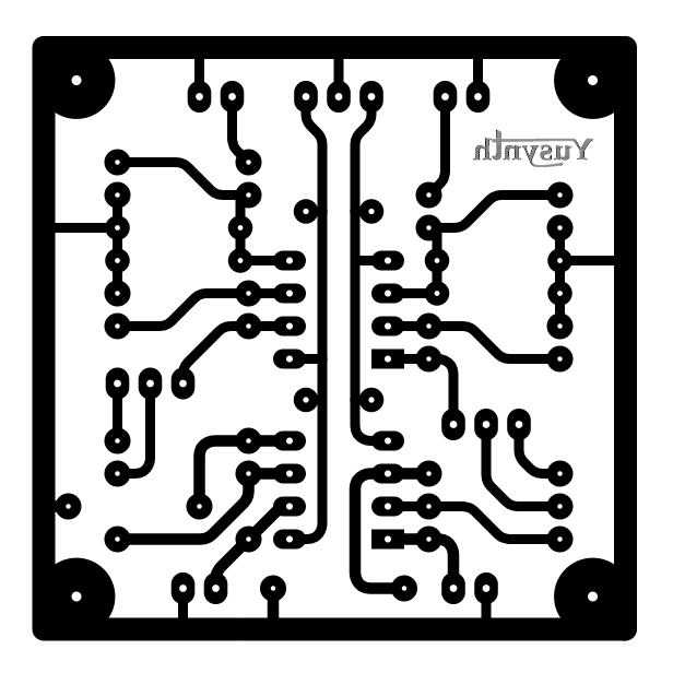

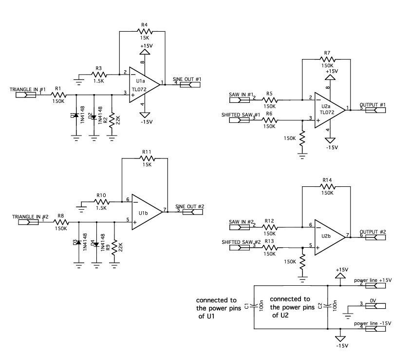

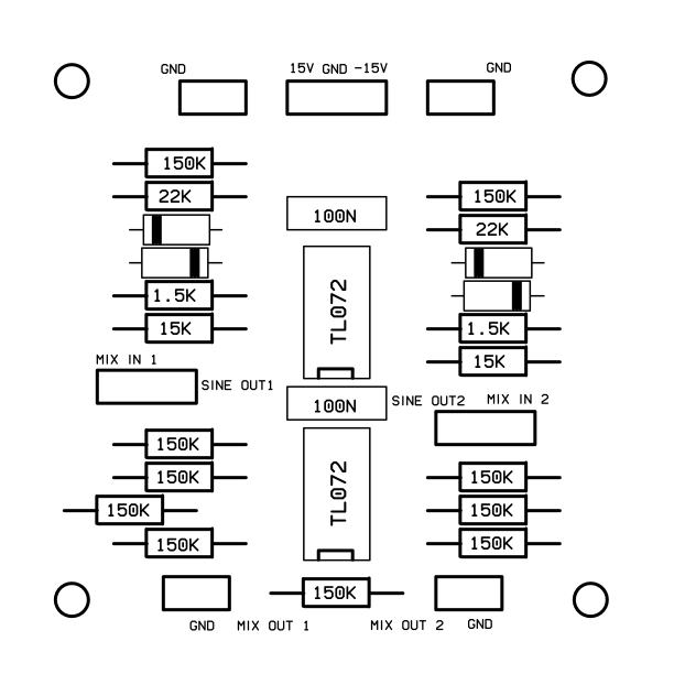

Hello Yves, I'm building the saw animator and I found several discrepancies between pcb layout and schematic and also with the part list
On the pcb layout there there are two 4,7K resistors that in the schematic are 1k ,also on the part list these resistors are designed as R8 and R19 but in the schematic this R8 is 100k 1% and R19 120k and also R8 is listed on the part list as 4,7K and 100K
The 1k resistors ( supposely 4,7) are listed on teh schematic as R5 and R20 that are missed on the part list.
On the part list also R9 is listed two times, as 100k ( the correct value acording with the schematic ) and other as 120K where should be R19 instead R9. The same thing with R11. The 120K resistors are R4 and R19
Also on the part list should be eight 47k resistors not six, R3 and R18 are missing on the pat list.
The only important problem is the first one ( the 4,7k resistors ) , should be 4,7k or 1k as in the schematic?
You are making a great job Yves, please don't think that with this message I'm saying the opposite Very Happy
http://www.corsynth.com
yusynth
Joined: Nov 24, 2005
Posts: 1314
PostPosted: Mon Jun 01, 2009 11:16 pm    Post subject: Reply with quote  Mark this post and the followings unread
Hi Thalassa
No problem, it is OK to let me know when such discrepancies exists, as a matter of fact it helps me improving the information on my site.
R5 and R20 are definitely 4.7K although 1K would also work fine here (this value is not critical).
I will correct the errors in the BOM and schematic ASAP.
By the way, I found (and some other people did as well) that the internal modulation with a TRIANGLE shape was giving a result a bit too harsh, furthermore the fact of using an external mixer could be a poblem. Therefore I designed a small add-on board for this module that solves all these issues by providing two TRIANGLE to SINEWAVE converters and two MIXERs to improve the SAWANIMATOR.
It is not yet available on my site but here are the PCB layouts and schematic. The wiring diagram will come soon but it consists mainly in inserting the wave converter between the LFO out of the SAW-ANIMATOR and the MODULATION IN; and the MIXER is connected using the SAW IN and SAWANIM output to the mixer inputs and the mixer output to the output jack. A switch may be use to toggle from the unmixed to the mixed version.
300 dpi image, it should scale correctly when printed though it looks big on the screen
