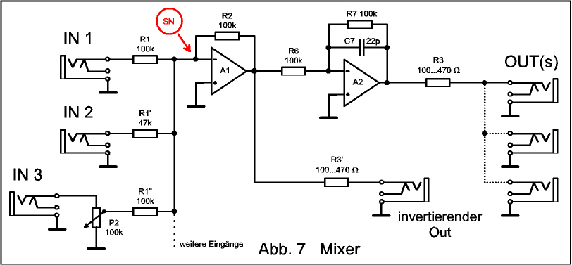

hi,
i like to use the unused IC2 d:
I make two triangle inputs with attenuator and just omitted the 10NF and the second 100K on the Square input, ( the whole PWM is not on the frontpanel )
those go to a first mixer stage ( IC2a) giving a inverted output, then to the CA3080.
I now like to go from after IC2a to the unused IC2d to invert again.
Question should i go after the 100K and make another Mixer stage with feedback resistor,
or should i go bevore the 100K and then making just a common inverter without Feedbackresistor ?
Does it makes a difference ? (exept that i could adjust gainsettings when building with the resistors )

See the CGS29 Schematics ( edit: well i think i answered it myself )
In the middle left is IC2a.
One way i thought is going out after the 100K ( between the 2 OP amps), and to double the schematic of IC2a ( plus additional 22pF parallel to the Feedbackresistor ).
I call this "mixerstage". I think you call this inverting amplifier.
look on the top right the unused IC2d which i like to use. This is mostly allready a simple inverter.
The second option is to use this, going in on in+ but then without using the 100K after IC2a.
so the options are inverting amplifier vs. simple inverter.
hmm, i think i make a second inverting amplifier,
thank you

Funky40 wrote:
...the unused IC2d which i like to use. This is mostly allready a simple inverter.
hi Funky,
no, it is a voltage follower (non inverting, unity gain) with the input set to ground (pin12).
Get the signal from pin 1 of IC2a (before the 100k - this is - in combination with 220R - a voltage devider used to push down the signal for the 3080).
Then use the same config like IC2a - feedback resistor 100k and a 100k for the input signal to go into pin 13 (-), leave pin 12 at ground.
But - to be honest - I really don't see a reason why to invert the signal.
The multipliers output signal is such different to the input signal, so phase problems are not to expect.

PostPosted: Fri Jun 19, 2009 2:36 pm    Post subject: Reply with quote  Mark this post and the followings unread
Serenadi wrote:
It would be nice if you could make a little drawing of what you did.
To get more into it. Laughing
finally i did this, see attachment.
the attachmnet is the drawing i got from you.
so i dublicated the circuitry of IC2a on IC2d. ( similar to A1 and A2 )
I went out after the 100K
ahhhh........................i made the connection bevore the 100K............
so i have a second "mixerstage" with 100K in the feedbackpath but without having the 100K in front of it.
Seems to give radical gain Laughing
ok, after the 100K i have a kind of a bypass, depending on the offset settings, respectivly can i use the offset CV input as a third mixerinput.
The idea was to have a mixerfunctionality in bypass mode
ok, only the Grinder is completly not working. must see

PostPosted: Fri Jun 19, 2009 11:08 pm    Post subject: Reply with quote  Mark this post and the followings unread
I remember vaguely. Laughing
Ok, forget my thoughts on comparators and pwm. Seems its not what you did.
Funky40 wrote:
... without having the 100K in front of it.
Yes.
While gain is given by *feedback res. divided by input res.* and your input resistor is 0 Ohm, you created max gain which results in hard clipping.
With the offset pot you add a dc shift to the input signal. This causes a shift of the clipping point on the timeline and therefore a changing in pulsewidth.
