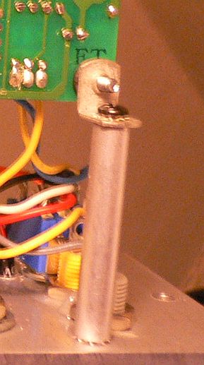

Hello All,
I've gone around town looking for tiny "L" shaped brackets to secure my PCBs to their panels but I haven't had any luck. The problem is compounded by the fact that I'm not really sure what they're called and when I search "L shaped brackets" with Mouser and other such companies I don't get any results (or too many results).
What I want is the tiny screws and "L" bracket that you get from kits like Paia and see on many modules.I feel a tad dumb asking this question but it's something I've been searching for. Any point in the right direction would be tremendously helpful. I've been bending tiny pieces of metal and drilling a hole in it to brace my PCBs and it's a hassle.
Thanks for your time. Sorry it's such a mundane noob question..

I think maybe it's these little Ls that Valis is looking for. Me too.

Mouser part# 534-612 (one hole threaded) or 534-621 (both threaded, 4/40).

You could/ can also use Mecanno angle brackets Idea
