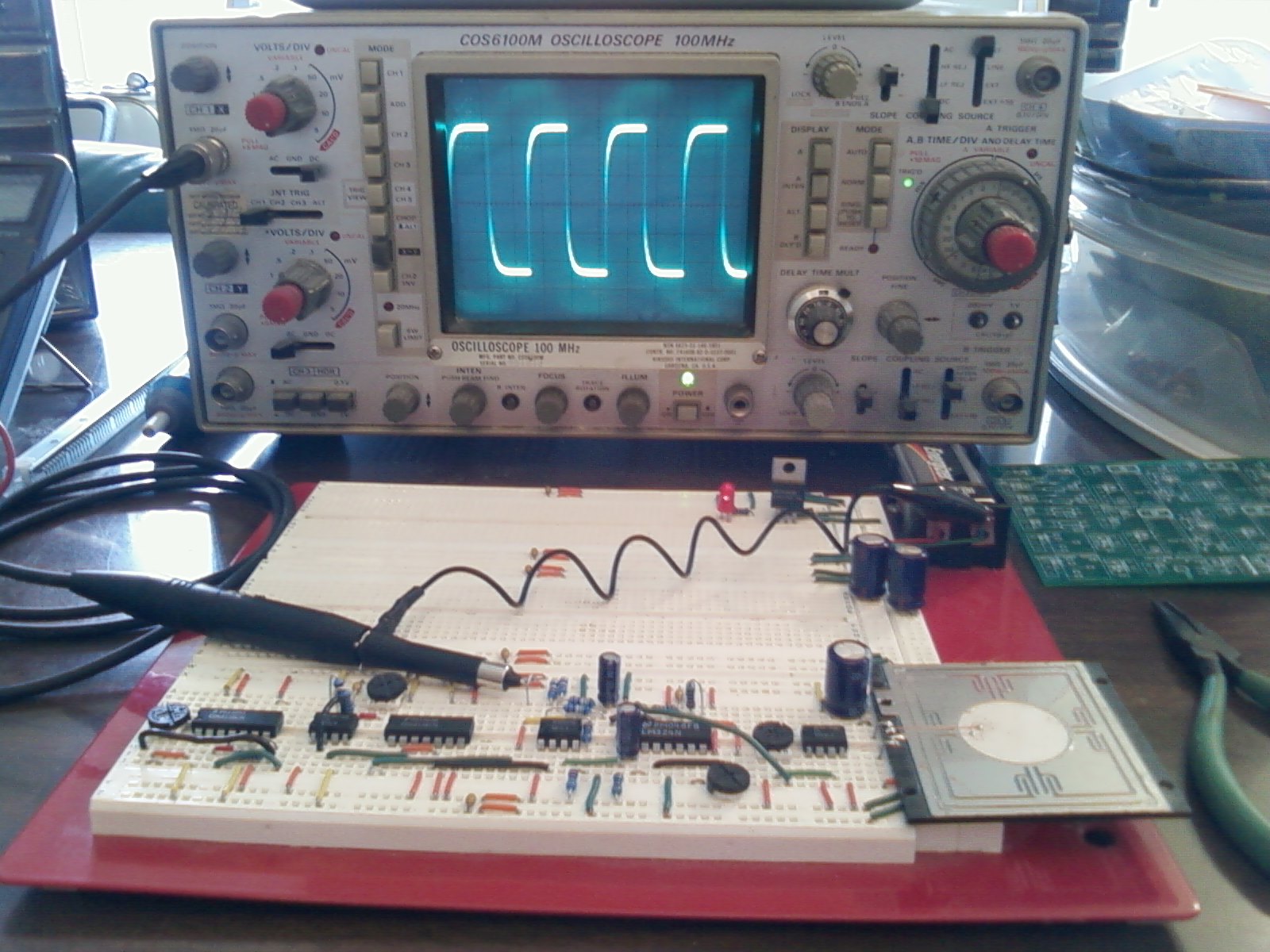

I made some progress today on the BSG's Karplus-Strong Circuit. It doesn't work yet but most of the subcircuits do work properly. I think I just need to get the biasing and lop gain correct. Below is a photo of the test circuit.

The main problem at this time is that I totally ignored the bias and gain setup of the feedback loop and that part needs to be redesigned. More updates later and good luck with your choice of implementation.

I played around some more with the BSG ChucK simulator this morning. I adjusted the loop filter cutoff frequency and the delay line duration within the limits of the hardware design. It was fun to discover percussion sounds coming from that Karplus-Strong thing, plus it made some spacey sounding twangy noises at times. It's nice to have something in software that at least attempts to model the circuit.
Les

Ah, so it works then! Cool! From what I've read, the spacey sounds occur when the frequency is too low (ie. below 40Hz), and percussion sounds when the gain is too low. But of course, there are lots of other factors influencing the output. Now I'm even more excited about getting this up and running myself!

Are those chopsticks in that pic, top right?

I believe that is a light brown protoboard laying flat and seen from the edge. Jan noticed the overdue calibration sticker in the chatroom. What is this, an inspection of my lab? Very Happy

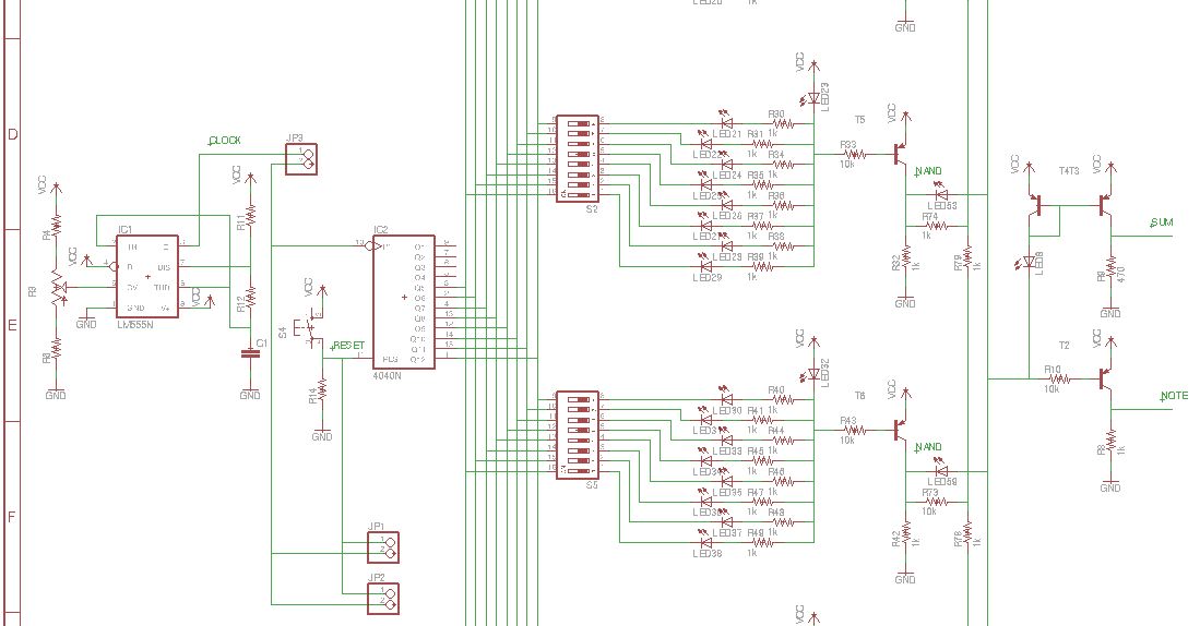

I've realized some things about the circuit that i need to correct, notes as follows.
1. The speaker is a high impedance speaker, so it doesn't make sense to drive it with an LM386. I'll just drive it with an opamp.
2. The counter will be a CD4040, not a CD4017. What is needed here is a binary counter not a decoded counter.
3. Lots of little details that I keep darting between in my thoughts, making notes of them. As I understand it all more I'll report.
Les

Here is the product of my efforts recently after some much needed sleep. The image below shows the 555 oscillator that sets the tempo, the 4040 counter, the LEDIL logic, and the outputs of SUM, R2R, and NOTE.
The clock and reset are bussed so that multiple cards can be synchronized to create separate voices in a song. The available voices are basically lead guitar, bass guitar, and drums so you can make rock and roll with three cards.
