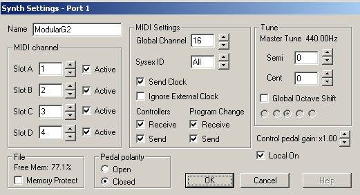

Zone
Joined: Mar 25, 2009
Posts: 9
Location: Holland
PostPosted: Fri Sep 18, 2009 12:26 pm    Post subject: Reply with quote  Mark this post and the followings unread
Blue Hell wrote: The patch should be OK ... in Synth Settings (in the NM editor) you have checkboxes for Controllers one for Receive and one for Send, you checked those?
Yes (please see attachment). If the settings of the G2 are correct, then it must be the Macebth M3X I guess

Posts: 24606
Audio files: 310
PostPosted: Fri Sep 18, 2009 12:33 pm    Post subject: Reply with quote  Mark this post and the followings unread
Looks good to me, one thing you can try ... you use midi channel 16 which also is the global channel, maybe try to turn global off, for a test at least (off = 16 + 1).
