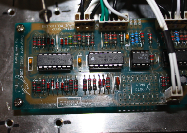

hey i have some strange behaviour on the pulse out of my wavemult
i was wondering if anyone can work out why it is happening
this is for the main folder btw
my fold out is working fine but when it hits the comperator the dc offset wont pan through negative to positive, it literally switches from -7v to +7v.
the inputs going into the comperator section look fine, the pwm looks nice, it rises and falls in voltage when i turn the knob and the signal input section also is fine, the dc offset rises and falls with the offset knob.
ive checked for shorts on the pins of the lm324 and swapped them around. i checked the resistance between the pins and doesnt seem to be anything to worry about.. so any help would be great

here is a pic of the board
ive installed all links that i could see

PostPosted: Fri Oct 30, 2009 4:54 pm    Post subject: Reply with quote  Mark this post and the followings unread
neat craftsmanship Smile
how have you wired the manual pwm pot, on the 6 pin plug it looks like there is no connection for 'R-' ?

PostPosted: Sun Nov 01, 2009 7:44 pm    Post subject: Reply with quote  Mark this post and the followings unread
Glad to see you are having a busy Monday morning
sorry if this seems too obvious, I know you are an experienced builder.
With a VCO signal into the folder input.
can't remember if you hav a 'scope?
if so have a look at the 'folded' out signal in DC mode (on the 'scope setting). note the average voltage range of the signal, say between 0 and 4V.
Then put your probe on pin 1 of iC4 and adjust the PWM pot so the voltage on pin1 is approx halfway between the upper and lower voltages of the 'folded' output.
Now probe the pulse out, does it swing back n forth? If not = problem!
no scope? maybe you can do it with a multimeter, the precise valuse are not important, just the approx voltage range of the folded out signal is enough, and somewhere around the mid-point of that range on pin1.
The DCoffset on the input of the circuit affects folder behaviour (as Ken describes) rather than the offset of the signal when it reaches the folded output

PostPosted: Mon Nov 02, 2009 12:09 am    Post subject: Reply with quote  Mark this post and the followings unread
ok i fed a tri wave from my evolver (boosted up to 10p-p with my mixer) into the comparator (pin 5 of ic4). it turns into a square wave. the thing now is that the manual pwm control just inverts the square instead of changing the width, and the manual offset knob changes the pulse width. this gets stranger by the second
this is with folds at 0 btw

PostPosted: Mon Nov 02, 2009 12:31 am    Post subject: Reply with quote  Mark this post and the followings unread
acually never mind hehe
now that i boosted my input upto 10p-p the module works perfectly
thanks andrew
