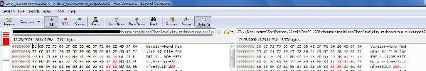

I've started by modifying the g2cat.py part of g2ools to:
1. extract the module and parameter names from a g2 .pch2 file
2. map midi CCs for each knob
3. save out a new pch2 file with the midimappings
This works - which is exciting! but unfortunately - some pch2 files - after I save back out - show up as corrupted.
The clavia editor either won't open them, or the editor crashes with a visual c++ runtime error.
I've narrowed it down to a simple test in python to:
1. load a pch2 file,
2. immediately save it back out without any modification
...but the resulting output pch2 file is still corrupt.
in a hex editor - the differences show up spottily early on in the file like this:
Posted Image, might have been reduced in size. Click Image to view fullscreen. first few differences
... then near the end of the file they really go out of synch like this:
This works for most pch2 files I've tried, but a few like this are stuborn. ;o(
I've attached the python test file, and both input and output pch2 files incase anyone has any ideas.

1. I'll have to retract my original theory about the patch format-version. I don't think this has anything to do with the issue you've brought up. It was just a hunch.
2. Have you tried running the original, unmodified g2cat.py on the input.pch2 that you posted in your first zip file? When I try to open the
output file, it also crashes the editor. So your change has nothing to do with this. Was input.pch2 created in the Demo editor???
3. When I diff an output patch with the input patch, using the original g2cat.py, there are many differences, but the output patch loads in the 1.4 editor. This is somewhat surprising but I am not so knowledgeable on the patch formats.

Ok- I've processed the Mother Misty modified patch (dirty_techno_MMM.pch2), with Zenpho's "read & write" python script- based on G2ools.
    Running MM's original file with Zenpho's R&W script, the header of the patch which is written IS modified, and there are many other differences as well.
    When I load the output patch in the 1.40 Editor, the editor crashes.
This is a diff of the patch header between Mother Misty's dirty_techno_MMM.pch2, and the patch created by Zenpho's python script.
The patch version is modified by G2ools. This is probably normal, although I don't know why it is necessary to modify the pat
