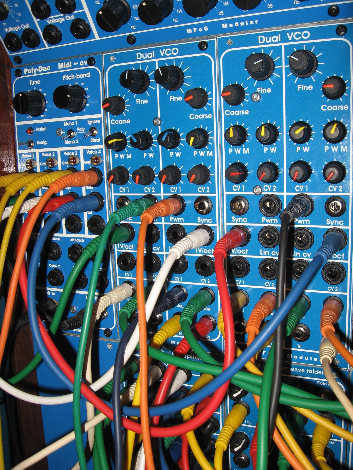

Next project... 2 MFOS VCO's into one panel , i've 4 of rays vco's so i'm doing 2 of these.
Adding PWM level in.
2 each log cv level in's.
Changing relevant resistors & caps to bring them up to Ray's latest vco version Rev D 2009.
Ready to wire shortly then re-calibrate them.
Here's the first module ready to connect up to the panel....

Hello.....
Now have 4 working & tuned mfos Vco's , really happy with their stability after 20min warm up .
2 more vco's to build yet , will be a 6 vco machine in the autumn Smile .
i played some notes into my RM1X midi sequencer that was hooked up to the Poly-dac 4 channel midi to cv converter then patched up 4 , single vco monosynths , 2 with wave folders and 2 with sub osc and recorded this (with help from a friend).

Dave,
What value pots did you use for CV attenuation?

Photon wrote:
Dave,
Hi Photon
I just used 100K pots as all of my attenuators on all the modules , i have cut down on extra patch cables by a few re-designs of some panels that commonly needed an audio mixer or cv mixer and built a mixer in (vcf's & vca's).
Dave.
