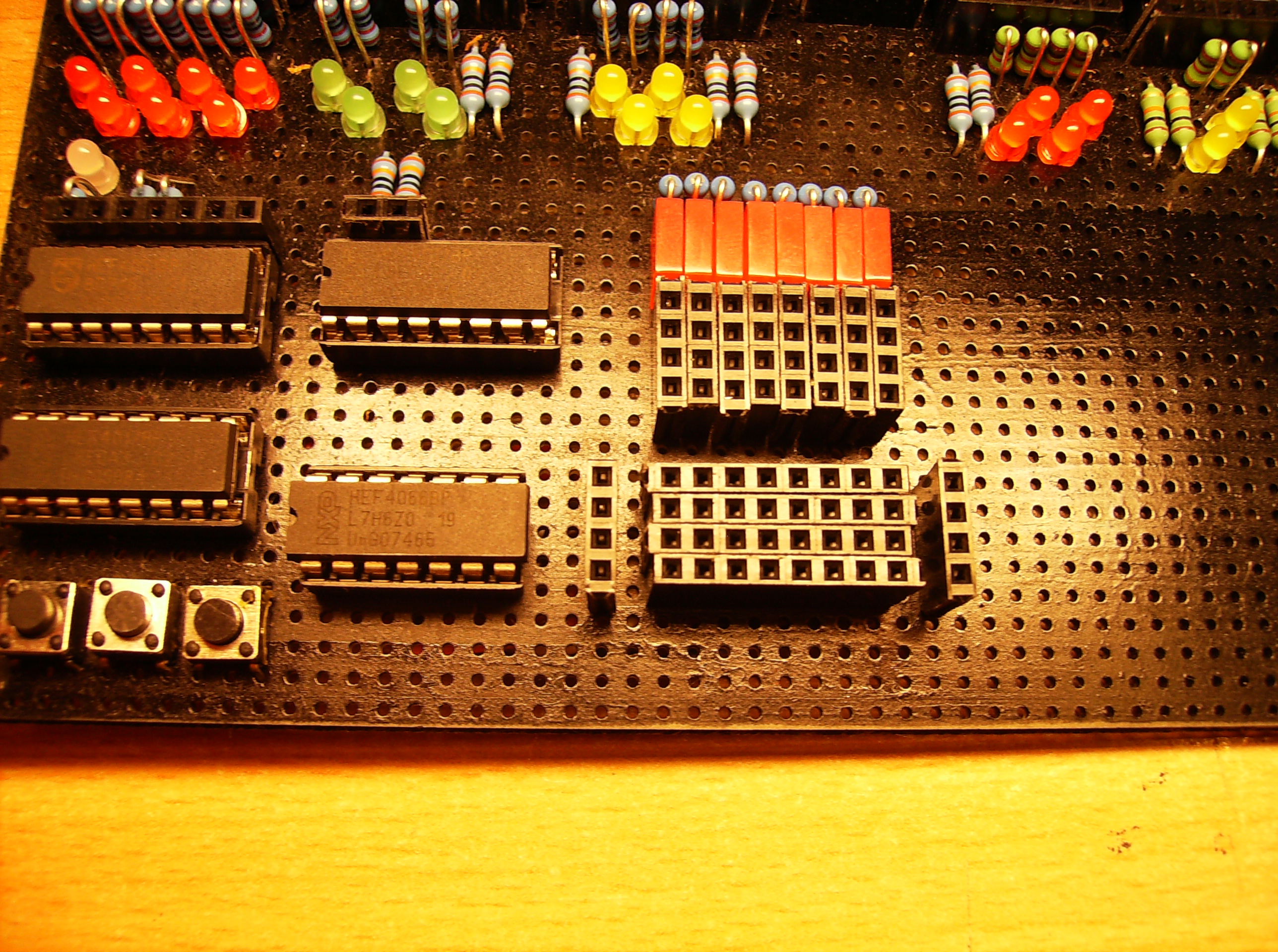

Time for another update!
The sun has been pretty relentless here and couldn't get anything done the last 2 weeks. Although I couldn't do any soldering I did design my first ever module to have the center space on my board. I posted a question over at the deathlehem forum about a sequencer where you can plug in any sound and have it sequenced. With great help from Rfeng and mr Rykhaard it started to take shape very quickly and my first lunetta design was done before I knew it.
Ive called it the Gating Patchable Sequencer(GPS) and it uses just 2 IC's, the 4017 and the 4066. The 4017 is set up just like a baby8 and uses an external clock and/or reset signal, the 8 steps get routed to some led's and a 8x4 header patchbay with diodes to prevent feedback. The 4066 takes it's 4 control signals from a 4x8 patchbay to switch(gate) the 4 inputs and outputs. It's all very basic stuff and really idiotproof to build but with a lot of rythmic potential with a total of 32 possibility's and you can use anything as a sound input(circuit bend stuff, gates, oscilators) and have it sequenced on the output. It is fully functional but Im having some grounding issues in the patchbays so the schematic will be altered to a final version.
pictures!
copperside, getting more and more complex with every module
 Filesize:  2.04 MB
 Viewed:  464 Time(s)
topside, up/down, left to right: Pulldownresistors, LED's, 4017 output bay 8x4, sound input 1x4, control input 4x8, sound output 1x4

tested and works, but still have groundingissues so wait for 2.0
