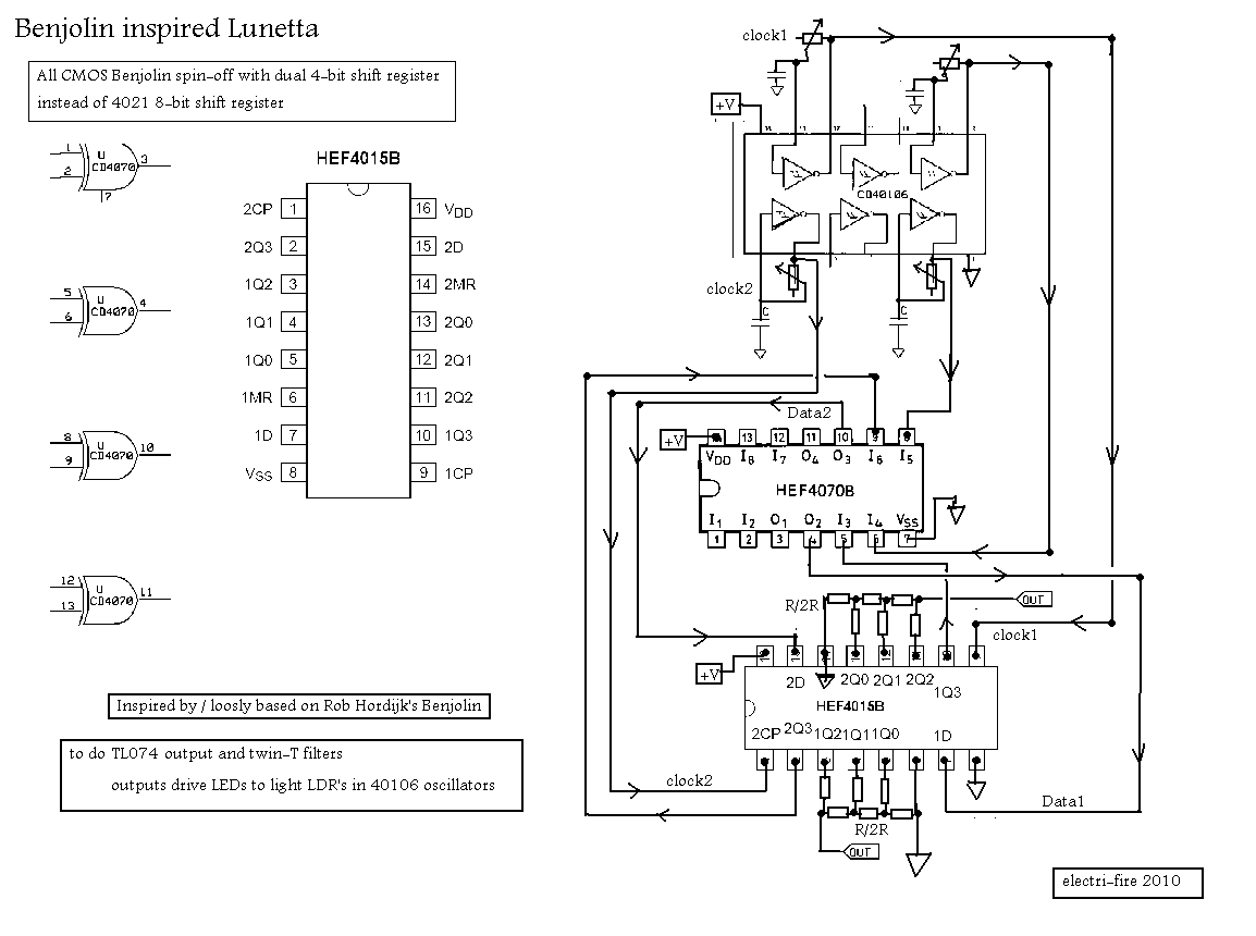

This design is based on Rob Hordijk's Benjolin, but it uses just CMOS.
http://electro-music.com/forum/forum-185.html
It is " almost finished" now, needs some cleaning up, and a layout, and decent outputs, and filters, and a way to have the outputs modulate two of the base oscillators frequency, and... hrmpfff... I'll present this as is.
Edit: error warning, to be updated.
How it should be is (at least thats what I have now and shows potential): The R/2R just drives a diy vactrol, the LDR part is parallel to the clock potmeters (or in series, still have to try that). The audio is not taken from the R/2R network, but from the clock oscillators.
Clock and Data lines could be swappedl.

Rob on the Benjolin's" Rungler"
Rob wrote:
What the $#%$ is a rungler?
The purpose of the rungler is to create short stepped patterns of variable length and speed. One could categorize the circuit somewhere halfway between a plain S&H and a shiftregister-based pseudorandom generator. It needs two frequency sources to work and basically creates a complex interference pattern that can be fed back into the frequency parameters of the driving oscillators to create an unlimited amount of havoc. /.../
The rungler is basically a CMOS shift register clocked by one oscillator and receiving its data input from the other oscillator. The output bits of the shiftregister are used as a binary code 'to do something with'. E.g. in the Benjolin the last 3 stages of the shift register form a 3 bit code that is fed into a 3 bit DA converter. This DA eight level output voltage is fed back to the oscillator frequency control inputs. /.../
In the Benjolin design the data input for the shiftregister is not just the pulse from the second oscillator but the XOR of this pulse and the last bit of the shift register (inspired on the pseudorandom generator).
Rob wrote:
Imho a rungler circuit works best in an analog electronics implementation. It is definitively more alive and surprising due to the slight instabilities in the analog circuitry. I did digital implementations, but they can't beat the 'organic behaviour' of the analog versions. But this is just personal taste...
Ok, you've been warned. Wink

Why not use a 4069 for the Twin Ts?

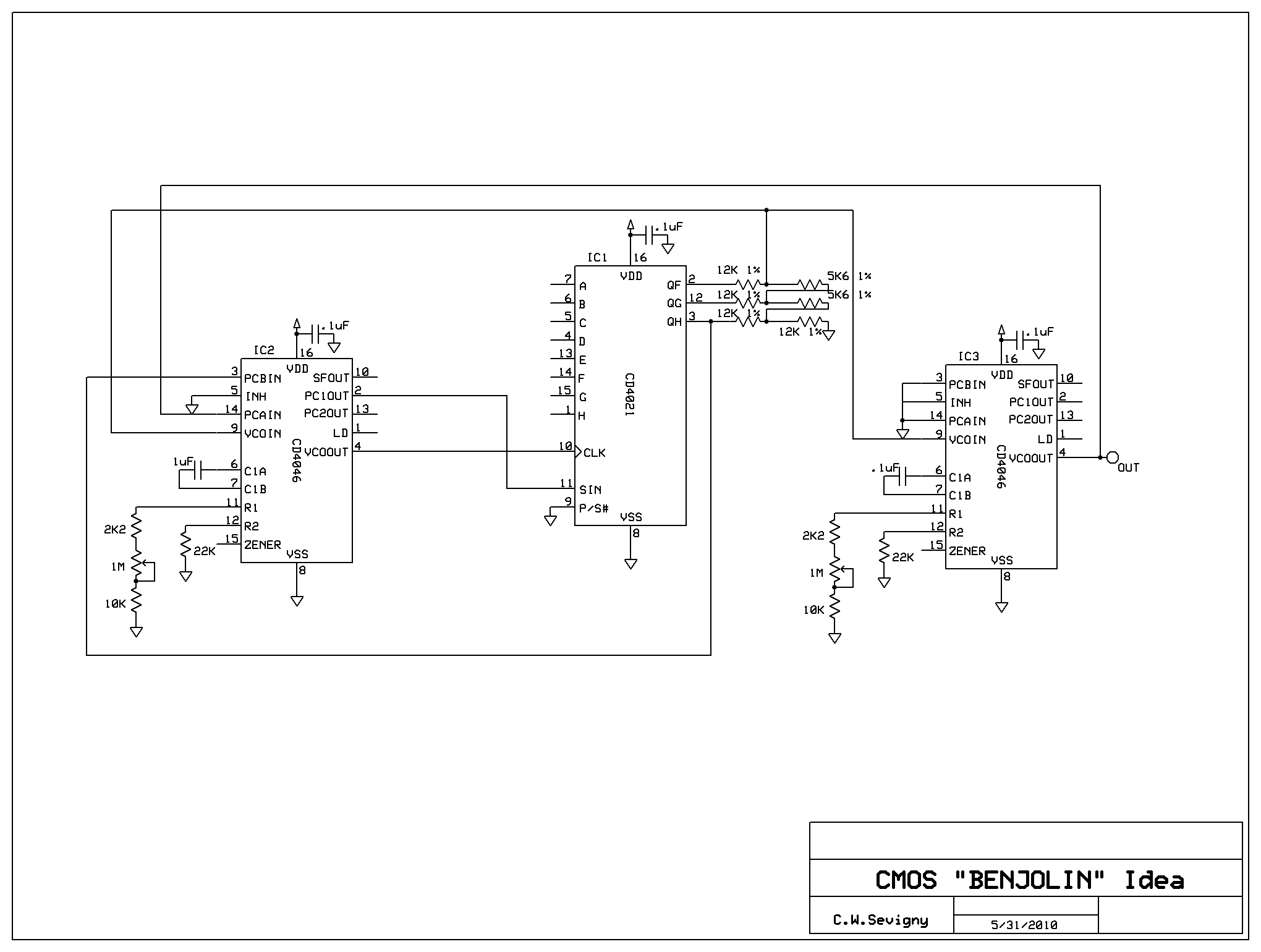

Here's something I started but forgot about (til' now). I did breadboard it and it works. Got some cool melodies out of it too. It needs a filter, and I wasn't to happy with the range, if I remember correctly. But for only an hour or so spent at the breadboard it yielded entertaining results. It's a start.

That looks pretty cool. I had a go at patching up something similar to Khrisblite's schematic and it works pretty well I got some nice musical little melodies going on.
Here's a brief clip.

Amazing sample slacker! Sounds nothing like what I got from the breadboard yesterday.
I used differant values for my 4046s, sort of a 1/2 & 1/2 between the TI datasheet & the wogglebug. Made a pretty nice autonomus bassline generator.
It settles into a loop quite quickly so I started messing around to try & make it a little less stable. One interesting thing is using the SF Out pin on the VCO 4046 to CV In on the Clock 4046.
Pin 1 of the 4046s is useful for loading the parallel inputs of the 4021 as well.

electri-fire wrote:
It is " almost finished" now, /.../ hrmpfff... I'll present this as is.
Prematurely posted as happens to me more often than not. Embarassed Almost finished didn't work, but now it "almost" does. Well, it does, but I still have some alternative options to try. Like do I use a vactrol in series or parallel to the pots. Do I modulate the Clocks or the Data?
Last weekend home before I leave for vacation. If I don't post the corrected schematic I'm sure you could figure it out now.

Inventor wrote:
Cool, this rungler is similar to a Boolean Sequencer in that it creates long patterns that are rhytmically pleasing.
Thanks Les, yes, results can be similar. The most important feature that makes a circuit a Rungler is recursion/ self regulation. One could go as far as saying the universe is based on recursion. I'm sure Rob would agree any bunch of signals turned into a control voltage to change clock speeds upstream in the dataflow could essentially be called a Rungler.
Your early Boolean Sequencers did not have the option of connecting downstream data to upstream inputs, so the pattern was (more) predetermined by the patch structure. That's the reason I've been pestering you about additional solderpads at strategic points between sections in the event you design a dedicated PCB for a Boolean Sequencer Wink .
Inventor wrote:
Will you bring copies of your schematic to the Lunetta Workshop at em10? We could build this one optionally.
It's an option, and yes, I could better print myself then, to not tax upload speed for the radio stream and all that.

I've been playing around with the 4021 / 4046 method (have loads of 4021 / 4014s here & a bunch of 4046s that won't work in the TH X-4046)
Some interesting stuff; the good thing about the 4046 is its super easy to tap off a nice saw wave as well which is good to mix in with the squares from time to time. I used a 4M7 for the static timing resistor which gives a really broad range with a 1M pot.
I ended up pulling the VCO 4046 off the breadboard so I had space to mess around with some filters, the 4021 + 4046 make a really cool clock source - XORing the Clock with the 3rd bit of the R/2R for the data input & CVing the 4046 with the R/2R, via a buffer & some lag (electri-fire gets that for free by using vactrols) creates a clock that, at sub-audio, will pulse slowly, then speed up & down in fairly regular patterns.
As the 4046 approches audio rate the clock out jumps in & out of the audio spectrum as the shift register fills up & empties itself. At audio the SR stays more or less full & you get a nice womp-womp LFO.
the attached is a quick recording of whats on the breadboard at the moment. The 4046 out drives a little transistor envelope generator (old Roland Drum Machine style) which is fed into a state variable filter. The SVF is a little wonky at the moment as it has a vactrol over 1/2 of its frequency control & a pot on the other half (this is kinda cool for drum sounds actually)
The vactrol is being driven by the 4046 CV out (pin 10) which kind of follows the rungler CV but is delayed somewhat. I adjust the range / rate of the 4046 & the (1/2) filter freq.
I think I'm going to make a little module with the 4046 + 4021, with an external input into the XOR (& switch) so with an external VCO it will be patchable as a "proper" Rungler CV / Bit generator Very Happy
Tom, that sounds way dope! please post a schematic if you end up with such a beast!
