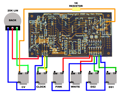

So I was still having problems after replacing the 74HCT4046. I think the problem now is that I am using an NTE4006 instead of a CD4006. After sifting through the CGS yahoo group and checking my work a million times over I'm pretty sure this is why my DN still isn't working. Now it's time to find myself a CD4006
Thanks Andrew (as always) for your help. I should have caught these two build errors earlier but now I'll know better..
P.S. For the others out there, I'm going to upload this wiring diagram I found on the CGS yahoo list. It was originally made by user "kvltleader." I don't imagine anybody would take issue if I shared it here. The wiring looks correct but the LEDs are not shown..
Also make sure you connect the jumper which is on the pcb under the 4030..
CGS Digital Noise Wiring Diagram
