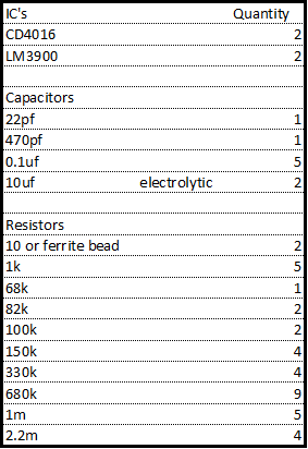

PostPosted: Sat Jan 08, 2011 12:49 am    Post subject: Reply with quote  Mark this post and the followings unread
I didnt actually look through the whole thread(so sorry if it's already been done), but i always find a BOM useful to see if i have everything required for the build, so i made one up for this board.
in non image format too Very Happy because downloading bmps is so passé
IC's Quantity
CD4016 --1
CD4015 --1
LM3900 --2
Capacitors
22pf --1
470pf --1
0.1uf --5
10uf electrolytic --2
Resistors
10 or ferrite bead --2
1k --5
68k --1
82k --2
100k --2
150k --4
330k --4
680k --9
1m --5
2.2m --4
edit : i put 2xcd4016. sorry. now fixed, will do the bmp later
 Filename:  buchla 208 BOM.bmp
 Filesize:  228.59 KB
 Downloaded:  2473 Time(s)
