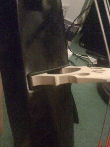

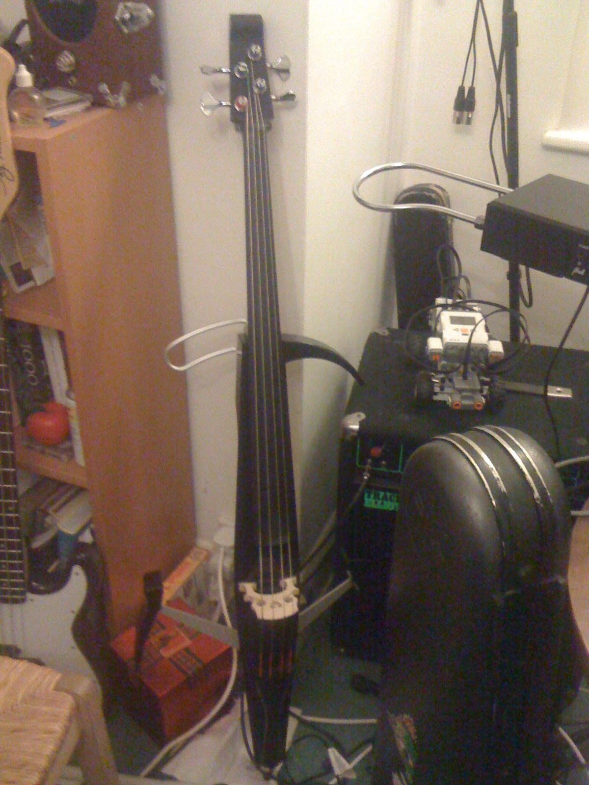

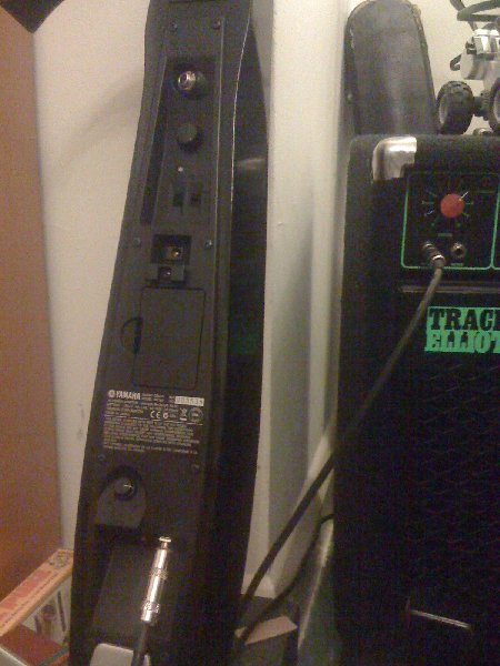

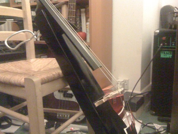

ok here's a couple.
The whole instrument
 Filesize:  236.43 KB
 Viewed:  314 Time(s)
Bridge close up. Note that pickups are built into the recess under the bridge.
 Filesize:  285.38 KB
 Viewed:  256 Time(s)
Fingerboard, bridge, chest rest, top of tailpiece. Note the strings are fairly normal metal cello strings. I'll find out what brand he's using.
 Filesize:  287.37 KB
 Viewed:  264 Time(s)
Backside, showing controls, battery case, etc.
 Filesize:  284.22 KB
 Viewed:  253 Time(s)

PostPosted: Sun Jan 10, 2010 3:16 am    Post subject: Reply with quote  Mark this post and the followings unread
hey EdisonRex
real sorry for the trouble
but do you recon you could 'unscrew' the bits at the back so i can see how its done inside?
if you cant thats cool
but it would be greatly appreciated if youcould find the time
thanks
