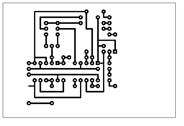

Pantheon
Joined: Feb 17, 2011
Posts: 36
Location: Edinburgh
PostPosted: Mon Mar 21, 2011 12:56 pm    Post subject: Reply with quote  Mark this post and the followings unread
brother303 wrote:
Hi Pantheon,
I found an old thread here on the board about syncing MS20-vcos.
http://www.electro-music.com/forum/post-104001.html
Greg
Thanks for that link 303,
It was a very interesting read. Funnily enough, I have previously tried that method of sync and found that it apears to have two flaws IIRC.
1. It cant reset a waveform that is near the start of its cycle.
This would give it a raspy, noisy sound near some harmonics of locking.
2. It distorts the waveforms amplitude, that cause distortion in the
waveshapers.
I have attached what i belive is a more stable method giving it a very clean and precice sound.
But thanks, its good to see what other people have tried.
BTW, im now working on the new PCB and i'll get it etched and tested within the week.
 Filename:  sync_method_3.bmp
 Filesize:  1.34 MB
 Downloaded:  668 Time(s)
the8bitpimp.wordpress.com

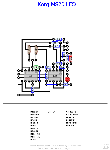

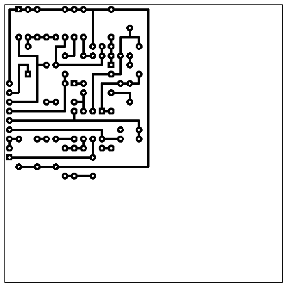

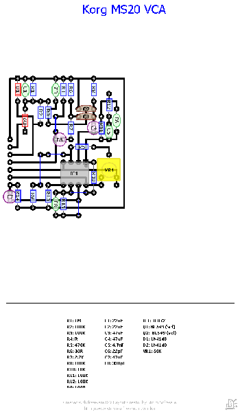

ericcoleridge
Joined: Jan 16, 2007
Posts: 889
PostPosted: Mon Mar 21, 2011 1:59 pm    Post subject: Reply with quote  Mark this post and the followings unread
This is probably not the best place to post these, but, being that they are related, I'll go ahead for now.
These are layouts for the MS20 VCA and LFO, both untested as of 3/21/11. I was pretty careful laying out the VCA, less so with the LFO; But both are very simple and if anythings wrong, shouldn't take much to get them working. The VCA calls for matched BC549s, but I don't know how critical this is.
I used a freeware program called DIY Layout Creator, which is a little buggy. The layouts will need to be re-sized before printing to PnP, and I think they may also need to be reversed.
 Filesize:  20.27 KB
 Viewed:  1052 Time(s)
 Filesize:  7.03 KB
 Viewed:  474 Time(s)
 Filesize:  14.53 KB
 Viewed:  2326 Time(s)
 Filesize:  5.9 KB
 Viewed:  483 Time(s)
brother303
Joined: Nov 02, 2010
Posts: 139
Location: ruhr-area/germany
PostPosted: Tue Mar 22, 2011 6:50 am    Post subject: Reply with quote  Mark this post and the followings unread
Thanks lot for posting this here. Hail the Master
The vca looks easy enough,I´ll try to put it on a piece of stripboard.
Best regards
Greg

@Pantheon: How many ins and outs does your vco provide? Exactly like the "real thing"?
Outs : Tri, saw, square
Ins : V/oct., pwm, freq.1, freq.2
And another question : Is there a coarse and a fine tune pot or an octave switch and a tune pot?
Greg
Pantheon
Posts: 36
Location: Edinburgh
PostPosted: Tue Mar 22, 2011 12:16 pm    Post subject: Reply with quote  Mark this post and the followings unread
It has 5 inputs:
2x - 1/voct inputs
1x - sync input
1x - linear cv
1x - pwm input
1 of the 1/voct should come out to the faceplate, or be routed internaly to a MidiCV converter, etc.
The other one is for the Fine/Course tuning pot. I havent decided exactly how im going to use this yet. Currently im hovering over the idea of octave/finetune. I'll include a diagram of how I wire it, but people should be able to use this to suit themselves I think.
The sync input can connect to the square/pulse wave of any oscillator (at +5v/-5v), and will sync on the rising edge of that wave.
The linear cv is of no use to me but it seems to be a standard thing to include in VCO's so I put one in. Also Sebo might be able to use it to get this oscillator to track from a v/Hertz cv.
The PWM input takes a CV of [0v - 5v] and sets a [50% - 0%] duty cycle, respectively. The PWM cv could also range to -5v to get >50% duty cycle.
I am going to wire a pot as an attenuator feeding into this, and depending on if a jack is plugged into the CV input or not, it will either set PWM directly or attenuate a signal coming in threw the jack.
I has 5 outputs:
1x - Saw wave
1x - Triangle wave
3x - Pulse wave
There are three pulse outputs, so that one can be internaly routed to a second oscillator to allow syncing. One can also be internally routed to a CMOS ring modulator.
Does that seem reasonable?
These features suit me, but feel free to make suggestions, I can still change the board.
Also I have finished routing the new board, so after a double check, i'll etch and test it Smile

I have attached the version of the ms20 vca that I simulated. There are a couple of notes on there, for setting line level and synth level outputs. I also added a gain trim pot, as the verson you linked to seemed to output a slightly lower signal level. Also I removed the bias trim, as I couldnt see much reason for it in the circuit. Does anyone know why it was included?
As for the question of puting the ring mod on the vco board, as it stands the vco is realy nicely layed out and everything fits great. If I were to put it on the board, it would either become a very long board, or become a routing nightmare. I quite like the fact that its a very small vco board right now (4.30"x1.50"). The ring mod board is (2"x1") on its own. The ring mod, could have 3 sockets mounted on it, and just attach directly to the face plate, no problem. You could then also use it with other modules.
Im about to finaly sit down and check the vco to make sure its routed correctly. I got a little sidetracked with some tube circuits Razz

Pantheon wrote:
I have attached the version of the ms20 vca that I simulated...
Thanks mate. I´m going to check it on a stripboard over the weekend. (....thank god it`s friday! Wink )
No problem here,just an idea. Pcb size is good as it is and...

R12 on your vca-schematics is really 1000K?!? Shocked
Not 10K???

brother303 wrote:
Hi Pantheon,
Not 10K???
Greg
Ah yes its a 1M resistor, but it realy isnt that important, 47k or something might be more resonable Smile It was just to tie that end of the cap to ground.
I hope it works for you, let us know your results!
I finished checking my board layout, and after a couple of tweaks everything looks good and checks out ok Smile So when the printers are open on monday, i'll get this printed and etched. Once i'm happy that its working correctly, i'll post up the final layout, schematic, parts placement, etc.
